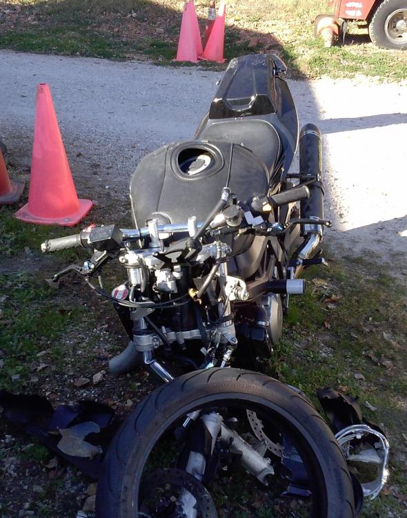

Anyway, the bike was of course badly damaged with snapped front forks and crushed front end/wheel, battered tank, and other various wounds.  The pizza insurance company didn't want any part of my accident and sent me a letter saying they would not pay for storage at the salvage yard.  So I hobbled there and had it put on my trailer and took it out to my dad's farm where it sat until yesterday.

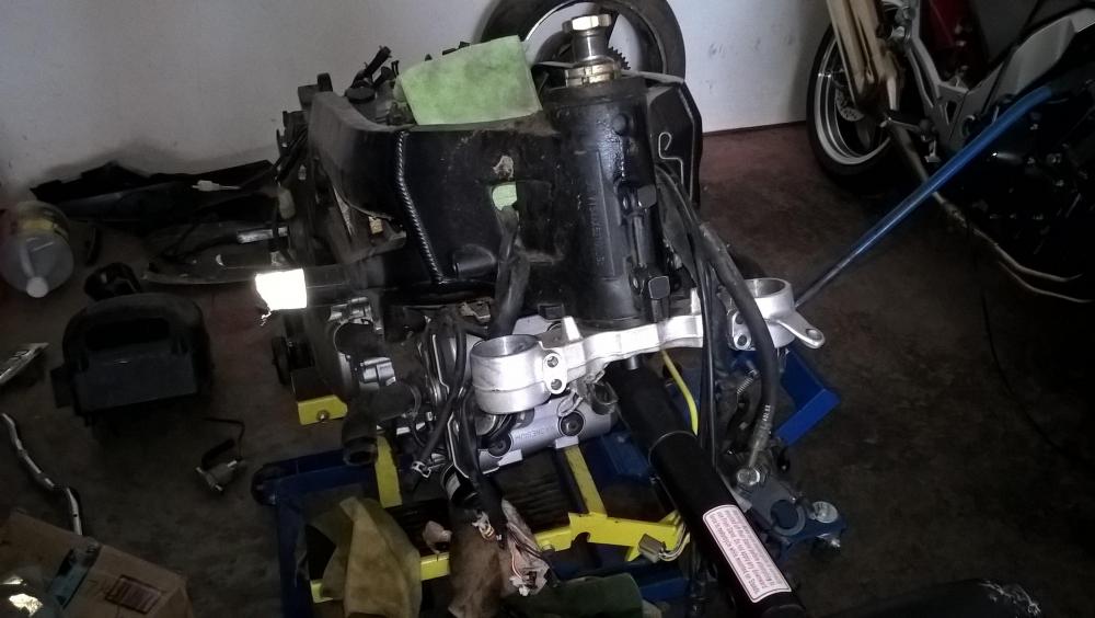

It's in my garage now torn apart and I'm slowly piecing it back together.  After I check the valves, stator magnets (SV1000S are notorious for throwing these around), and the transmission, I'll give a good cleaning (imaging what 3 years of sitting outside does to a bike) and see if I can get it running.

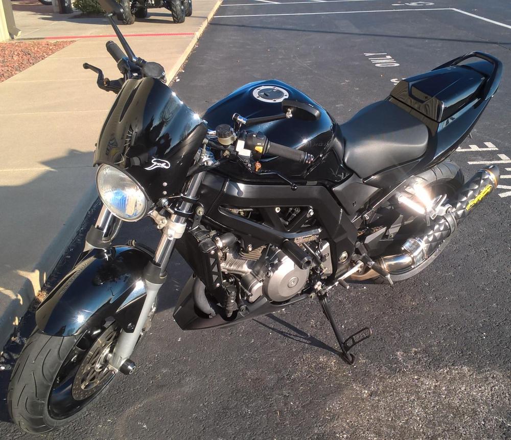

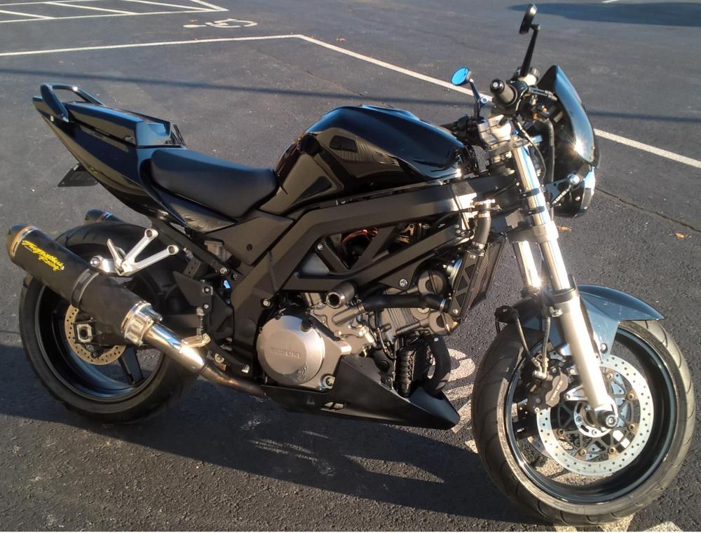

The first pic is the before, then after, and now.
Welcome back to the best feeling in the world one can have (with one's clothes on  :beer: )

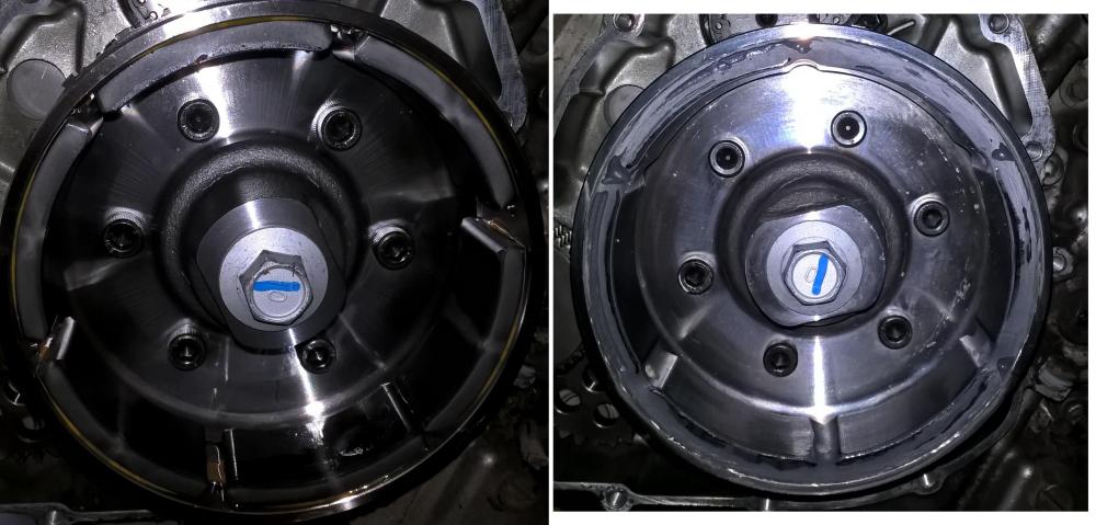

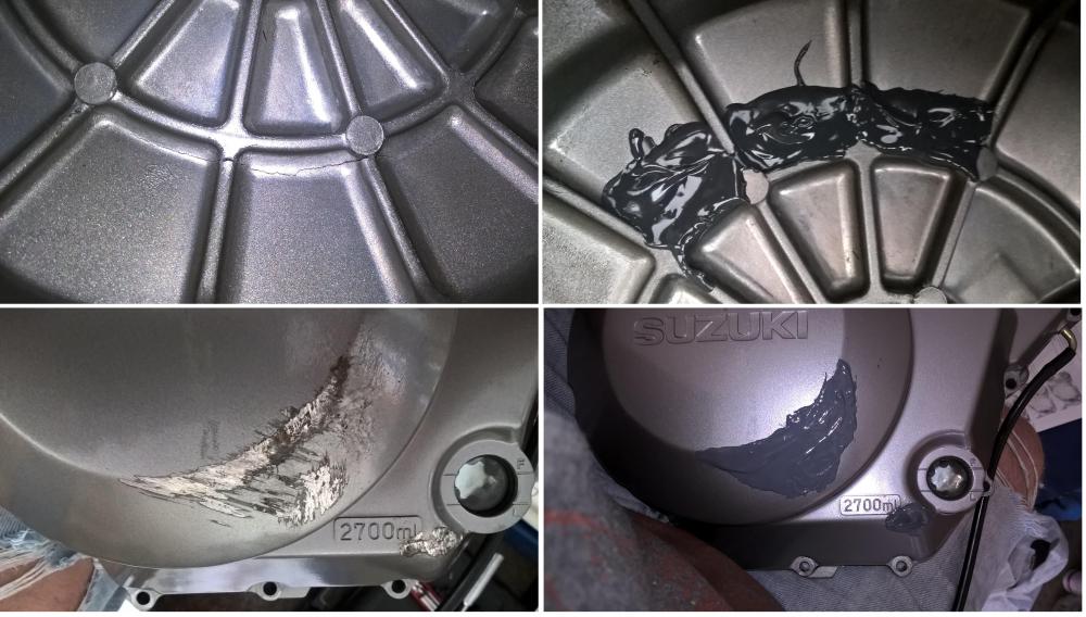

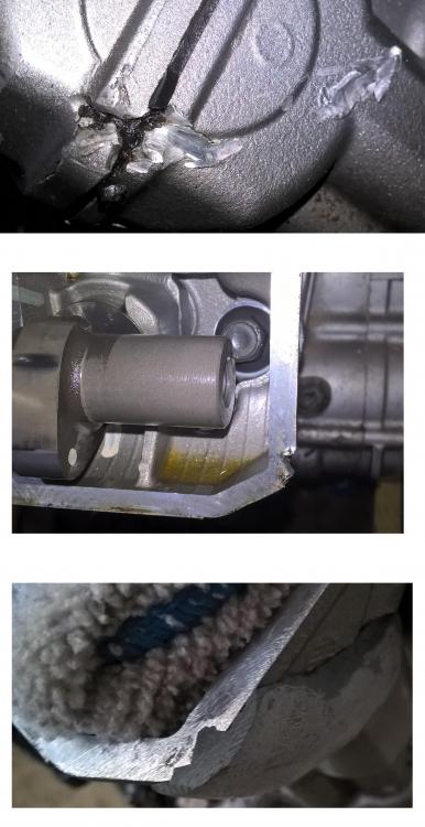

Below are a few pics of what was involved to get her running again:
with forks hit as hard as that i'd suspect cracks or other damage around the steering head bearing seats or a bent frame. 😭
18 hours ago, squirrelman
That is a very valid observation and a concern I share.  I figured there had to be something wrong somewhere and to allay my fears,  I've gone over the bike very carefully.  The speed at which I hit the car was about 35 mph.  Fortunately, a lot of energy from the crash was absorbed by the front wheel (it completely shattered), the conventional front forks which bent at the weaker stanchions, the steering damper which had its mounting point bent, the front head which had a big gash in it and the mating surface for the valve cover, and the radiator and oil cooler.  Everything I've replaced easily attaches at the frame mounting points too including a used rear subframe.  Although not a guarantee that there are no microfractures somewhere, I haven't seen anything yet during my detailed inspections. 🙂

i bought a wrecked GSXR at an auction years ago and found that the frame around the steering head bearings had gone decidedly oval-shaped.
14 minutes ago, squirrelman
Good info to know.  Thank you.

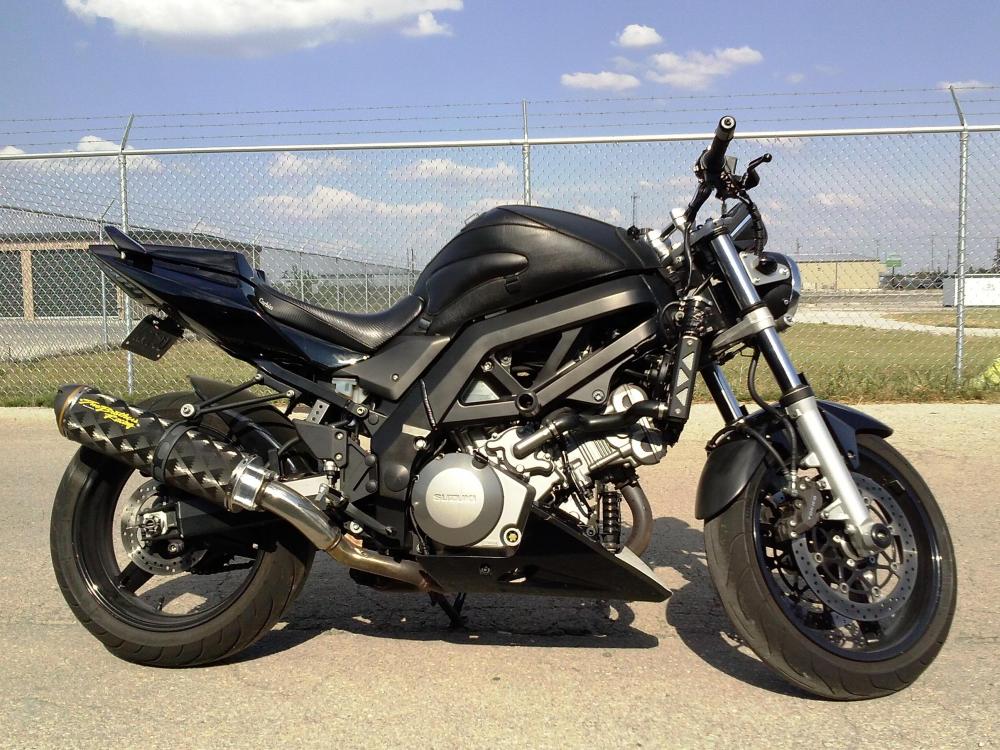

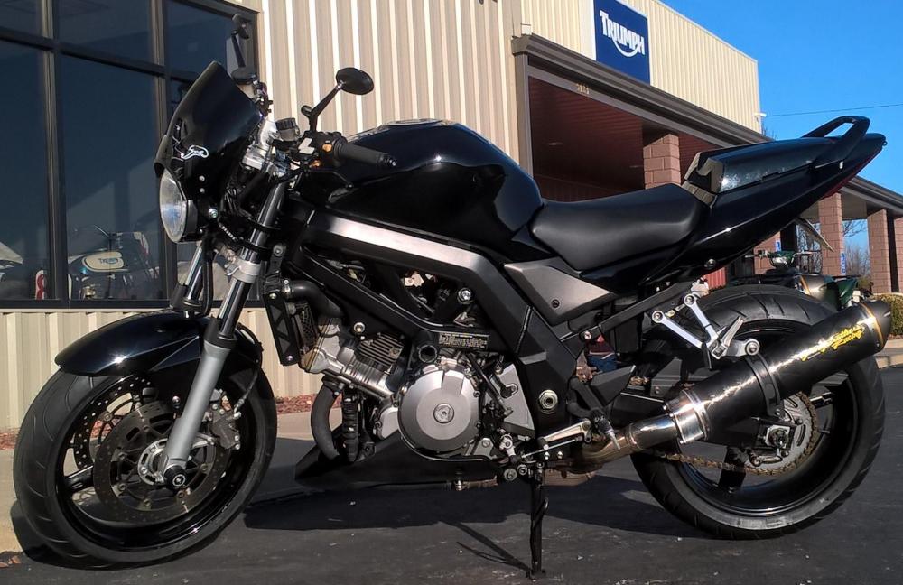

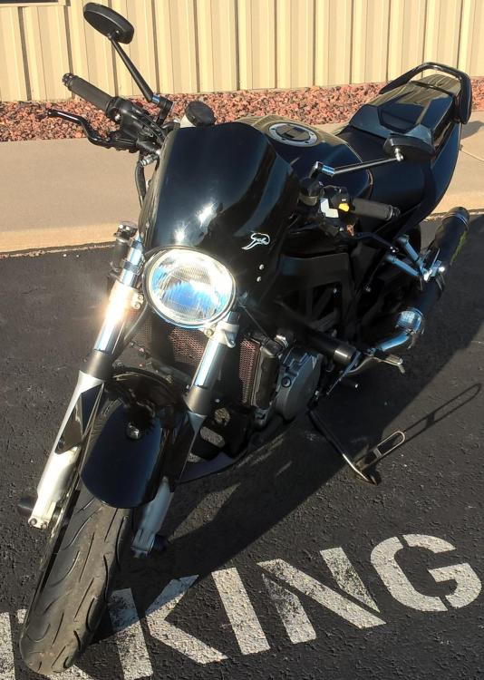

She's done!  Just got the state inspection done.
Stuff you can see include: Speed Moto fork mounted headlight clamps (eBay store), Emgo side mount cafe headlight, Buell Cyclone headlight fairing, Rizoma Dynamic mirrors, Pazzo levers, and Custom Dynamics Magic Spot Lights for my signals (also used these awesome lights for my brake lights and license plate light).
