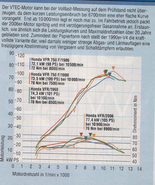

Although they look almost identical almost every single part is modified on the 88/89 from the 86...Gearbox is out of the RC30 (only the ratios differ). 1990+ has different heads but the bottom end is pretty much the same as the 88/89 (only major bottom end difference is the output shaft is longer).  Main difference in ownership is the 86-89 need valve clearances checking more often. Just as reliable until you get to the VTEC with chain cams.
No real difference in power between the late 88/89 and 90-97 tbh. Condition is everything. The 750's make more torque than the 800's low down and the same as the 800's peak. Only difference is the VTEC revs higher so makes a few PS more.
Image result for vfr750 vs vfr800 torque curve
Realy cool this info.
Funny how little the difference is on the models (PS and Nm)
