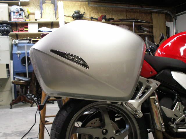

Well, I'm seriously looking at the silver ones on davidsilverspares.com (About $400 USD with shipping. I'll paint 'em black), but I also want a top box. What rack mod or add-on will be required to include the top box, and who knows of a good cheap one (any make or color)?

I just painted my saddlebags flat black. I'm sure you'll see them later this week when we head to Reno.

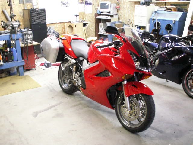

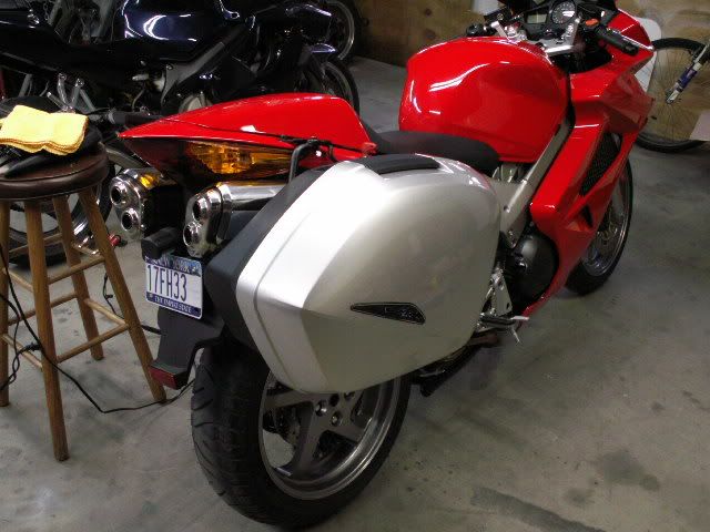

Your saddlebags look great, MFP-2241. I haven't had mine on since Reno, but I did leave the rear rack and top box in place. Having a trunk is extremely convenient.
I decided to add two grab bar/reinforcement rails to quell some of the bouncing I had with the top box loaded up. My wife likes to have the bars to hold onto, too. While I was at it I welded the top box base plate to the rack and repainted the whole thing matte black.
(IMG:http://www.vfrdiscussion.com/forum/uploads/1153411809/gallery_5128_669_625804.jpg)
(IMG:http://www.vfrdiscussion.com/forum/uploads/1153411809/gallery_5128_669_363222.jpg)
I'm very happy now. The whole luggage system works like Mama Honda made it for me. (IMG:style_emoticons/oldemoticons/fing02.gif)

Re #1: I simply cut out the hole with a hot soldering gun. It makes a pretty smooth hole. The lumps that look like sealant are just welds on the studs that go up through the frame rail. I will take the racks off for solo riding.
Re #2: I have both an Oxy-Acetylene and a little 110 Campbell-Hausfield wire-feed arc-welder. However, I use the O-A for heating and cutting, as I find the wire-feed requires a less artistic touch for welding. Just point and shoot. I can do a lot with it, but it's definitely crude compared to a nice proper 220V Lincoln or Miller (or such) MIG.
As far as developing your welding craft, practice with scrap!! I'm hardly the guy to ask about pretty welds, though. It's my grinder and files that make all the ugliness go away! (IMG:style_emoticons/oldemoticons/tongue.gif)
