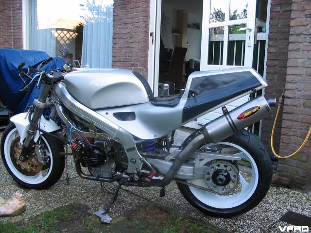

A friend copied my Two brothers racing Exhaust system in Titanium !
Complete exhaust incl. muffler is only 2.6KG... (originale OEM system -1990-1993 VFR750F- = almost 20KG)
Also the mechanical waterpump has been removed. Will run an electrical.
The frame for the topfairing has been modified (less weight).
Check pics:
[exhausts; blue one is the Titanium]
[image: gallery_668_420_43007.jpg]
[image: gallery_668_420_34569.jpg]
[image: gallery_668_420_61256.jpg]
[image: gallery_668_420_17445.jpg]
[image: gallery_668_420_6929.jpg]

How much weight have you taken off the original weight?
Hobie1dog, Jan 15 2007, 01:31 AMHow much weight have you taken off the original weight?
I have taken off 150 Lbs (68KG), the bike is now 379Lbs (172KG). (the weight of a 2006 Fireblade is 459 Lbs (208KG) -Wet- )
The weight of a completely standard VFR750F (90-93) with centre stand is 529 Lbs / 240 KG (-Wet-; incl. fuel, battery, oil, water )
Weight decrease by:
-magnesium rims
-exhaust system
-front forks (Fireblade Upside down)
-fuel tank (alloy)
-alloy subframe
-hawker battery
-centre stand removed
-rearsets
-tensiongears in engine removed
-race alternator
-VFR400 hub
-carbon airbox
-race seat
-mechanical clutch
etc.
VFR750F Standard: 90HP (at the rear wheel) 240KG. Every HP has to carry 5.86 Lbs
My VFR837F: 125HP and 172KG. Every HP has to carry 3.04 Lbs

Exhaust is ready, frame modified.
Only the headlight is still standard and will stay standard... (as long as I cannot get a lighter one with the same looks)
[image: gallery_668_420_291518.jpg]
[image: gallery_668_420_382891.jpg]

Is the gas tank an aluminum tank? How much weight did it save you?
Who makes the one piece rear solo body section?
How much weight did the replacement rear sub frame save? It is out of aluminum too?

@hobie1dog:
It is a aluminum -standard- RC30 gas tank, weight saving of the tank; don't know
The rearseat unit came is also RC30. But at www.pferrer.de you can find units you can use without modifying your RC36 subframe
Yes, the rear sub frame is aluminum too. it is really light !

do you have any pictures of the subframe? Did you make it out of square aluminum tubing?
Thanks again for showing us your project. It is fantastic...inspirational. (IMG:style_emoticons/oldemoticons/fing02.gif)
Subframe is a modified RC30 unit. (aluminum)
[image: gallery_668_420_751456.jpg]
[image: gallery_668_420_157587.jpg]

The picture of the subframe you have...is it the original steel one? Did you replace it with an aluminum unit?
Hobie1dog, Feb 10 2007, 05:19 AMNext modification should be to change your exhaust over to an underseat system....all in titanium again. (IMG:style_emoticons/oldemoticons/fing02.gif)
The original is indeed a steel one. The -original- RC30 aluminum is really light.

What did you need to modify to fit the VFR400 hub?
What parts did you use to convert the hydro clutch to cable and do you have part numbers?
Where can I get the carbon fron sprocket half cover?
Sweet work (IMG:style_emoticons/oldemoticons/fing02.gif)
shrek, Feb 25 2007, 03:33 AMWhat did you need to modify to fit the VFR400 hub?
Thanks !
I bought the mechanic cable clutch: it is made by Thorsten Durbahn incl. carbon front sprocket cover: www.durbahn.de
VFR400 Hub; the width is different, you only have to fill the space between the parts.
