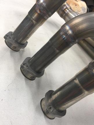

 Went up today to see Gabe and worked out some details.  He ordered up some tubes  and got the low down on the 2Bro I was able to get my hands on. So full steam ahead. He saw some parts that he could be improved upon,  thinking I'd see better numbers,  IDK,  until I do a Dyno run,  we won't know for sure,  but we're off and running.  Hopefully in a couple weeks we will have it where things can start being put together. That said  I'm Now on the hunt for a donor VFR to work from.  As I'll be installing the 2 bro on my vfr and doing a dyno run to see how it all compares shortly  But while my VFR is in that state, it would be way easier and faster if I had another VFR to work with for fitment reasoning's.   I also find the the center stand works,  so now we know that's not an issues to have in place.    In addition I find the 2bro weighs in at a hefty 7.1 lbs  vs. 9.8lbs  for the 98-99,  A bit of savings for sure.
 [image: DSC02184_zpswa8fmwuq.jpg]
Getting it figured out.
[image: DSC02183_zpsjvj8fqca.jpg]
Just a wee bit of difference huh. That's a 98-99 header on the bottom of the photo .
[image: DSC02181_zpsm8gr7w1m.jpg]
This is just beyond words! Something is actually happening [emoji3][emoji23]?
Holy shit this is actually happening. I'm a bit worried when it comes to cost for me though, I imagine $800 USD plus shipping is gonna put it out of reach for me for now.

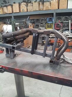

[image: DSC02203_zpsqxktwnay.jpg]
Finally had a moment  to check the 2Bro fitment. First the center stand looks doable,  but I tell ya, it took a bit of &^%! and stretch and push-pull to get into place.  This could be one item to address,  first off thoughts have it where the front primary's are like the rear,  separate.  Other wise,  it's still looking to be a close fit for the center stand.  The rest is looking ok.  More later.  I wore out a Dremel brush,  now need a new one to clean the rear exhaust ports before I attack the rears

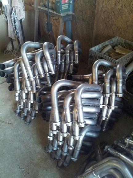

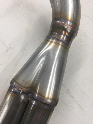

Hey All!
Not sure what I can contribute here on this discussion other than building a full on custom exhaust for a VFR was the things nightmares are made of haha! That is my bike above and I did build the exhaust from scratch. This was my first exhaust build and I learned alot...particularly I learned not the build a V4 exhaust ever again. Mostly joking here, it was a blast to build. If you guys read the article on Burns site you read the issues I had with the first bends i bought...that set back back quite a bit. I did back purge all welds and used ZERO filler...just super tight fit ups and my TIG. I have a buddy of mine who welds stainless tubing for milk processing and they dont use filler either. If you have a good fit with no gaps its actually pretty easy.
I used a racefit can from John..at racefit. Of course I had to chop it down even more. It does exit from the right still My VFR sounds like a caged animal! Its not everyones tastes, especially how loud it is but I love it.
I went into this aiming to NOT loose any HP or Torque. I figured if I could at least get it as good as stock I would be in business. I was delighted to find I gained 10hp and 2.5ft/lbs of Torque!
This bike has been a work in progress over the last 4 years but I think its done now...I think.
Cheers!

Nice,  thanks for sharing this.    LOL ain't VFRs fun to work with.  Looks good,  especially the numbers,  you did very good. IMO.
RVFR, 4/11/2017 at 5:19 PM
Haha...yeah they are a dream :pinocchio: Thank you!

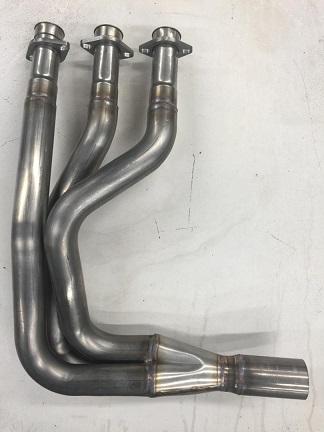

After today's de link,    the header is a snap.

Grr,  small bump in the road,  After a lot of fiddling it comes to my attention the #2 primary is stonkered, It won't seat. I took the 2bro off and  tired a many different ways,  Nope,  ain't going in,  and there's no way the exhaust studs can handle that much stress.  So it's looking to have to be cut and reattached in that is the trick since Gabe isn't portable,  the Viffer has to go to him.  Luckily the shock showed up last night, at least I can now get it on the ground rolling. Now to get the trailer back in shape.
[image: DSC02241.JPG]
Have u changed something since 10 april, pics u posted had them fitting and buttoned up.....
Well mostly buttoned
Could u scribe the end to the angle and cut/grind?
Or is it a case of not enough length and the bend is out
Ah no,  nothing changed.   Yea those photos was a quick pop it in there just to see and share,  all seemed good until the final push for #2 , I went back to make sure it wasn't me going about it the difficult way, re did it all,  made sure all joints where going the way they where suppose too.  Nope.  that #2 primary is twerked some how.  so now it's down to a couple solutions,  cut and re weld are like a couple shops suggested or heat it up an twist it back in place.  Being it's on the VFR kinda going Hmm with the heat it up aprouch but makes sense to a degree as long as I don't cook the oil in the pan while at it nor burn through the header, little steps here,  even Gabe agreed the heat it up is probably  the way to go, cut and weld is second. That being said,  I had it in mind to cut both #2 and #4 making slip joints like the rear two, but can't find anyone with a 11/2"  tubing stretcher. Gabe says he can get one but may take a couple weeks,  I don't have a couple weeks, I have it planned to have this all button down and dyno'd,  know whats going on before the ride to S Ca.at the end of May

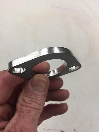

Well well that was fun  I see some more things to make better,  like header flanges.  SMH  With a few fine words going to 2Bro for making such a cheap product at a glorious price.    I was able to,  Fingers crossed they set right, get the header buttoned up. But it took some serious heat.

Well shes up and running. Now waiting on Gabe to figure out the Staintune connection,  in the mean time.    Oh what a sound, pure music.

Have u added a bit at the outlet there?
LOL what? ;)   That's the 2bro mid pipe that slips on to the collector,  kinda cool looking, almost.   it's kinda growing on me the way it is,  SMH,      Actually I will have the Staintune hooked up using part of that mid pipe.   as much as I like the rear wheel being all out there,  it's also missing something IMO

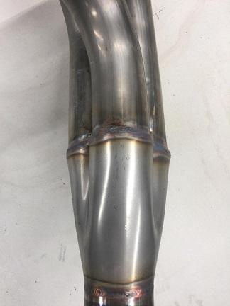

No close up, but looks like a cut and re-weld was necessary.  IIRC, the TBR collector output is positioned slightly different from OEM so simply expanding the midpipe was a no-go.  Job looks clean, you going to polish it back up?
Yep that it was,   cut the Staintune mid pipe, cut the slip on mid pipe from the 2Bro,  added new 2" tubing, bingo.   Ya know, I had planned to polish this up, But Gabe did such a really  fine job, one has to look close to find the welds, and the transition is behind the passenger foot peg hanger so you can't really see the difference at first,  IDK I kinda like it the way it is.. we'll see.
Beautiful welds
Sent from my SM-G920V using Tapatalk
Your Gabe is a welding wizard-some of the nicest work I've ever seen. I'd leave it the way it is-nice contrast.

All right Guys and gals,  yea it's been awhile huh,  sorry about that. Yes I've been sorta distracted,  over the Memorial weekend I went on a ride in S.Ca,   what a hoot that was. It also gave me insight to how the Viffer was running.
[image: DSC02259_zpsc1wbbrff.jpg]
[image: DSC02266_zpsc1vpijqo.jpg]
Lets see here if I recall where I left off at. Ah yes,  so after the last dyno pull I find out the Piper cross was a tad better than the KN I had used a year earlier.  it's starting to look like the weather played a bigger part in the first tune. cold and dry air, than I would have thought. IDK the jury is still out.  What I know so far is this,  The 2 bro header is making around 4-5 hp more and a couple more foot lbs. torque,  more on the top,  where the stock header kinda gets choked off, while the 2bros makes it go all the way to 12,5K  it's still not what was recorded last year, but never the less a gain.  Now what's really fun. It's the throttle response and how it puts what gains are to use once out on the road. Oh yes,  it definitely improves acceleration big time, granted the tune in it's self help the throttle response as well,  but now it pulls seamless to redline line in 5th no problem, I mean bingo you're there,  6th, it probably would have if i hadn't run out of road. I Also did a a 6th gear roll on from 6k rpms, yea this Viffer gets up and goes.
Couple more things to throw in here.  I also was able to get my hands on what KN says they don't make, a larger filter, that in it's self is quite the story.
[image: DSC02273_zpsssidb96d.jpg]
So as of last week once back from CA,  I swapped out the piper for the new KN. I have a feeling the Viffer is in my mind running even better.  is it all in my head?  maybe, but we won't know until mid July for a another set of dyno pulls with another vfr that was in the same state of tune before the header.   So the question that's starting to show up is, is $1200 to much for this sort of gain?
4-5 hp of top end on the Two brothers vs 98/99 header and 1 hp on KN vs Pipercross filter sounds about right. Nothing earth shattering, but definitely a noticeable gain. It will be interesting to see if the Big K&N can out the Pipercross. Worth noting, that big K&N looks to have about 24 pleats vs the smaller K&N's 15 folded pleats... More dirt capacity and more flow?

As much as I am not a fan of ebay headers, that would be a great option.

Consider me a +1 on this. Do you think that if we push a decent szied list of committed buyers at them they'd prioritize the work? Worth a shot, no? I would guess we'd still need a prototype to ogle and dyno results in order to get people to put down deposits... it that unrealistic? I know BW has a patchy history, would that keep people away even if they were willing to step up to the plate?

I think it would work, but they would have to promise/ ensure higher quality, actual performance merges and provide a legit dyno before/after. Also they could not ask more than a $100 over their standard header, any more than that for an ebay brand header, would be ridiculous.

That has to be one of the most poorly designed collectors I have ever seen in my life. Why are people still buying these things?
Yeah, I kind of wondered about that picture, and thought maybe it was the angle of the shot, because that looks nasty.

The pics attached is what he sent me, proving quality of work, was built for a Ducati 888.
I think he can end our never ending headers project, and for the guys focusing on weights, they do titanium and inconel as well...
As always, these nice things never gets produced in my backyard (Norway) but I suspect there are some UK guys her as well. Had I been in England I'd sure put my bike with him this winter!
What do you think?

These are an example of our collectors, we produce everything in house and don't like to use pressed ones.
They can be made to any size so we would need to calculate the ideal length of the merge.

SURPRISE NEW DEVELOPMENT ON LEXTEK HEADER TEST: Jeff has gone and bought himself a 2000 5th gen!!!!
Here is Bike he bought: https://www.facebook.com/marketplace/item/277093886239865/
This means dyno testing will happen imminently - hurray!
Jeff was also gracious enough to answer our questions in detail and with photos.
System weight is 5.7kg with link pipe (no muffler).
Internal weld quality is great - see those nice fillets...
[image: 5430E49A-0866-4326-9B50-964B0F5AD769.thumb.jpeg.4cbbbff49730c0f821bacef8ed1401c1.jpeg]
[image: CA3314E4-428E-4991-BEAA-875DC70F323A.thumb.jpeg.c4c86b4020cbb98d8a3ed9a667f7f872.jpeg]
Downpipes internal diameter starts at 32mm and goes up to 38mm.
[image: 7B5FF8E4-7118-4981-8485-439FBA4DB20D.thumb.jpeg.e0149ed7b6eef6ba2dbda393ab8bae14.jpeg]
Exit tube is 50.8mm - same as standard I believe?
[image: CD959E1C-104E-434D-AA08-7EC77CDD23F7.thumb.jpeg.50f0bf2f5065016cb6ca72b280f4bbca.jpeg]
He is happy to post overseas: box size is 58cm x 32cm x 15cm for calculating costs. He is happy to ship batches in one go to save costs but you will have to add another 15cm (height) for every extra system. So three systems would measure 58 x 32 x 45cm (3 times 15cm). Box weighs 5.7kg as stated above.
Jeff will do a generous discount on first 25 orders. Thereafter the same deal in batches of 5. Please PM for price (Jeff doesn’t want to publish it here).
If anyone wants a full system (with brackets, gaskets and muffler) please look on the Lextek website and let Jeff know what you’d like - he will apply this same discount to the entire system.
He prefers payment by BACS (direct bank transfer) as margins will be very small on this offer and he doesn’t want to incur PayPal/CC fees.
Jeff will also ask Lextek to make adaptations for 8th gen front tubes and (if necessary) 6th gen rear tubes once his initial stockholding is exhausted and they need to produce more. Currently there are 45 systems in stock.
Jeff has very graciously agreed to dyno his new bike with both the OE system and Lextek header. He will use a Lextek muffler on both runs. Results should be in by end of next week.
Big apology to BiKenG who will miss out on a free header. Sorry it turned out this way for you, mate.
On the other hand it means we have a fellow VFR800 owner, who is an excellent exhaust builder, setting up a dyno test and cheap group-buy deal for us. He bought a bike just to service our needs - that’s pretty hard to beat, I think you’ll agree!
Jeff may join our forum shortly as Kawaman (long time Kawasaki fan) and answer questions directly himself. Mods, please fast track his application if you see it!
Best,
Stray

To my untrained (jaundiced) eye, they look press-bent.
Probably won't make a huge difference (assuming everything else stacks up). just an observation...
#364
I would not buy this system before receiving visual evidence of the fab work on the joint indicated here. At the price point I can't see these being fitted very well, and it wasn't that long ago that the Sandy Bike Spares headers were found to have a huge issue in this area.
It appears removal of the O2 sensor block offs would allow inspection of the workmanship in the joint.

More pics of the same system
[image: vfr800f-vfr-800-1998-2003-rc46-exhaust-collector-down-pipes-228-p[ekm]320x213[ekm].jpg]
[image: vfr800f-vfr-800-1998-2003-rc46-exhaust-collector-down-pipes-[3]-228-p[ekm]320x213[ekm].jpg]

With regards to what Seb said, see if they can get a clear picture through the o2 holes and at the flange so we can see what those welds are like
#367
And where 1/3 and 2/4 join as well.
The original Sandy Spares was atrocious, with a tiny hole where the joints were that looked like was cut with an oxy torch.

I've been studying the photos and there are minor differences, but the Lextek and the BW are uncannily similar. Interestingly, they both use the Fronts and Rears merge scheme, but is this simply for cost, or did they find that worked best on the dyno? In which case, what were they trying to achieve? We have established that Lefts and Rights each merging make best top end power whereas Fronts and Rears merging gives better mid range (according to the results of what Honda and others have used), so why have Lextek and BW ended up the same? Did they independently determine that better mid range was more desirable, or was some other factor (like cost) of greater significance?
Whatever, we need to see dyno results for both of these systems. Something that is noticeably lacking from both suppliers at present.
There are other questions though. As Seb said, we need to know the joints (merges in particular) are clean inside. From what we have seen the Lextek are good, but we need to confirm this for the BW. There is also the question of whether the Rears clear the V-Tec cam chain tensioner. I'm not sure if we confirmed that yet with the Lextek, but as yet we have no idea about the BW in this regard and do the flanges rotate to accommodate different head bolt orientation? Yes for Lextek, but also need to confirm that for BW. With both these 2 points confirmed, then to the best of my knowledge that would mean a system could be used on any 5th or 6th Gen or have I missed anything?
I think we also established that the same system could be used on the 8th Gen with simply different (splayed) front downpipes to clear the rads and maybe a different outlet? I'm not 100% on this but if we can confirm it, then that's something else to discuss with both Lextek and BW. It has to be in their best interests to have a system that's applicable to the widest range of models.
So a few questions to resolve and dyno results to be viewed and then looks like we'll have a choice of 2 systems. Could be worse. 😀

For a start we need to put a few very important things in perspective:
1. We ride 20 year old bikes with rotting headers for which there is no real market as a parts supplier
2. The Lextek is a Chinese made header cheaper than three full tanks of petrol. It’s not a BSB race system and NEVER CLAIMED TO BE!
3. Jeff from Lextek has gone considerably out of his way to provide info and test a system for us - as a courtesy. He even bought a VFR motorcycle specifically for the purpose. That’s nothing short of heroic in my book!
Now as Jeff stares in despair at the three snapped exhaust studs on his bike I wonder how motivated to help us he feels with all this negative clamour in his ears. I’d have downed tools a long time ago. Hopefully Jeff is a more patient man than me.
This is not a race header designed to win the TT. It’s a nice mass-produced item designed to serve our ageing fleet of bikes. Despite this it boasts a lot of advantages:
a. Stainless steel construction
b. 5th gen diameters
c. Neat welds (see pics)
d. Catless
e. Probably lighter than stock
f. IT IS REALLY CHEAP!!!
Did I mention that it’s CHEAP? Oh, and steeply discounted for us too. That, just in case anyone missed it, makes it REALLY CHEAP!
In light of all this can we please stop beating on those who have chosen to help us, while they’re helping us? Lextek (and BW) have endured a thrashing for even daring to offer us a system. No one else is offering us any alternatives.
Let’s manage our expectations, show a modicum of courtesy and pray Jeff follows through with his project for us.

So that's a step at the exhaust port 32.45 down to 29.3 to the exhausts?
#423
Stray, 11/9/2018 at 5:51 AM
In the post above, with photos forwarded to Stray from Jeff of Simmi Performance - distributors of Lextek - it appears someone is holding an actual header in an actual hand upon an actual desk. It's a stretch, but because two different measuring tapes can be glimpsed in these photos, my subjective response is to give Jeff the benefit of the doubt: he has derived a 32mm id at primary inlet point of the Lextek headers.
On the other hand, I lean toward directing skepticism in the direction of BW - the company who has put a self-proclaimed 18 months into excruciating R&D on a proprietary header, posted a video of a bike on a dyno, declined to publish any resulting performance data, and sent a photo with a specific measurement of the header's primary inlet od as 31.5mm...somewhere in the neighborhood of 0.95mm smaller than the id of the exhaust port.
And let's not forget the other recent hat thrown into the ring  - the alibaba supplier.
We are simply receiving data from multiple sources about multiple products that appear quite similar.

I'm not sold on BW having gotten me the correct facts, as a matter of fact.
I'm however sold on Alibaba,  BW,  and Lextek all having the same header.  lol
#429
"please add additional details and specifications"
#430
22 minutes ago, Voided76
Well, from the pictures we’ve seen, they’re not the same. The Alibaba front downpipes cross over whereas the other 2 do not. That’s not to say they’re not all manufactured at the same factory though, but let’s not see things that aren’t there.
#431
They're all coming from the same shed.
Every process is so extremely similar regardless of how they're crossing.
Needless to say though now that I have an alibaba source I can get a header made at actual spec.  or at least request it and see what they say.
As in:  Suggest to the actual manufacturer of these headers:  aka,  not lextek or BW.  let's not mix that part up.   to put the O2 sensors per bank,  instead of stacked in the collector as if that would actually make useful data for the ECU.
We'll see.  I'll post them some things and see what they say.   my experience with ali manufacturers for fairings has been pretty much stellar.
I hope these guys are just as reasonable and flexible.
As I keep reading,  they also offer the header in titanium.  Hmm.

[image: image.png.5b8457d74059a3f1389ed4f496bf5b1a.png]
Jeepers fellas - a real exhaust on a real motorcycle!
[From the Ali Baba site]

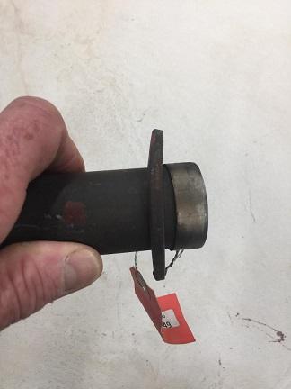

More good news, gentlemen. In addition to the exciting BW/Lextek/Alibaba offering, we have a new header to add to the mix, and it's a bona fide performance header at that: A pre-production prototype header assembly with specifications nearly identical to the Two Brothers Racing [TBR] 5th gen VFR 800 header is being constructed in southern California. (See list of the differences below)   Here is photographic evidence of the work in progress. This is a photo of the jig that has been fabricated in order to get the proper layout of the performance headers. Photos taken 12/26/2018: 654277571_small20181226_150915.jpg.46ce3b5f1a5cd9868140a442032da039.jpg[image: 283617769_small20181226_150833.jpg.8f21a61f958e2e50f1aaa45ae2537f36.jpg]     *Acknowledgements:   From the start of this project, we knew we'd need help, and so sought assistance from some very well respected and long time VFRD members.   Special thanks to VFRD member Cornercarver for the generous and trusting loan of his prized, irreplaceable [Until now!] set of original TBR headers.   We also would like to thank VFRD member RVFR for his support of this effort through contributions from the 2017 gofundme header fund.   Contributing members - all massively experienced and extremely helpful - include but are not limited to: Cornercarver, TimmytheCop, MiniCarver, BusyLittleShop, BuzznerSuntrusts, RVFR, Mohawk, Mello Dude, CandyRedRC46, Stray, keef, and 3dcycle. Our sincere thanks to all these individuals and others for their wise counsel. Without you, we could neither be getting a prototype built, nor could we have established a path to a production version of this performance header.     *General information / major bullet points:   [1] The production version of the performance header assembly described here will be hand built in southern California and cost $760.00 plus shipping from the manufacturer. California residents need to add 7.75% state sales tax.   [2] The header will fit 5th and 6th gen VFR800s. [8th gen owners, see Note 'a' below]   [3] The header will go into production when orders for 15 units are received with a $200 deposit per unit.   [4] The prototype header is scheduled to be completed by 1/11/2019.   [5] A baseline dyno run of a VFR fitted with 98/99 headers and same day/same dyno full tune of the same VFR with prototype header installed is scheduled for the week of 1/14/2019. [Dyno testing methodology is detailed under 'Dyno testing procedure']   [6] We will be generating and updating a list of individuals interested in purchasing a replica of the TBR header as described here.   If you are interested, PM us and let us know the following: a] what gen VFR [5th, 6th, or 8th] you would like a header for b] what fueling management system you use or intend to use c] if more than one unit, how many headers you are interested in purchasing d] if you are placing a deposit for a production run header   *UPDATED LIST OF PEOPLE WHO ARE INTERESTED IN PURCHASING OR HAVE PLACED DEPOSITS FOR THESE HEADERS IS KEPT HERE: https://www.vfrdiscussion.com/index.php?/forums/topic/88463-new-5th6th8th-gen-performance-header-now-in-production-in-usa/&amp;tab=comments#comment-1091360   *Background:   Over the past year, VFRD member Duc2V4 and I have made an exhaustive [ouch!] search for a manufacturer/fabricator qualified and willing to produce a reasonably-priced, high quality "replica" of the Two Brothers Racing 5th gen header assembly. The TBR is the accepted standard in production VFR performance exhaust systems. After unproductive efforts with several fabricators, in August of this year we were referred to and contacted a gentleman named Wade, founder of an established southern California exhaust manufacturing firm. Wade expressed interest in taking on this project. Communications about and development of this project have continued with Wade since August and resulted in the construction of the fixture pictured above, along with a pre-production prototype header, a dyno testing schedule, and a commitment to build a production run of 15 units.     *Dyno testing procedure:   Testing will consist of a baseline dyno run of a 5th gen VFR with OEM 98/99 headers installed [See Note b below]. After the baseline run, the test VFR's 98/99 headers will be removed and replaced with the prototype performance header assembly. On the same day as the baseline run, a full dyno tune will be performed on the subject VFR with performance header installed. The dyno tune will be performed on the same dyno by the same dyno technician, with the same air filter, same fuel management system, and same midpipe/muffler. [Test subject VFR is described in 'Test bike']     *Some dimensions, features, and specifications of the header will be taken from the TBR. The new header will incorporate the following specifications from the original TBR header design: -header construction will be from 18 gauge 304 stainless steel tubing, [0.049"/1.24mm wall thickness] -header will have 38mm od primary tubes [1.5" od] -header will have 41.5mm od secondary tubes [1 5/8" od] -header will have 51mm od collector tubing [2" od] -header's rear primary tube junctions will be fastened by spring tension fittings -header's left front and left rear primary tubes will merge -header's right front and right rear primary tubes will merge -header will have no crossover of front or rear primary tubes -header's collector exit tube will have a 51mm od [See Note c below] -header's tubing will be mandrel bent     *Some specifications will be changed from original TBR header design. To align with the VFR community's objectives and improve durability, the header will incorporate the following changes to the original TBR header design: -header's collector exit pipe will be modified to match position and angle of OEM collector exit pipe -midpipe/muffler/clamp to be supplied by customer [See Note c below] -midpipe/muffler to be fastened to header collector exit pipe by clamp [Clamp not supplied with header] -header will have two O2 sensor bosses at 2000-2009 OEM header's O2 sensor locations: one O2 sensor boss on secondary tube after left front/left rear primary merge, one O2 sensor boss on secondary tube after right front/right rear primary merge -right rear primary tube of all headers will be mandrel bent to provide 1/16" clearance from rear head cam chain tensioner when installed on 6th gen VFRs -header's stud nut tension flanges will be 1/4" thick stainless steel [See Note d below] -header's collars at head end of primary tubes will be reinforced and length adjusted for 1/4" head stud fixing flanges -header's internal flow surfaces at head end collar joints of primary tubes will be finished smooth/flush [See Note e below]     *Wade's credentials: Wade designed and built exhausts for Kerker Exhaust Systems from 1980-1988. Since founding his own exhaust fabrication business in 1989, he has produced custom, prototype, and production exhaust systems and components for numerous individuals and manufacturers, including Two Brothers Racing. He builds a production aftermarket full exhaust system for a current non-Honda V4-powered motorcycle. Here are two of his current projects. Photos taken 12/27/2018 and 12/28/2018 :
[image: 765448509_smallwork1.jpg.3846b3fed1f9d8f0c7ac8a1704954f28.jpg]437507577_smallwork2.jpg.89fa366c46a57ddcc00ba666c7b89875.jpg
1704453122_smallwork3.jpg.24c5c28b4621cafe13d2b13d11486114.jpg[image: 1730889884_smallwork4.jpg.8713a92380ad4f1677f5d93d04ca49c3.jpg]
423844924_smallwork5.jpg.1bef04c5c1deaf89529cd566854e7938.jpg1236302504_smallwork6.jpg.eeda2f6f5ec3c86b08132727fc9ec41e.jpg
  *Test bike:   For initial testing, we will use this motorcycle: 2001 California 5th gen with 60,000 miles K&N big mouth air filter [See Note f below] PC III USB, map dyno tuned in 2013 with OEM California ECU, no O2 sensors installed Dynojet O2 sensor resistor terminations installed on OEM O2 sensor leads OEM 49 state ECU now installed, PC III not retuned, no O2 sensors installed OEM 98/99 VFR headers ceramic coated with Staintune high mount slipon. Maintenance performed before dyno testing: New air filter, new Denso iridium IUH27#4 plugs, valve clearance adjustment, injectors professionally calibrated, starter valves synched, new thermostat, new silicon coolant hoses, new Engine Ice coolant, oil and filter changed w Mobil 1 0w-30 and Purolator PBL14610 filter     *Notes:   Note a - an 8th gen version of the performance header with 'widely spaced' front primaries is in the works for a production run to follow the initial production run of 5th/6th gen headers.   Note b - If there is significantly greater interest in proving the prototype header on a 6th gen, we have a 6th gen standing by and can use it for the dyno baseline run and test/tuning instead of the 5th gen. For 6th gen test/tuning, we will use the same dyno testing procedure at the same test/tune facility as described for the initial 5th gen test/tune. The 6th gen available for testing currently has ceramic coated 98/99 headers installed with gutted OEM mufflers and a PCV. We would obtain open flowing aftermarket slipon mufflers to optimize testing of the prototype header.   Note c - Wade recommends keeping the the 51mm od collector exit pipe instead of reducing it to the OEM exit pipe's 49mm od for the following reasons: 1 - it is probable that reducing the collector diameter will have a [small] negative effect on top end performance 2 - Wade uses premanufactured tubing merges of very high quality. Reducing the collector diameter would mean that the collector merge exit diameter would be too large for the 49mm od exit pipe, and the labor required to adapt the two components would raise the cost. 3 - purchasers of a replica header who want to use aftermarket slipons can have the collector end of their slipon expanded to fit the 51mm od exit pipe by any competent exhaust/muffler shop. Two Brothers slipons  and OEM mufflers will require exhaust wrap to function as a gasket in place of the OEM 'donut' gasket. 4 - the collector joint of all slipon midpipes we could think of except TBR are 2" od and slotted at the clamping end. Wade was concerned that a 2" od midpipe that has been slotted to clamp onto the OEM collector pipe is likely to tear at the base of the slots when expanded. IMPORTANT - when having a slipon's midpipe expanded to fit this performance header, make certain the muffler shop expands it gradually in two or more small steps. Wade recommends drilling a relief hole at the muffler side ends of the midpipe's slots to distribute stress and reduce the possibility of tearing. Wade tested the viability of expanded slotted 304 stainless steel 18 gauge 2" od tubing by slotting a piece of 2" tubing while I was at his facility. He then expanded the slotted end of the tube in two steps to fit over the 51mm od collector exit pipe with no tearing at the slots.   Note d - Here is Wade's 1/4" thick stainless steel head stud nut tension flange: 1687569010_smallwork7.jpg.85661739982bb4d81adc59f92242d117.jpg   Here is the original TBR head stud nut tension flange [Note that flange is bent from tension]: 1483054119_smallwork8.jpg.ab511eade0561046fbacea8b6b083aed.jpg   Note e - Original TBR has rough, unfinished joints in the internal flow surfaces at head end collars of primary tubes   Note f - See RVFR's June 8 2017 post on page 5 of vfrd thread '5th & 6th VFR 800 header build' for photos of standard vs big mouth K&N air filters. Both filters have K&N part number HA-8098   Note g - Significant improvement can be achieved over OEM gas flow through the exhaust port into the header primaries by using crush gaskets that do not intrude into the gas flow path when installed. The id of OEM VFR crush gaskets reduces to around 30.41mm when installed with header stud nuts torqued to spec. The exhaust port id is 32.45mm - that's a 2mm reduction in gas flow passage diameter. To solve this, we will be confirming Mohawk's recommendation to use GSXR750 crush gaskets between the performance header primaries and the VFR's head.   Note h - Wade has expressed a modest willingness to build complete exhaust systems in high or low mount configurations for 5th gen VFRs. These full systems would have the same specs as the full systems that were the only configuration in which TBR sold the VFR headers - the TBR headers were only available with a matching midpipe and muffler/canister. Mufflers built by Wade would be available in metal or carbon fiber. I neglected to ask Wade which metals he uses for muffler/canisters or what a full system would cost, but I will ask him to specify materials and pricing. I have not yet introduced the possibility of Wade building a 6th gen full system, but I will ask him if he'd consider it.

#470
The lextek isn't that encouraging at all,  TBH unless you're ready to buy a budget header than start hacking and mandrel bending it and re welding the first 8 inches of all 4 primary tubes.
Pretty obvious that the multi-stage primary tomfoolery evident in the lextek/bw/alibaba header isn't working.  I'd say it's in way better shape than any of the delk/black widow/sbs/motad crap headers,  because for around 100 bucks at a legit speed shop they can be turned into something very much like what we're designing here.   But again.  as it sits it's yet another OEM replacement with a few perks until you chop it up.
But at least it has that going for it.
Proper primaries on these bikes pick up power just off idle.  The graph you've provided is great testament that they got the merges right.  it's 90% there but they fucked up the primaries.  which is what I've been saying since I saw them/aquired some data through email about them.  at the outlet of the head they're no different from Vtec/8th gen pipes.  and it's why they aren't making More power until later more than likely.
They pick up that immediate 3.5-4 ponies similarly but they don't do it from 3 grand on like the 35.5mm inners do.
[image: 1269798220_Attackmidrangecomparison1012619.thumb.jpg.d9a7af5620ee8ed849ca46ea206d50d6.jpg]
