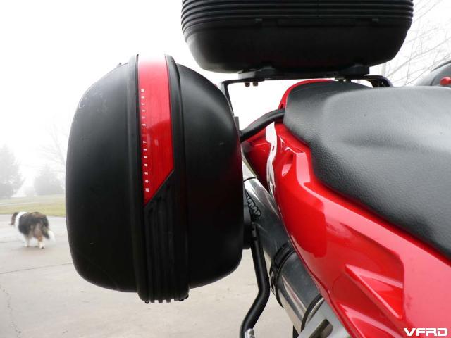

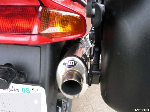

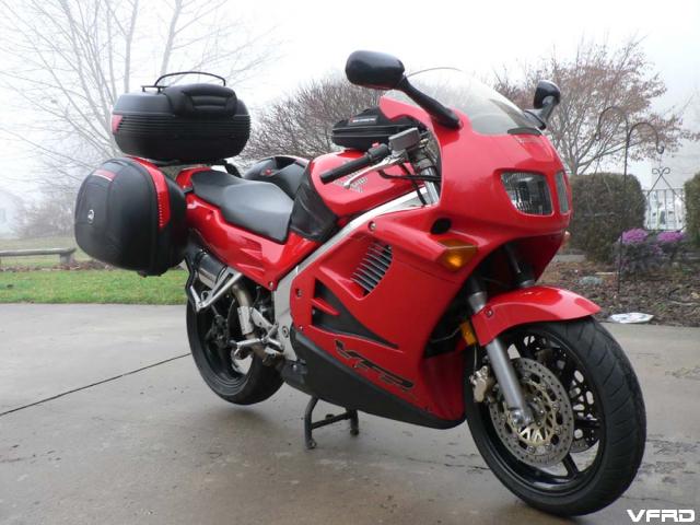

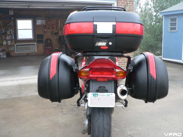

I�ve found postings asking if the Givi wing rack will work with a high pipe, but no answer. I just mounted a Givi wring rack on my 96 which has a Micron high pipe. The tail end of the can touched the wing rack. I mounted a computer CPU heat sink between the can, which has a rubber trim piece that contacts the smooth back side of the heat sink, and the wing rack. The wing rack had a hole right where I needed to run the bolt through. I�ve only ridden with it two days. No problems no vibration and no heat being transferred to the bags. I love not having to commute with the backpack.

Well, thats what my bike would look like with bags. Nice to see.

They are equivalent to an E360 side and an E52 top case. I got then used and there are no model identifications on them. I have not had a heavy load, just my going to work stuff. I felt I was moving around a bit on I270 when running 80 with the traffic. It was gusty that day so I didn't think it was anything unusual. Other then needing to bend my knee a lot more to get on or off I would not even know they are there. Oh yeah I do see the side cases in my mirrors.

regarding the clearance at the silencer - I just used longer bolts on that side and spacers (1/2") under the side plate to move it away from the can. Also requires a small bracket at the footrest - or space out the footrest by the same amount.
