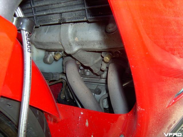

[image: DSCN0218.jpg]
I cut the stock lines with a pipe cutter and capped them with brass plumbing caps and JB Weld.
capped off PAIR lines
You can still get the block off plates for XR650L's which I believe are the same thing, at least they look the same on my bikes. But that would be about $50. The plumbing caps only cost me a couple bucks. (IMG:style_emoticons/oldemoticons/beer.gif)
You'll also need to plug the holes in the airbox, I did that with some wire nuts and epoxy.

johne, Jan 20 2007, 12:44 PMWelcome to the forum Scott.
The weight savings is next to nothing but it does make maintenance chores like synching the carbs easier.
