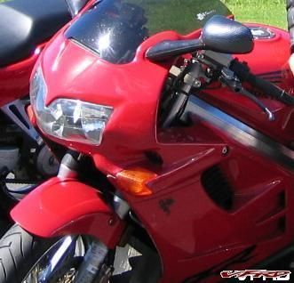

Here are the damages (covered with duct tape, but you get the idea):
[image: med_gallery_7692_2036_25703.jpg]
Custom work (for further discussion):
So, I am looking into buying a new left side fairing. And I seek all of you guys (and girls) wisdom!
My options are:
1) Buy a Honda fairing - expensive, very expensive
2) Buy used Honda fairing - anyone has one to sell??
3) Repair the old fairing - Not sure what Sebspeed have to say to it. He is the master in this matter. But probably not doable, even though kind of easy option for me.
4) Buy another aftermarket faifing - Airtech
So, if only option 4 is possible, then:
Firstly, What do you think about the Airtech fairing? Experiences?
and secondly, Is it ok if I buy only the mid left and mid right panels? I need only left but I think I should balance out the weight.
Or, maybe it would be better to buy the whole 'race' fairing and the front light fairing and just cut out the opening for the light (but then, the front lights are 5th gen - not sure how that would fit) I would not worry about the price - I can sell my old fairing on the ebay and make money smile.gif
What do you think about the naca ducts being molded in?
Anyway, WHAT do YOU think ??
Thanks,
yours Martina
