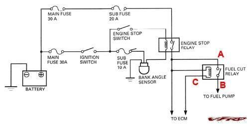

PROBLEM: Relay says the following:
12 V NO .... with the typical relay diagram drawn.
engine stop relay
ok.. Confusion sets in. If I am allowing current to go to the relay, the Normally open relay should be closing, thus providing current to the fuel pump. That makes sense to me...
What am I missing? I have bypassed the BAS sensor by shorting across the engine stop relay and CAN crank my 5th gen. errr.. CAN power the fuel pump. I DID check out my switches as well, and to the best of my knowledge, both the ignition switch AND the engine stop switch tested out good.
Short across the relay to bypass BAS
BAS technical data: The BAS is made up of a latch-up circuit, and NPN transistor, a lead switch and a magnet based on degree angle of the sensor. Any pics of diagrams that may provide to be useful can be taken and posted ASAP.
Any ideas? I think I have provided needed info..

PROBLEM:
Relay says the followinG: 12 V NO .... with the typical relay diagram drawn.
engine stop relay

Reposting my reply in this thread (since the other one will probably be pruned).
Here is how I would troubleshoot this situation.
Test number one.
Pull out the fuel cut relay.
Measure the voltage between ground and point A.
With ignition on and the stop switch in "RUN" position, it should read 12 volts.
If you get that, stop messing with bank angle sensor and engine stop relay. They are fine.
If you don't get 12 volts, fix your bank angle sensor, engine stop relay, fuse or wiring.
Test number two, after you pass test number one.
Leave the fuel cut relay out.
Put a jumper between point A and point B
With ignition on and stop switch in "RUN" position, the pump should run continuously.
If it does not, fix the fuel pump or its wiring until it runs.
Test number three, after you pass tests one and two.
Put the fuel cut relay back in the socket.
Put a jumper between point C and ground.
If it does not, replace the fuel cut relay or fix the wiring until it runs.
If the bike passes all three tests, yet the pump does not run when it should - you have a bad ECM or bad wiring between the ECM and the fuel cut relay.

Hmm.. that is nice troubleshooting Citizen. Although very well put together, I think my current setup knocks perhaps at least one out...
Current:
1. Shorted across Points A and B (as according to your labeling above) on the engine stop relay.
2. NO bank angle sensor even mounted (being bypassed)
3..... continuous fuel pump action.
Therefore, that rules out fuel cut relay and fuel pump... Correct? hat should also in effect rule out ECM... correct?
Hmmmm... maybe I should check my engine stop switch again... but, that does does not explain the voltages I was reading on the bank angle sensor as per the Honda manual.... hmm...
That rules out engine stop relay and fuel pump. Fuel cut relay or ECM may still be bad (they are both bypassed in the above test).
Hmmm.. maybe I am confusing myself, but if I short the Engine stop relay, then due to the fact that the fuel pump is powered and working, that would rule out the fuel cut relay... Current runs from (+) battery terminal, through a 30 A fuse, a 20 A sub-fuse, through the shorted engine stop switch.. from here, it goes straight to the fuel cut relay (which HAS to be closed if the fuel pump is to receive power), then to the fuel pump.. Due to the fuel pump receiving current, the fuel cut relay is being closed via the ground off the fuel pump and the current from the engine stop relay....
What am I missing?
What am I missing?
Sorry, I did not read your post right.
So, you were shorting between points A and B on the ENGINE STOP relay and the pump ran, right? Then yes, the fuel cut relay and the ECM are good.
Next question: does the engine stop relay click when you plug it in with the ignition turned on?
If it does click, yet the pump does not run - replace the engine stop relay, it's bad. Yes, a bad relay may still click.
If it does not click - bad bank angle sensor, stop switch, 10A sub fuse or wiring.
You can bypass the bank angle sensor by shorting its terminals #1 and #3.
Ahhhhhhhh!!! bypass bank angle with 1 and 3.. didnt see that.. was thinking 1 and 2... hmmm .. hafta try that.. lemme go back over that last post Cit. ... PS.. thanks for the knowledge.. you are definitely helping..
I guess not knowing that, I was trying to find some way to test the transistor inside the BAS.. very nice....
Well heck.. showing voltage b/t 1 and 3 would be the same as shorting right? that is, normal batt. voltage...
If you actually tried shorting 1 and 2, your 10A sub fuse is now blown and needs to be replaced.
You're welcome. Let me know how it's coming, hopefully you'll get your bike running tonight and still have a few hours to sleep before riding it tomorrow. http://www.vfrdiscus...tyle_emoticons/default/smile.gif
No, that's not the same as shorting it... But the battery voltage there tells you that the engine stop relay has a good coil. When you short 1 and 3, the engine stop relay should click and the fuel pump should run.
ok.. sounds good.. I will not be able ot run out to the garage for another 20 minutes.. but i will definitely do that on priority.. that will help me a WHOLE lot in diagnosis.. Thanks again *Citizen*....
Will let you know how it turns out.. depending on how late you stay up in Orlando, I may have an answer to you pretty soon.. :beer:
I'm still awake, so keep me posted. Easy on the beer. http://www.vfrdiscus...tyle_emoticons/default/smile.gif
Hah!! Apparently it is a Newcastle night... hehe
Yeeeehaw.. ok ok.. so the fuel pump has primed.. but how???
No clicking of any engine stop relay....
But rather, the initial testing showed the correct answer.... The Bank Angle sensor... !#!#$% it... thats $61.00 for a sensor via servicehonda!! sheeesh..
Looks like a winner to me.... Wish I could test the ACTUAL BAS just to appease my curiousity.... hmmm.... latch-up switch + transistor + lead switch.. hmmmmm...
:joystick:
Hmmm.. Now, since it will probably take service honda at least 5-7 days to get a BAS to me, IF they have it in stock, and knowing it will cost $61 +shipping, my question arises:
To Buy a new one or to short across the three pin conneector?? hmmm...
Is that a question of 'How dangerous I wanna live' or should i say "Quit being stupid Michael and buy a new one".... thoughts on the idea??
Orrrrr..... Seb said he had a bunch of these?? ewwwwwwwwwwww... :beer: But for now, lets eliminate that I have that option since I have yet to insure myself of it...
That's weird. The relay should click in order for the pump to work... unless its contacts are weld shut from heavy arcing.
You have bypassed the sensor (terminals 1 and 3), not the relay itself, right? Does the pump stop when you turn the engine stop switch off?
You can.
Keep the BAS upright.
Connect ground to terminal 1.
Connect +12 volts to terminal 2.
Connect a _small_ 12V lightbulb (like a dashboard bulb, nothing bigger than that) between 2 and 3. The bulb should light up.
Tip over the BAS. The bulb should go dark.
And I personally would not have any problem leaving the BAS bypassed until I get a new one. But that's your call.
But before you order a new one, check the 10A sub fuse again. You should read 12 volts between BAS terminals 1 and 2.
Like I said, I have at least 3 of the BAS's here. If you want one, just pay the shipping. Priority mail should take 2-3 days to get to you.
PM me if you want one.
No no no... I was referring to the earlier two step process of testing the relay or the BAS....
1. plug in the relay with the ignition on.. does it click/
Nope.... no clicky.... That is what I meant...
Of course when the BAS terminals were shorted, it definitely clicked...
Heading your way via PM SEB... :salesman:
Then, out to test out the BAS...just for confidence...
Oh... Well, then it's either the BAS or the 10A fuse, everything else has been ruled out.
--Manual says within the three post connector leading to the bank angle sensor (BAS), you have one ground, a positive coming from the ignition switch from the (+) battery via fuses, and the third post leading to the engine stop relay that will power the coil which will in turn power the relay switch, and provide power for the fuel pump.
-- MANUAL: ground ---> positive = Normal BAtt. voltage
ground ---> 3rd post engine stop relay= 0-1 V Both of these WITH ignition ON.
Therefore, I assume since the third post of the connector is NOT norm voltage, the engine stop relay MUST be normally closed so the fuel pump can receive current.. Right?!?! Well, testing showed opposite:
It looks like the BAS doesn't provide coil voltage to the engine stop relay, but rather it provides a path to ground for the coil voltage. Your engine stop relay is normally open. It receives its coil voltage from the engine stop switch. If there is no path, through the coil, to ground (via the third leg of the BAS), the engine stop relay won't energize and its contacts remain open. If I understand your post, you measured full battery voltage at wire #3 on the BAS. That means either the sensor has caused that line to go high, eliminating your relay ground, or the sensor is open and you're measuring the engine stop relay coil voltage floating high on the BAS. I don't really know how the BAS works.
Anyhow, you've pretty much already narrowed it down to the BAS.
