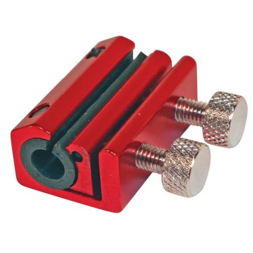

I used to have a syringe type thing that allowed you to force lube down into a cable while only disconecting one end. :fing02: JC Whitney or something.
To remove the choke cable you'll have to separate it from the lower half of the plastic clamshell thingy.
Best way to do that is to take the handlebar off and slide it free of the control housing and choke lever, then when it is free of the bike and the wiring is disconnected, you can unhook the cable end off the choke lever and thread the control housing off the cable end.
Then use a cable luber like this:
