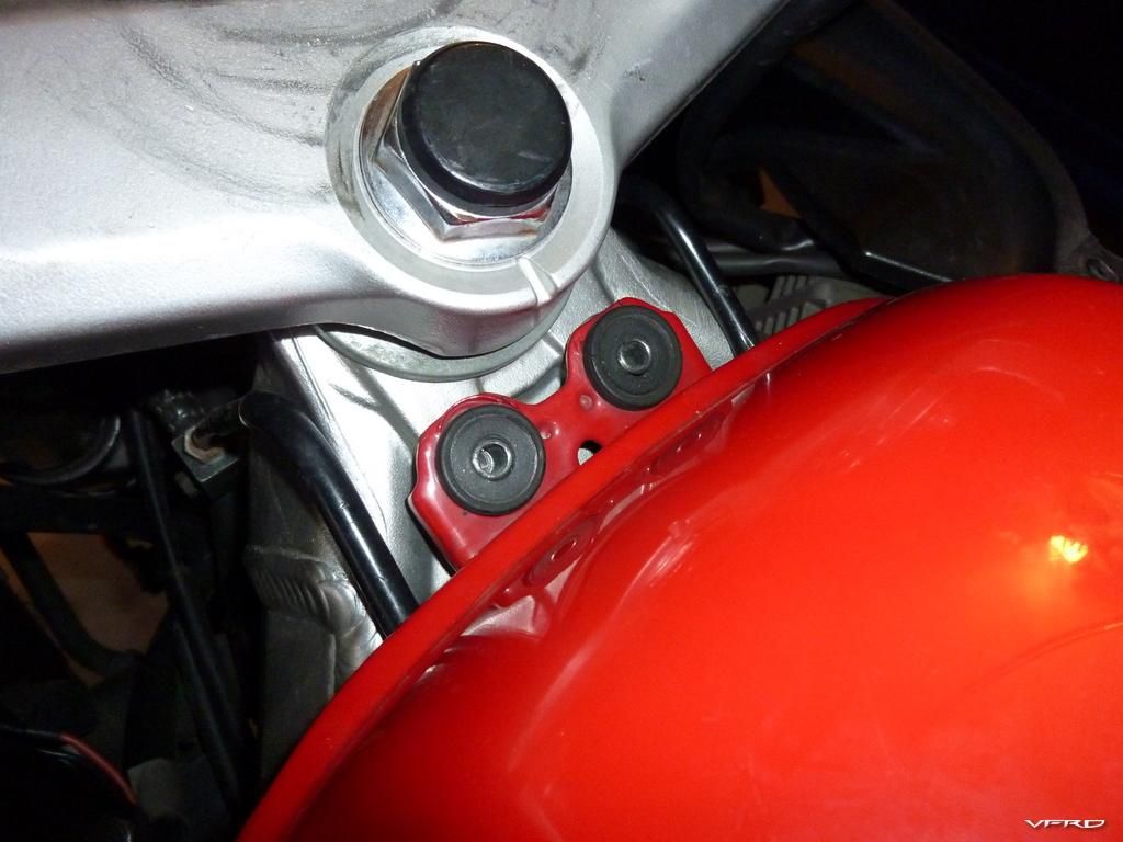

Next, lift up the tank:
Remove the two 8mm bolts which secure the tank.
Once the tank bolts have been removed, lift up the tank and replace one of the bolts, like so:
[image: gallery_380_5242_353250.jpg]
Screw the bolt down a bit, then spin the washer so it seats against the frame.
We're going to use this bolt which is nicely sticking out of the frame as a means of securely holding up the tank. I have used some socket wrench extenders, with the hollow end sitting over the bolt head, and the solid end pushing up under the tank, like so:
[image: gallery_380_5242_114431.jpg]
Nice and secure!
