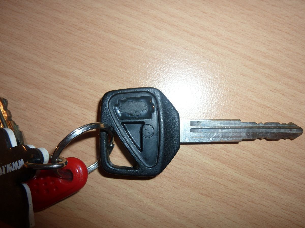

Huh? Last time I looked at one of my '02 keys the chip was epoxied into the key under that sticker and not removable. UPDATE: They're only sealed in using silicon and pop out easily.
HISS chip epoxied siliconed into OEM Honda VFR800 key.
I think it must be those aftermarket eBay ones you're buying which aren't sealed into the key.
My Mistake the spare key I have doesn't have chip epoxied you can remove it.

zRoYz- Nice write up on how to get around the red key as most dealers will tell you that once you loose your programming key ( red key) you can no longer get anymore keys for your bike ( This is not the case for any bike, I will get to that soon)
kaldek (And everyone else)- not really a good idea to show a picture of your key on the net, it is not hard to make a key from that picture especially for someone who know's what they are doing, you don't want to make it easier for someone to take your bike.
kaldek
That is highly, highly unlikely. It's not a Ducati Panegale S, it's a ten year old VFR!
So, someone copying my key based on my video and then tracking me down to steal my bike (which they will know has been in pieces and had lots of problems - based on my other videos)? Nah, there are easier targets on every street corner in Melbourne.
Just because something is possible doesn't mean it's going to happen. Risk management is my day job, so I do lots of things people think are crazy because either A) the possible outcome is negligible or B) the likelihood is extremely low.

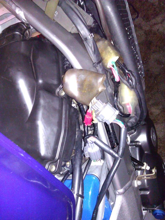

Hi guys just about to copy my keys
Made my ghetto leads and all
And mine is totally different to u guys
No red plug
Colours of the wires are different please help.
Take a look
2005 vfr800
Edited November 9, 2013 by N2v
You need to lift tank the wiring you want is between frame & throttle bodies & is with the big grey fuel injection plug. You have the wiring that runs outside of frame coming from R/R etc.
ilim007 has posted pics above of fuel injection plug & red plug that is in that area.

I then tried to programme in a cut non-HISS key with an ID46 chip from eBay glued to it. The chip was advertised as being for Honda HISS.
This time the key did not programme in, and the 4 regular blinking HISS light sequence was different, The final blink of the 4 was spaced out from the first 3 flashes.
Unsurprisingly this key does not start the bike.....so I threw the chip away and keep it on my keyring to unlock the tank and seat.
Any ideas why it didn't work?
