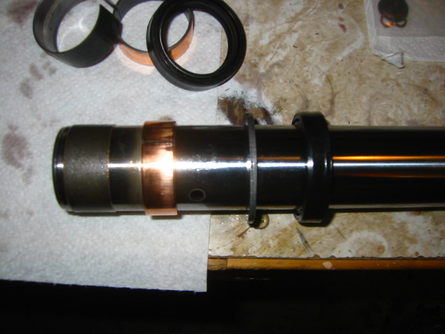

Today I found out my right front fork seal is ripped and spewing fluid everywhere.  This is not a repair I'm going to take on myself and my wife is going to be none to happy about more $$$ after all of my mods to my new-to-me bike.

Ripped Seal
[image: index.php?app=gallery&module=images&section=img_ctrl&img=590] Fork Seal - the culprit Album: Drip Drip - April 2012 Uploaded 29 Apr 2012 - 18:24

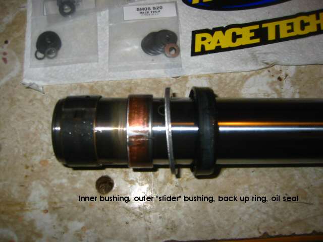

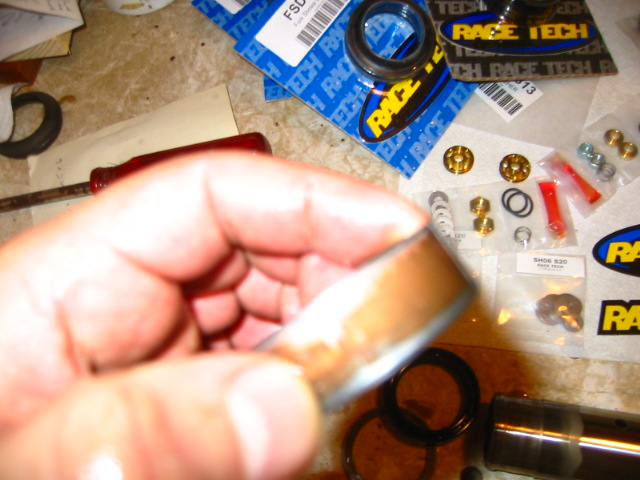

Have the slider bushings inspected too the teflon wears out on them and they get sticky, a few bucks more to replace the set.
