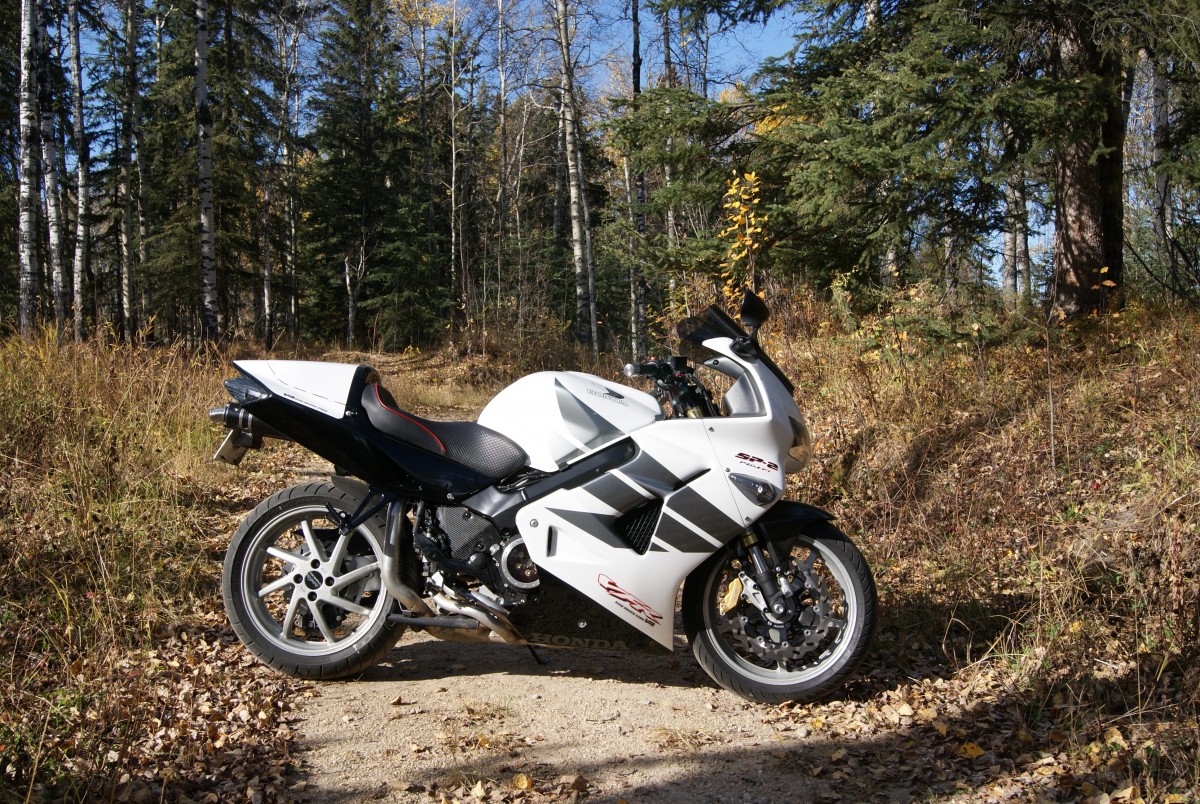

On my 04 Vtec Track bike I installed a full F4i front end w/calipers and radial M/C, new shim stack for stock Rebound valve and changed to large port Showa Compression valves w/new shim stack. Felt Great and fully adjustable.
[image: post-301-0-23654300-1327363714.jpg]
[image: post-301-0-71729600-1327363758.jpg]
[image: post-301-0-05801400-1327363886.jpg]
[image: post-301-0-03821600-1327363933.jpg]
W/ F4i forks you can use stock VFR wheel/Rotors or F4 wheel & stock rotors or F4i wheel and rotors. I used a stock 06 Vtec fender on teh F4i forks, only 4 of the 6 mounts bolts work, but that's plenty.

Did this Suzuki TL1000R Front end on the wife's Gen 3.
[image: DSCN0512.jpg]
Is better in the corners than stock the best I can tell. The biggest plus was in the breaking.
That bike is gorgeous! :ohmy:

Because I wanted matching wheels, I have  05 gixxer 600 yokes/stem forks and calipers Gixxer/hayabusa 320mm rotors and an 848 front wheel. With a spacer or 2.
I want to upgrade to Yamaha monoblock calipers, or newer zx10 calipers.
Though lacking that sweet brembo emblem, the Yamaha calipers are phenomenal.
My MT09 has them. With the fz1MC, braided lines and 320mm rotors they are very effing good.

my 95 with an 09cbr600rr front end. its a direct swap, nothing special needed. the whole thing bolts off the 600rr and onto the vfr and even the fork stops are perfect. The only thing I did was cut off the tab for the 600rr steering stabilizer or it would hit my tank.
[image: 20141023_080905_zps9bofqgty.jpg]
I know this thread isn't alive much anymore but the information here is super helpful. As to the quoted post, is there any follow up by anyone who's tried this yet? The OP did it on a 4th gen; are there enough significant differences, between 4th & 5th gen, to rule this out for a 2000?
Looks like you'd need to do a de-link to the 2000, and use the CBR wheel as well (whole front end).  Wondering what the Gemoetry looks like compared to 5th Gen Stock?

Veefer800Canuck, 1/24/2012 at 1:40 AM
RC51 forks on a 1999 VFR800. No, I would not switch back.
The longer trail due to the RC51 triples different offset makes the bike steer slower (all else being equal) but on my bike, the front end is slightly lower than stock, and the rear end, I raised up, plus the handlebars are wider for more leverage, so it pretty much cancels that effect right out.
The brakes are absolutely stupid, and the ride quality and adjustability are far better than the standard VFR boingers. I added an Ohlins rear shock, courtesy of a VFRd member, and the transformation is complete.
[image: gallery_554_5200_7067862.jpg]
