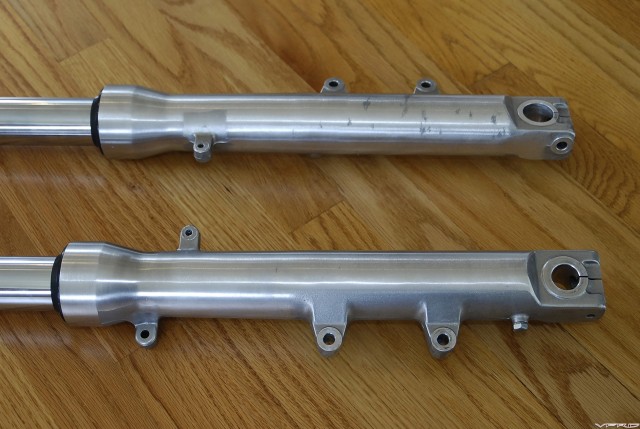

My '92 VFR's forks were not in that state but did need some attention so in '07 I removed them from the bike. After a good wash the first coat of paint stripper removed most of the old paint. Steel wool (#0000) plus stripper took care of any remnants. The alloy on mine were scuffed but a little emery paper, scotchbrite pads, and Solvol had them looking just right. There are circumferential marks in the alloy that I didn't want to polish put so I went with the grain, so to speak.
My plan was to clear coat the lowers but opted to leave them bare. When I sold it 2 years and 20K km and they still looked great.

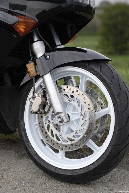

The painted fork lowers were scuffed and peeling so I set about tidying them up. I removed them from the bike though you could probably do them in situ.
LBB4872e
LBB4872e
The painted fork lowers had seen better days so I removed them before stripping the paint. I was going to spray them with clear but decided to leave them bare and see how they fared. A couple of years on they still looked perfect.
