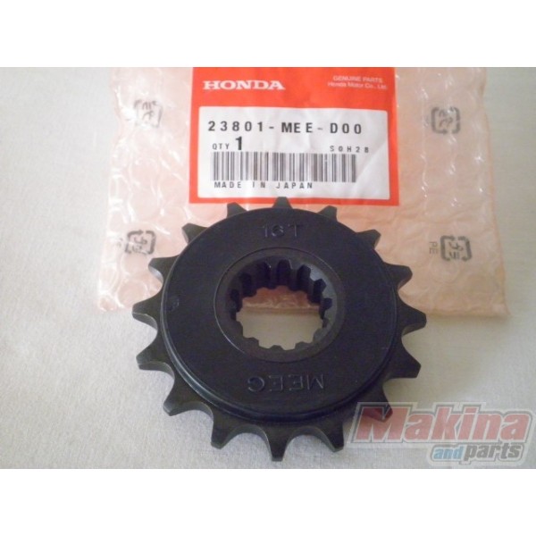

Here is the OEM front sprocket with the rubber cushion. This one is for a CBR, but you get the idea.
[image: 23801meed00-front-sprocket-honda-cb-600-]
And without, but also notice how damn POINTY the sprocket teeth are compared to the OEM ones, I don't like that myself.
