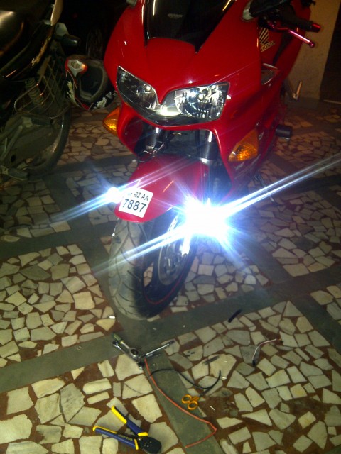

Got these ... they are good enough and more..     [image: 05. Fork Light LED Front view]

This may not help your question on where to install the LED lights but my brother just put a set of those exact LED lights on the front bumper of his Dodge Ram3500 and they are ridiculously bright.  If you can find a good spot to mount the lights I'm sure there will be many a deer transfixed and blinded by the light of your oncoming bike.
