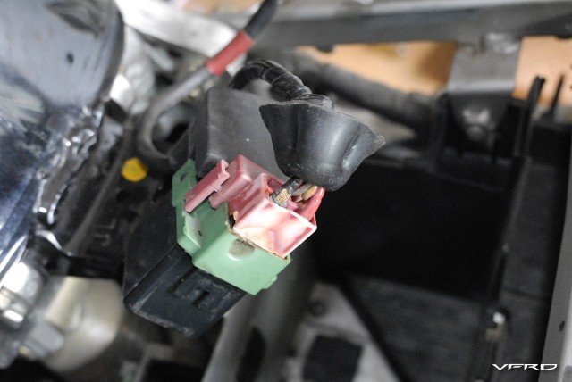

If you haven't already done so, check all the connections on the starter relay - located between the battery and fuel tank. A failure of these connections means not juice from the reg/rec gets to the battery to recharge it. It only takes a moment to check and could save you some money.
Here's what my '92's looked like:
starter relay troubles
This is the starter relay connector on my '92 VFR750 and it had overheated and failed. Charging current from the reg/rec goes through it en route to the battery, so when it failed my battery kept discharging. I didn't find this little devil till after replacing the reg/rec and the battery.
It is possible that the reg/rec was outputting too high a voltage but, imnsho, the fault was due to corrosion.

BRad, If you haven't already done so, check all the connections on the starter relay - located between the battery and fuel tank.
I was looking at your post this afternoon from an older thread. :-)I will check that out tomorrow for sure. Thanks for the tip! Sent from my handheld-sending-thing...

I looked over the starter relay and connections, and unfortunately, they all look fine.  :)
