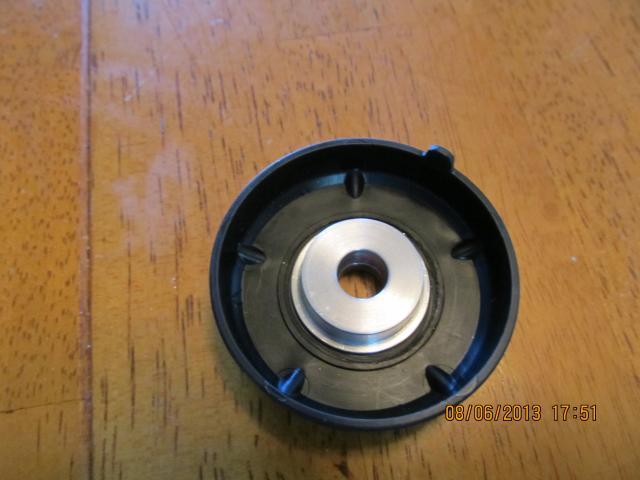

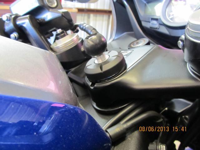

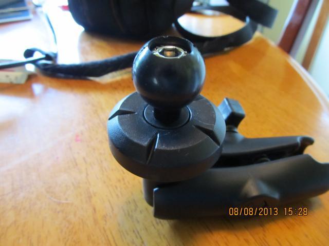

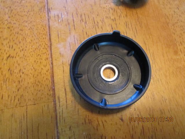

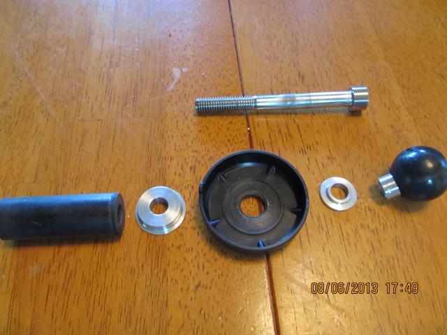

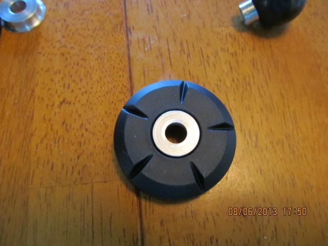

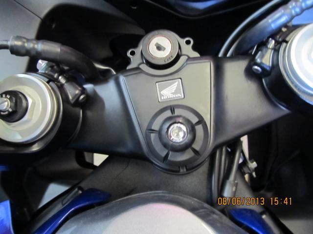

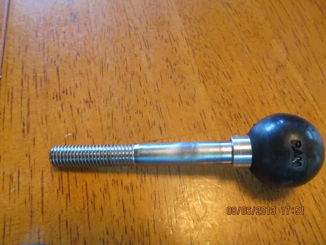

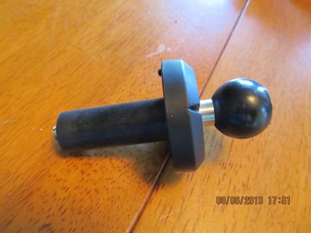

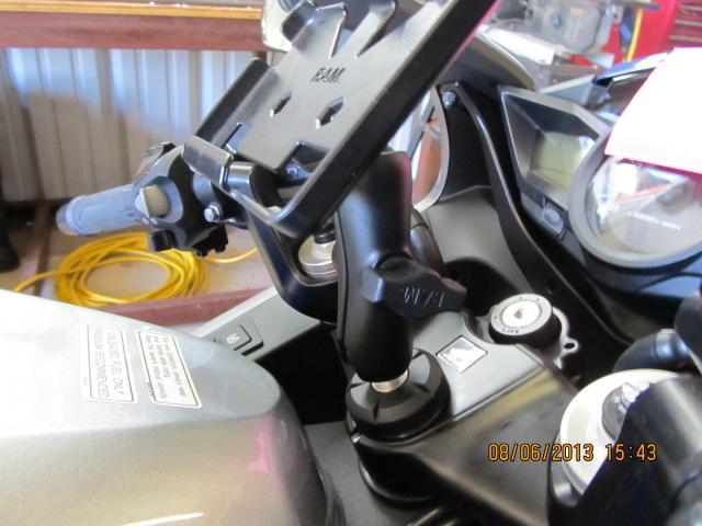

I have tried a couple of different Ram mount systems for the 1200 and just wasn't satisfied with either one. 1 system would not stay tight and rotated constantly, the other system held tight but did not retain the OE steering stem cap and did not want to stay centered. So, I played around with an idea I had for a while and this is what I came up with. The key to this set up is the machined step washers. This unit will stay tight, won't rotate, stays centered, and retains the OE steering stem cap. The large machined step washer is a slip fit in the steering stem so it keeps the unit centered with the stem. The smaller machined step washer keeps the OE steering stem cap centered and from being crushed and split when the unit is tightened. The 2" well nut tightens down enough that the unit will not pull loose or rotate. I have 1 other unit that will be tested by another member next week, so I will let him give his opinion on it then. It will also fit a 5th Gen and 6th Gen as test fit on a local members bikes. What do you guys think of it?

Thanks glory, I think Jon will be happy with it. He and Gary gave me a few suggestions during the development stage and we even test fit it to Jon's 1200 and Gary's 5th and 6th gen before the final change was made. An engineer and a machinist are good people to know. I think it is the only set up I have seen that actually looks like it was made for the bike, not just something stuck on it. A lot of small changes to get to this point but it is done. If it works like it seems it will I might even make a small run for a few members. Hope to see you soon at the hog tie.

I have a ram stem mount with the ball at 6 o'clock. It holds a 7" Samsung Galaxy tablet on a short arm just fine. Just got an 8" tablet that will takes its place. It doesn't move when I'm riding but mount/dismount of the big tablet can knock it off-center slightly. I can certainly see how yours would be better.

I have put about 1500 miles on this set up now and it has not budged. Not sure if Jon has mounted the hula girl yet so not sure how he is liking his :ph34r: . I will let him chime in when he gets a chance.

It is complete, ready to install. Just clean the steering stem hole really good with brake cleaner and a rag, insert the mount, and tighten it down. I am waiting for a few more Ram balls to be delivered. As soon as they are here I will machine those down and I will have a few sets ready to go.

I've toyed with Fred's mount a bit. This thing is serious!
