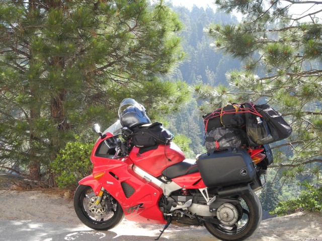

Here is my approach, get a small, light plastic siphon and travel with guys with the bikes that have uber large tanks ... Then you can easily risk doing 290 kms and laugh at the servo that you were nearly out of gas ... BMW adventure bikes with the big 33 litre tanks are best ... Buy them one free tank load at the start of the trip and they might stay with you for 4000 kms .... Awesome insurance ...
Is there a way to rig a small bottle/canister under the left bag similar to what I have done on my 5th gen here? This one liter bottle is my emergency and stove fuel.
Out West in the USA, tank range is a big deal sometimes and several times I have been faced with 200 miles between petrol stops. I always carry a siphon hose as well and usually ride with ST oil tanker bikes.
Or gas tankers. 33 litres is 8.8 gallons
BonusVFRIs there a way to rig a small bottle/canister under the left bag similar to what I have done on my 5th gen here? This one liter bottle is my emergency and stove fuel.
I'd like to see a couple better pics of your mount there myself. I also carry a 1 liter aluminum can full of fuel when I'm traveling, but it takes up valuable luggage space. That's a right clever idea.
better check with DOT on that !!!
I used a 2L fuel bladder in the tank bag for a night time run I did occasionally. Fuel was either not always available or I would rather not stop. Connecting the line from the bladder to a 'T' on the return fuel line to the tank, after the back pressure valve worked fine. A Hemostat was the on/off. My lap top in the tank bag, did some pressurizing. After ~100 miles open the Hemostat. R3~
DD ...here is another shot of the "Tool Tube".
I think I got these at a hardware store but they are available from Twisted Throttle. http://www.twistedthrottle.com/twisted-throttle-tool-tube-w-mounting-kit . The one liter MSR bottle fits perfectly. I mount them on my SW Motech racks.....there was not enough room to put them inside the racks.
I see that I have another flask in one of my bags but that is for me not the bike.
