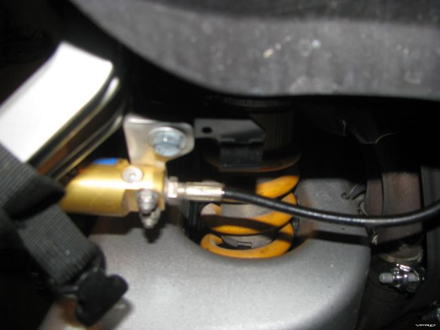

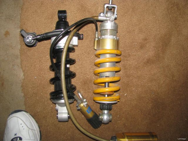

first chance to ride since putting the Ohlins shock in and WOW..what a big difference...i'm sure a heavier spring would have helped the stocker, but the ohlins feels great !!!   couldn't do much because of the salt and gravel on the road but it's def $1100 well spent...had the bracket painted black

an FYI to those considering the Ohlins rear shock  (HO-013)  because of the bracket supplied for the preload adjuster and remote reservoir, the rear tire hugger can't be used....after only a hundred miles or so of testing so far, i still think it's safe to say i'd pick the ohlins...this pic is after 27,000 miles without a hugger[image: P1010003.JPG] [image: P1010001.JPG]

I have ohlins on the veefalo as well - turns out the shock is the same size as the 5th gen, same length - I had the spring beefed up already so it was a nice fit. Salvaged the Ohilins from the Old Girl 1998 after it was totalled, front end was smashed up but the swing arm was untouched.  I sent it to Ohlins to have it rebuilt - they replaced the seals and replaced a bad pneumatic slave cyclinder for the preload adjuster $300.

i had the remote bracket slotted for more air flow to remove heat from the rear cylinders.....came out better than the job i did with the drill on the 2010....had it powder coated too......came out nice....$20 for machining and $20 for coating
