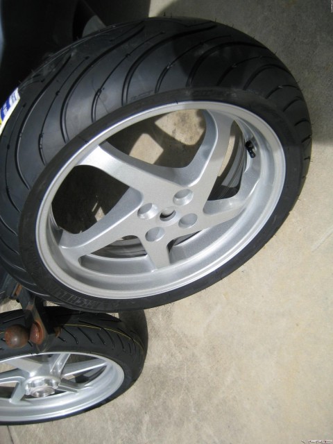

A look at the back wheel.  Yes I had to do the Bridgeport stems, wouldn't you?
rear wheel powdercoated
silver metallic urethane

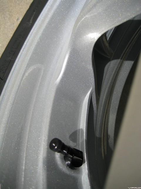

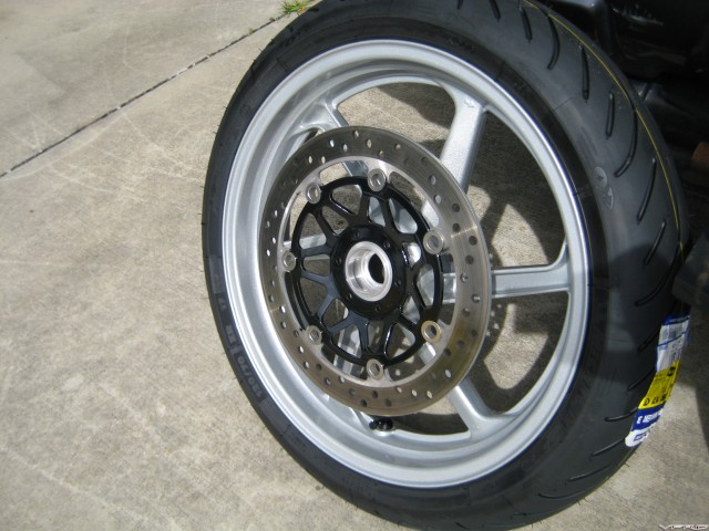

  A look at the front.  Yes - the rotors would have looked out of place in gold.  IMHO Black is what was needed. Powder Coated rotor
Powder Coated rotor
  A Look at the sparkle of the powder, crummy camera doesn't do it justice! Sparkle in the Powder
