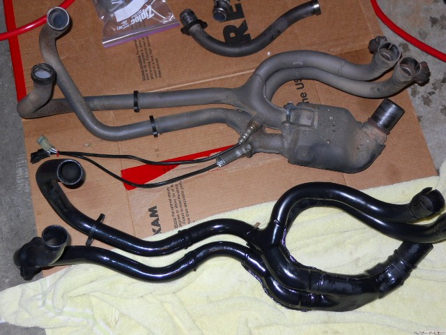

I bought a set of cat-less '98 headers for my 5 Gen and had them ceramic coated, getting them put on is another story. I bought another set for my 6 Gen but that set needs to cleaned up a bit and I'll have them ceramic coated too.

Catless and designed better to be catless.
PLUS they have 3mm Larger tube dia. making them flow more/better !!!!
I think Motad or Delvek make a SS Catless set, but neither are quality built like OEM Honda.
Gutted works, something looks fishy how the cut vs weld was made. Someone got it right 2nd time round eh?
Any video of said gutted collector ?
Nice DIY job... looks good. No offense, but that cat chamber was designed to maximize catalyst surface area as the exhaust passes through the honeycomb not efficiently usher exhaust gases out when the chamber is empty. That in conjuction with the larger diameter exhaust runners that BR pointed out makes a 98-99 header more of a performance upgrade than a gutted cat chamber on a later model

Ok guys, I get the increased flow theory regarding the 98/99 headers plus the cat box too, but I fitted a set of de-catted 6th Gen headers to my 5th Gen 7 years/70k miles ago and noticed NO performance difference whatsoever. It still feels stronger than my 6th Gen mid-range and it doesn't rust. So despite the theory, in practice I don't think that anyone could notice whatever performance difference there may be.
JMHO of course.
Rush   the  bottom  header  is  after  coating ?
And  what  you  guess  a  5%  gain  in HP's ..
Yes and yes... probably 3% - 5% gains to be realistic throughout all the people who have made this mod.

Fair enough, by the seat of the pants with nothing to compare side by side you probably can't notice a few missing horsepower or ft/lbs of torque... but its there and its measurable; and if you had another identical bike with a properly set-up performance exhaust to ride right after riding yours... I think you would feel the difference.

So you are saying the gutted system is worse off by collector design?
What I'm saying is a cat-less '98 - '99 exhaust header is a better performance mod than a gutted cat system. The empty cat chamber is not designed or shaped as an efficient "Y" collector pipe and the empty chamber will have turbulent gas flow because of that. Because of the shoulder, or squareness, of the chamber it can even develop a resonance with a reflected wave that could reduce exhaust scavenging effect at certain rpms. The tubes of the catalyst honeycomb would direct gas flow and prevent this in normal operation.
The 2 into 1 collector on the '98 - '99 exhaust header has a more efficient "Y" shape design and the exhaust pipe runners exiting the motor have a 3mm larger diameter than the stainless cat systems and flow exhaust better at higher rpms. The stainless cat systems uses the smaller diameter pipes to increase exhaust gas velocity to get hotter exhaust gases to the catalytic converter quicker to heat up the catalyst surface and reduce emissions. The sacrifice with this is more back pressure and reduced exhaust gas volume flow at higher rpms when compared with the '98 - '99 exhaust header.
