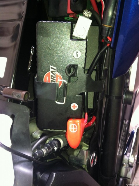

The OEM battery on my 2007 has become weak.  After over 6 years of service I figured it was time to replace it.  I got the Shorai Lithium Iron Phosphate battery.  I read a lot of reviews on this new family of batteries so went in it with eyes wide open.  Since I don't live in a cold climate and I don't leave the bike in the open overnight, any cold start issues should not be a common occurrence.
Here is the new battery.  It's amazingly light and much smaller than the lead acid battery it is replacing.

  Shorai knows their batteries are smaller than the lead acids they will be replacing.  So they provide the buyer with a bunch of pre-cut pads so the owner can "pad" the OEM battery box in order to fit the new battery into the box without it moving around.  I did have to trim a couple of pads so it looks neater when the pads installed. [image: VFR Battery Box padding]
Because the Li battery was significantly smaller than the OEM battery, I had to pad the battery box to "fit" the new battery.
Here is the battery installed.  Check out the nearly 1" of clearance to the side of the box!  I only installed the pads on that side down below about half the height of the battery.  Don't worry I straightened out the negative connector so it's not crooked like that.
Shorai Battery Installed
Installation complete
Now the VFR spins right up and starts quick!  I think it handles better too since I must have dropped 5 pounds!  I keed.  I really couldn't tell the difference in handling.  The test is going to be if/when I ever have to start in cold weather.  Shorai recommends "warming" up a cold battery by putting the ignition to ON with headlights on for about 30 seconds in very cold weather.
