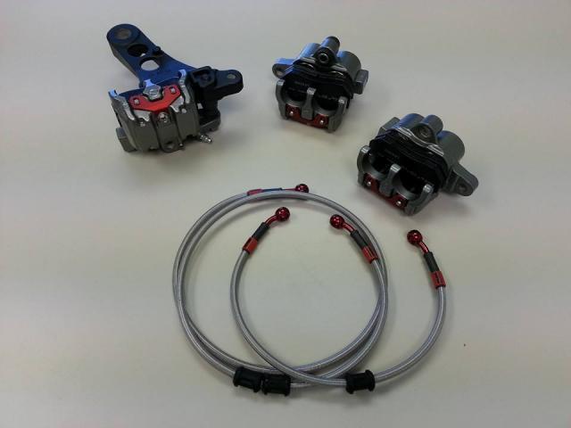

Here is the list of parts coming in so far.
New Hagon Rear shock - New brake pads - Core Moto Braided Clutch and Brake lines - Supersprox rear sprocket, RK gold chain -

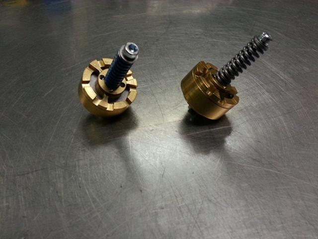

Race Tech Gold valve emulators - New fork seals - Front and rear wheel bearing set - Front & Rear caliper seal kits -Front & Rear Master cylinder rebuild kit - Front Master cylinder site glass replacement -
The calipers are getting powdercoated, the wheels and mufflers will also be powdercoated. Oiler mod will be installed...and I'm sure there will be more stuff that pops up along the way. Oh and a new decal kit will go on then a fresh paint job...

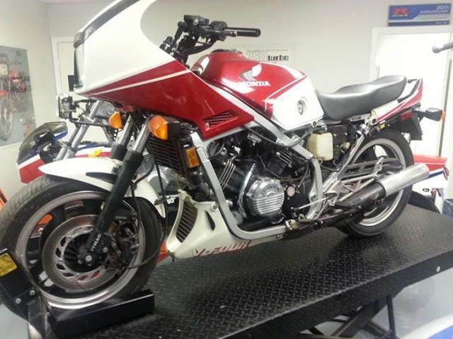

Here is her "before" picture.
If there is any interest, I will post more as they come in.
always pictures. ;)
Welcome into the limelight lurker!
That beauty will take centre stage!!! :beer:

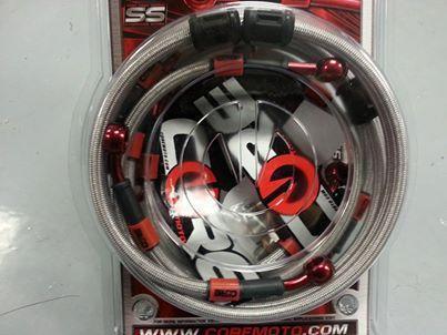

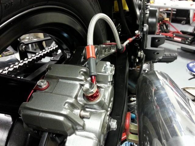

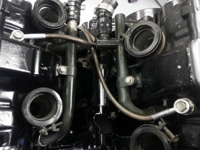

post-22116-0-24969400-1398910403.jpgNew braided steel brake lines
Always a great idea to upgrade brakes in my opinion. Never money thrown away.

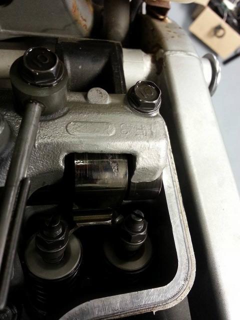

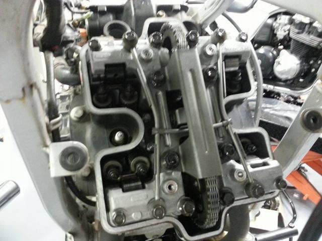

cam issues.jpgThe infamous cam issues have bit me.
Nooooooooooooooooooooooooooo!!!!!! :mad:

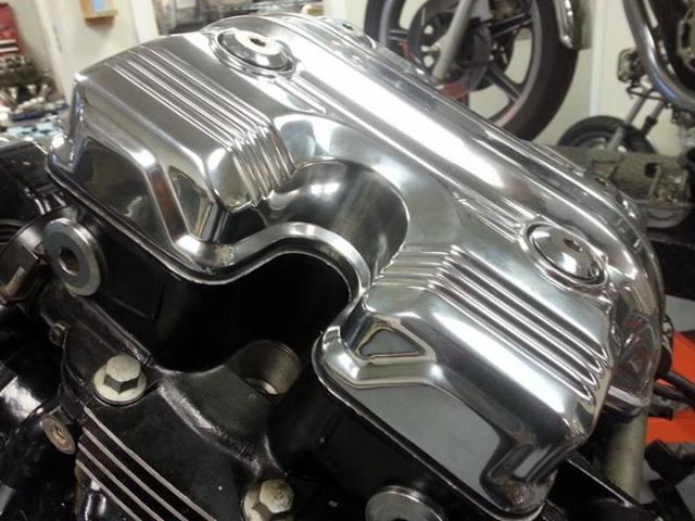

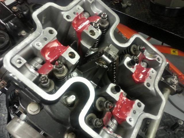

valve cover shot 2.jpgThe cams are being rebuilt by Mega Cycles out of California. That and the oiler mod should keep the bike going for a long time. While its a bummer, it was not completely unexpected. More pics will be posted as I get them.
Way to stay with it. It's worth it!
Weld and grind on the cams? Thought I read something about having the pad on the rocker done as well.
Glad to see you are having it taken care of.
It will always be in the back of your mind .
It's a dam shame !!!!

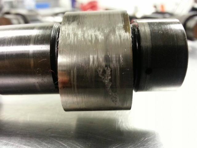

Up close on the Cam.jpgBack end torn down.jpgUp close of the dreaded cams

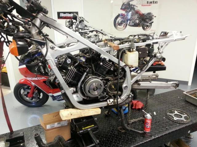

On to other things while the cams are off to be rebuilt. Joe has started on the back end tear down

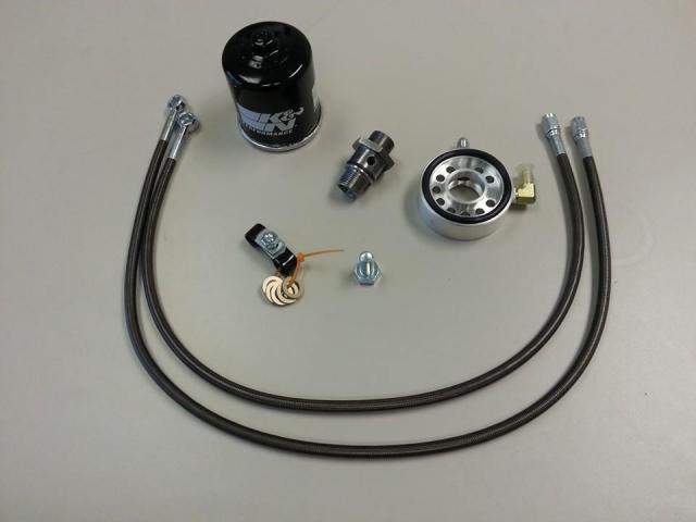

Oiler mod.jpgThe oiler mod that is getting ready to go on.

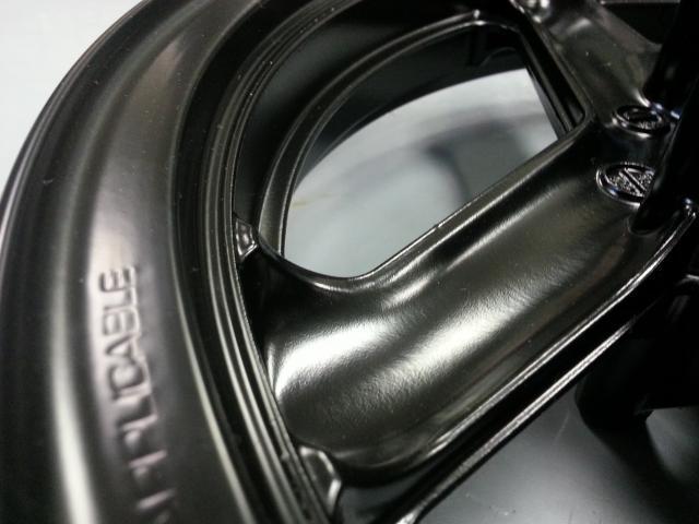

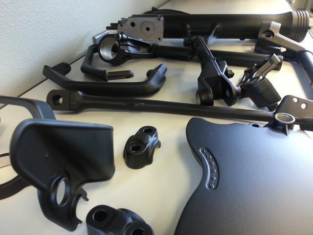

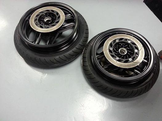

Up close picture of the satin black powder coating on the wheels. We decided to go with satin black on the frame to match the wheels.
More parts back from the powder coating place.
I think the black should look great on the frame. Something I want to do when I finally tear mine apart for a proper resto/mod.
The before pic looked pretty sweet! :beer:
Looking good.

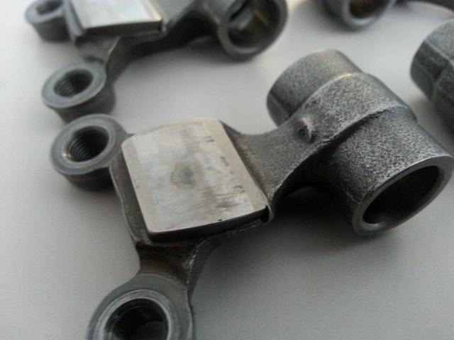

rockers - before shot.jpgA before shot of the rockers. They are off to Mega Cycle for a rebuild.
Hats off! Doing it right, looks like.

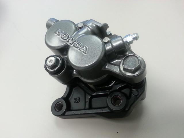

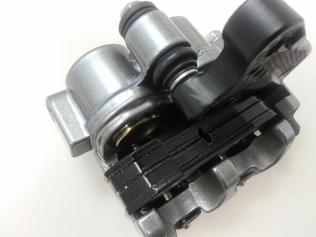

Calipers 1.jpgCalipers 2.jpgGray powder coat on the calipers with ceramic brake pads.
I would've done the frame and swingarm the same color as the calipers, but looking awesome

I appreciate the comments. It was a harder decision than I thought...but in the end I decided to go with a different color for the calipers to set them off a bit.

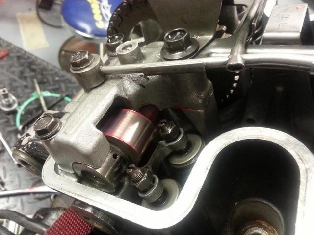

Cams going in.jpgCams going in 2.jpgRebuilt cams going back in

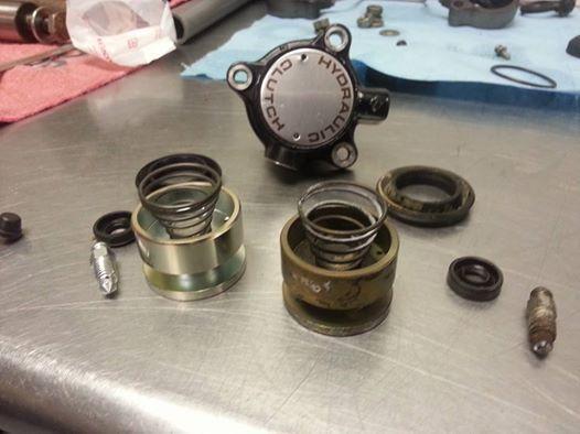

Clutch SLave Cylinder.jpgVF750f new rubber.jpgThe wheels are ready for their new rubber and a new slave cylinder is being installed.
Looks great! Is that a satin finish on the wheels?
VF1000RS
Thanks...and yes...it is satin...frame is being powder coated and will match the wheels...

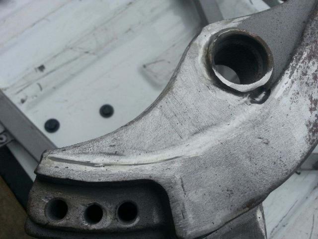

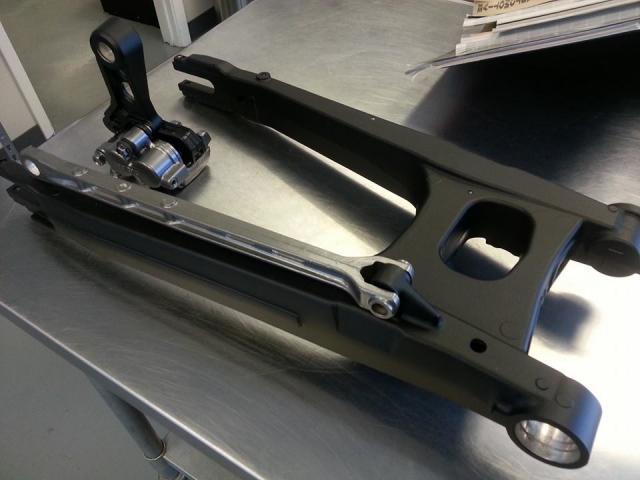

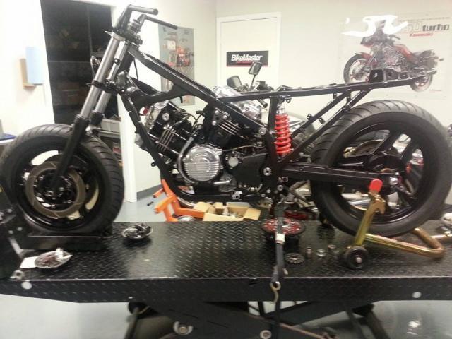

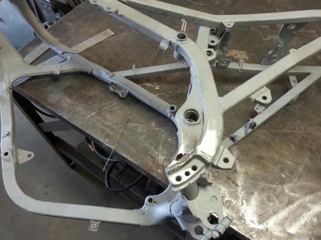

20140702_095807.jpg20140702_094902.jpgThe "makeover" has morphed in to a restoration. We hit a snag on the frame. After blasting, a hole was found in the frame that appeared to be caused by rust. Here are the pics before the frame was sent to the welder.
20140718_121227.jpgAnd the after pic...it will be hard to tell after powdercoating

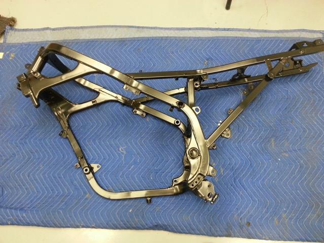

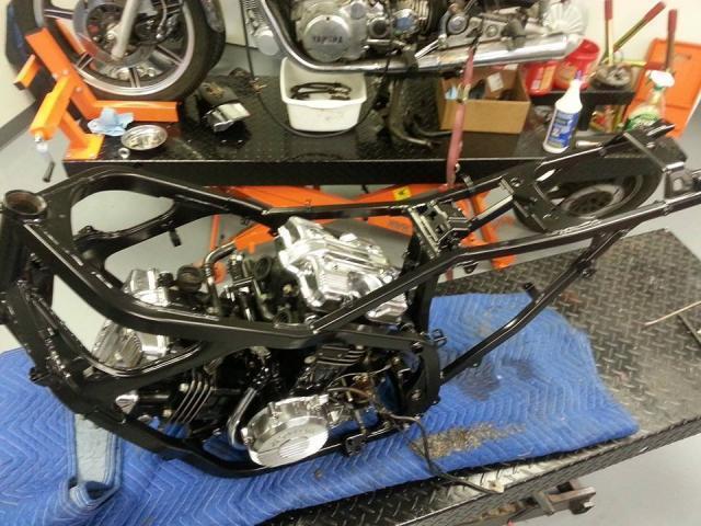

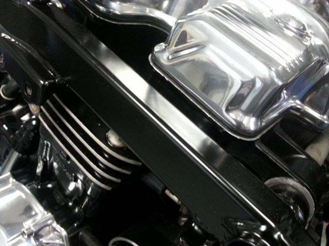

Here's the frame powder coated in Satin Black.

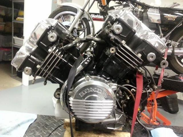

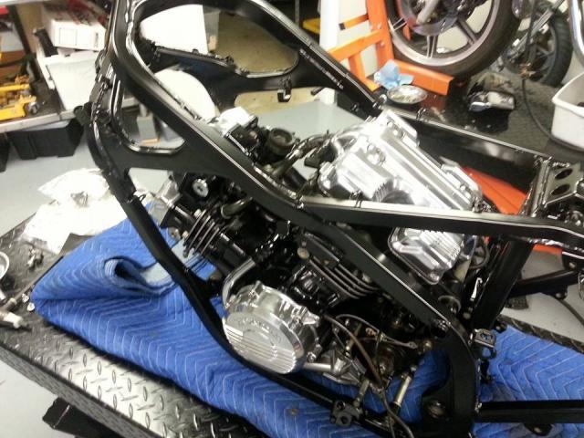

Engine back together.jpgEngine back together 2.jpgSome additional pics of the engine after polishing the valve covers.

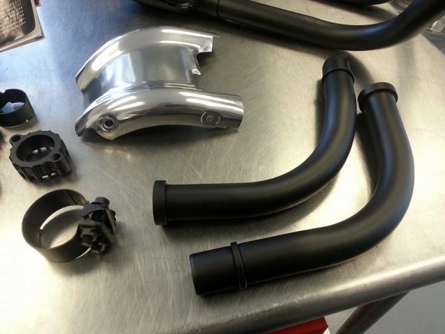

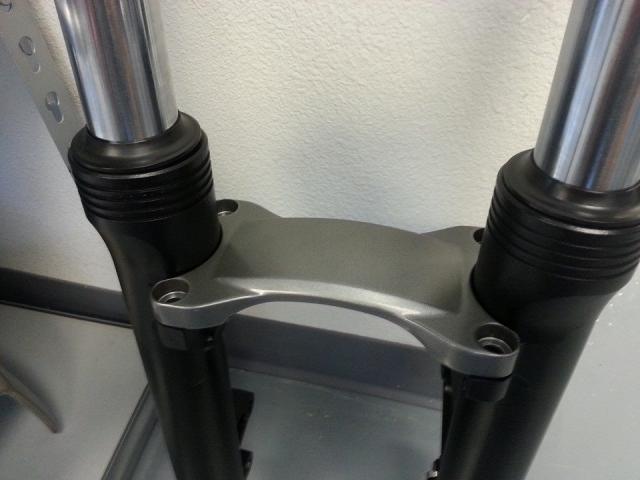

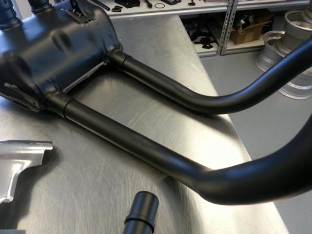

Front Fork Brace.jpgHeat Shield in Ceramic silver powdercoat.jpgmore exhaust parts.jpgmuffler.jpgSwingarm.jpgSome additional pics of assorted parts

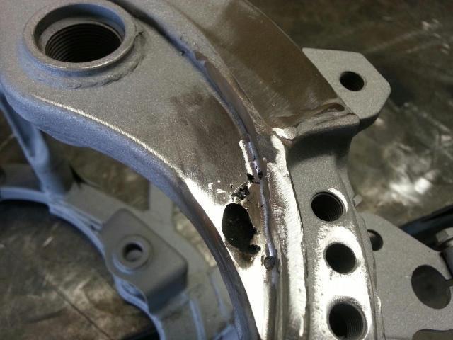

Looking good. Nice save on the frame. I've seen them fairly swollen in that spot from water sitting in there and freezing, ballooning the metal out.
Kel
Thanks...I was unaware that this could be a problem. I was glad to not have to get a replacement frame.

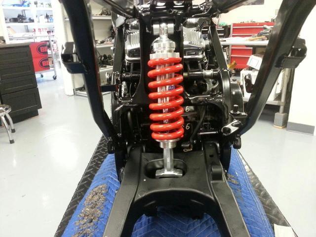

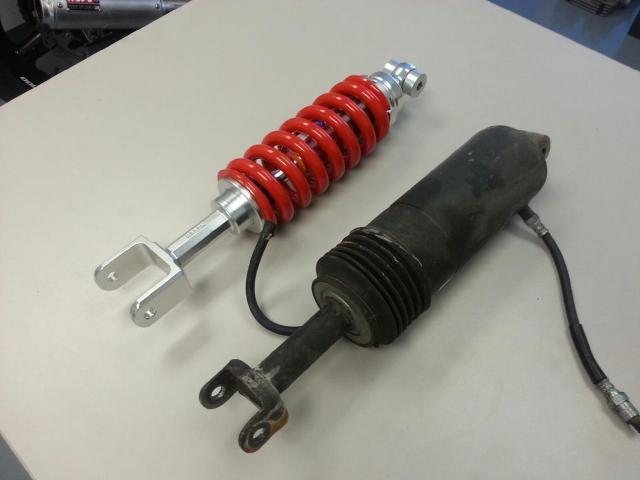

20140828_105326.jpg20140828_112858.jpgOut with the old....in with the new...(Hagon shock)
bswiles
Tasty!
It's a shame that that beautiful shock will be out of sight when the bike is all back together. Total eye candy!
tomk1960
I agree Tom...But I'm looking forward to the improved handling.
I learned about this frame rusting problem in the early nineties when I ran an '85 VF700F. I read somewhere that Honda recommended drilling a small drain hole at the bottom of the frame. I recall this issue effected the 83's and 84's only..
You are doing a great job, I'm keen to learn about the shock performance over the (old) old pneumatic OEM shock.
Greaterx
bswiles
Back when it was ridden everyday, it was a bit slushy in the corners. I'm sure it will be an improvement but I will let you know after its finished.

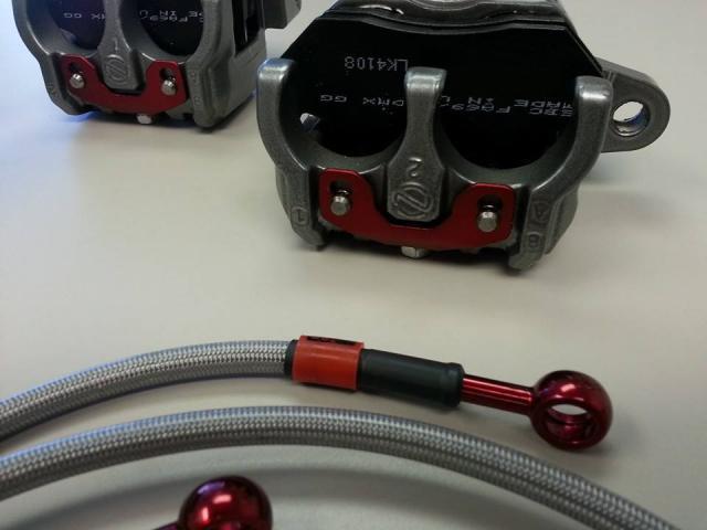

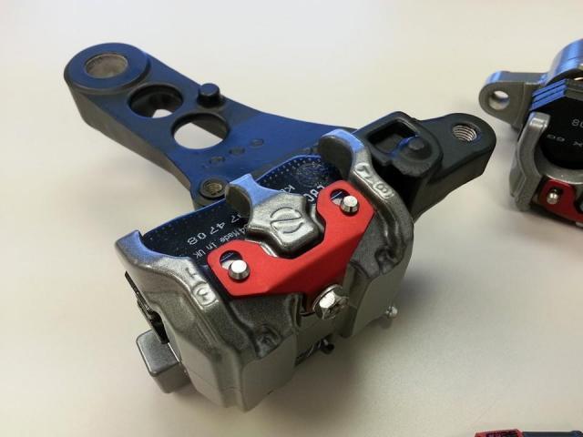

A little red (anodized looking) detail to the calipers...
I like the candy red highlights. Your bike is going to look a lot nicer than it did when it was new.

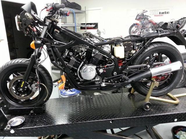

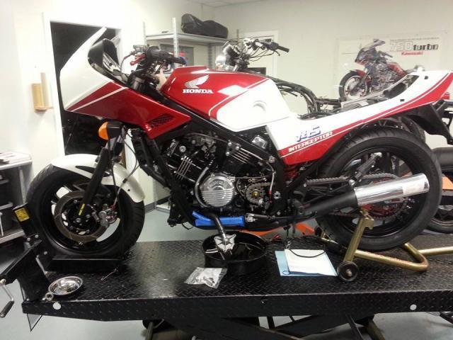

Roller.jpgIt is officially a roller.
1st image that came to mind.......

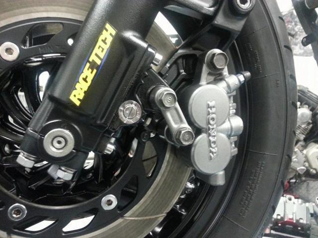

Front brakes.jpgThe front brakes are going back together.
It looks awesome.

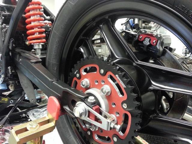

rear sprocket.jpgrear sprocket.jpgNew rear sprocket is on.
You have got to be kidding! Nicest Intercepter ever.
bswiles, damn fine work. Your Interceptor is gonna turn many heads!
Lots of attention to detail, but one question...is there paint on the swingarm dropout surface where the rear axle tightens the chain adjusters? I have always seen that area as bare aluminum, assuming that it would prevent any slipping.
The bolt at the end prevents slipping. The surface should only see movement during adjustment.
vfrAustin
vfrAustin, under acceleration I can see the net force on the axle being towards the front of the bike (which would be stopped by the adjusting bolt).
Under braking the net force would be towards the rear of the bike, where the adjusting bolt would simply be goin' along for the ride.

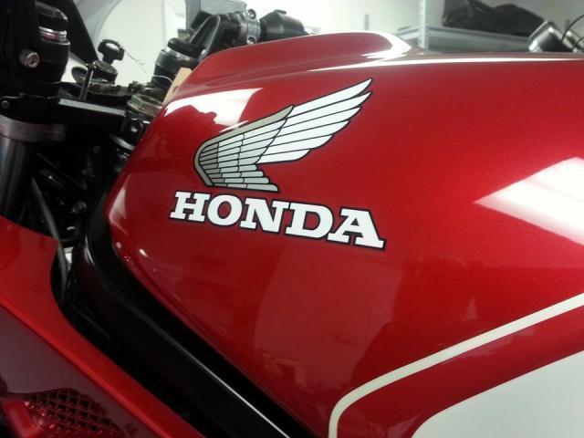

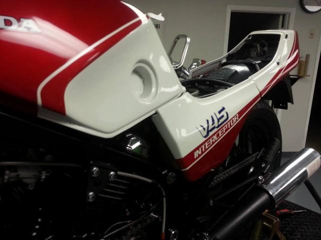

16212_799477810120960_7116795119227623867_n.jpgThe latest from Joes's shop...The paint is completed. He hit a snag on the water pump and had to order a replacement pump and seal. She's getting closer.
1782176_799525273449547_5830734042244502570_n.jpg10686895_799525230116218_5248542219250711745_n.jpg10930101_799525296782878_2891017227328076734_n.jpgMore shiny stuff...
Wow. Wow again! That paint job is gorgeous. I agree that it's going to be nicer than when it was new.
Wow one more time!
That has to be the luckiest 83 VF750F on the planet. Amazing. Nice work.

then I noticed something in this picture.
Maybe the wheel is just temporarily on, but the fork axle clamps seem not to be secured correctly/safely. For the VF1000F forks, with two stud clamps, the factory manual states to torque to spec the front nut first (13-18 ft-lb). Then torque the rear nut to same spec, but will have a gap left. I seem to see a gap on the front nut in the photo.
Of course, this pic may have been a temporary mounting and not 'ready to ride' state, and that case, please ignore. But I thought I might mention incase it is useful for you or others, with a similar axle clamp set-up.
By the way. More photos of the finished bike, please.
Thanks Sparrow and good eye...The guy that commented after your post is the guy that did the work. All of the credit goes to him and his shop, VJMoto.com

One, is my skill set is not this advanced. I can take parts off, clean them, paint them maybe even powder coat them and put them back on...but some of this stuff was over my head. Needless to say I am very much impressed by those of you that can do your own deep mechanical work, fabrication, trouble shooting and so on. I simply know my limitations.....
Second; I have a garage full of projects. I needed someone that could see this thing through from start to finish and not get bogged down. I knew that if I tore this thing down my self, it would sit way too long waiting for me to finish something else. Having it at Joe's shop allowed me to see it progress. I am very happy with the way it turned out.
hit a few snags along the way. (Dreaded cams and a hole in the frame) but it was not anything that his shop couldn't overcome.
I will post a few more pictures of the finished product and probably a shot or two from the IMS show this weekend. I spoke to Joe a few hours ago. There a re a few things internally that still need to be buttoned up. One is a spark issue on 2 of the cylinders. Cheers...

[image: IMG_0459 (2).jpg]Here is a pic from the IMS show last weekend and this should be the last post. She was up on a pedestal and drew a lot of admirers. Thanks for all of the kind words and encouragement.

bswilesHere's the frame powder coated in Satin Black.
imageproxy.php?img=%257BfileStore.core_Attachment%257D%2Fmonthly_08_2014%2Fpost-22116-0-00407300-1408215474.jpg&key=c66f52986b114b1879d80cb72e1018f6e2030e1465535ecc0277d701cff884bb
Would love to see this pic if you still have it....

bswiles 20140828_105326.jpg20140828_112858.jpgOut with the old....in with the new...(Hagon shock)
imageproxy.php?img=%257BfileStore.core_Attachment%257D%2Fmonthly_08_2014%2Fpost-22116-0-67037900-1409273577.jpg&key=dc0d02bfc2256d0657817a1862f603c30c27be98e44cd8adf8401507bbf3ef9b
imageproxy.php?img=%257BfileStore.core_Attachment%257D%2Fmonthly_08_2014%2Fpost-22116-0-96522100-1409273679.jpg&key=2b2605ef8156b36d280cf4a7354e12ba1b42369e3abe91fcb633ab0a62c6a8fe

I went back and added the pictures. They are a bit misleading as the flash made the frame look almost gold. The frame is the same as the wheels. It's a satin black...not too dull not too shiny. Let me know if you want any close ups of any parts and I will post more. (She's going to be ridden this weekend) Best of luck on your bike. I'm glad you are showing her the love.

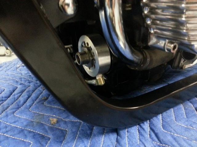

bswilesThanks...it should be good for a few more miles...hopefully the oiler mod will extend the life.
What does the oiler mod do for the bike ?? Is it getting more/ better oil flow to the cams ??
Sent from my iPad using Tapatalk
The theory is more volume and potentially cleaner oil to the cams.
I am curious where that kit was purchased from?
bswiles, read through most of your thread, once again 'fine job's, noticed that you mentioned a firing issue on the front bank, it was dated back in the thread a bit, but just thought I'd mention something I found on another forum (not a member, just follow), I have since received my two and then found out you can run Coil on Plugs, very interesting read and research on his website.
v4spark.com

v4spark.com
Can be used for 500's, 750's and 1000's you just have to order specifically for your bike, USB programmable too.
[image: 87116839b60e5467565b10e13c7b2351.jpg]
I'm pretty sure mine came from V4market.com - which has since closed. I did a lot of research on this issue and read a lot of stuff on here and the rest of the internet. There are arguments for and against. Many folks think that the sole cause of the cam problems is the metal used in manufacturing. Others think it is an "lubrication" issue. Still others feel it is a combination of both. I felt there was little harm in doing the mod...and with newly rebuilt (and expensive) cams - I felt it was cheap insurance.

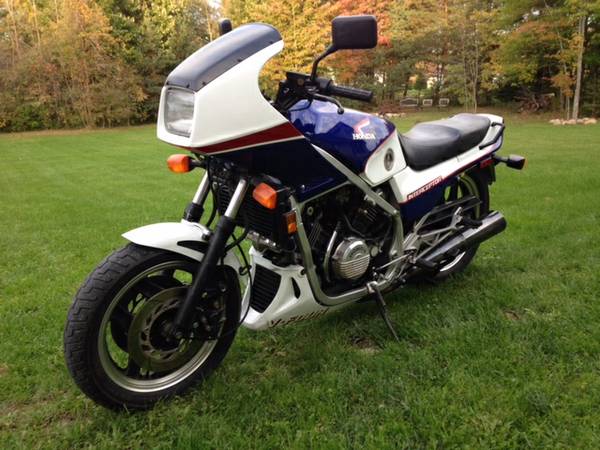

bswilesNew braided steel brake lines
imageproxy.php?img=%257BfileStore.core_Attachment%257D%2Fmonthly_05_2014%2Fpost-22116-0-24969400-1398910403.jpg&key=5a88bfce39ae7d42ca7f54dc8977cc56fedd28c2b15d48327ed234360edaab51
Can you post the pictures of the brake lines please ??

bswiles post-22116-0-67037900-1409273577.jpgpost-22116-0-96522100-1409273679.jpgOut with the old....in with the new...(Hagon shock)
Has this shock made a big difference in how the bike rides ?? It looks awesome, but it's an expensive switch, isn't it ??

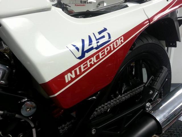

Would like to know where you got your decals ?? I've got a guy that does paint where I live, but I'll need the right decals for my bike (color scheme is basically the same as yours, red/ black....
