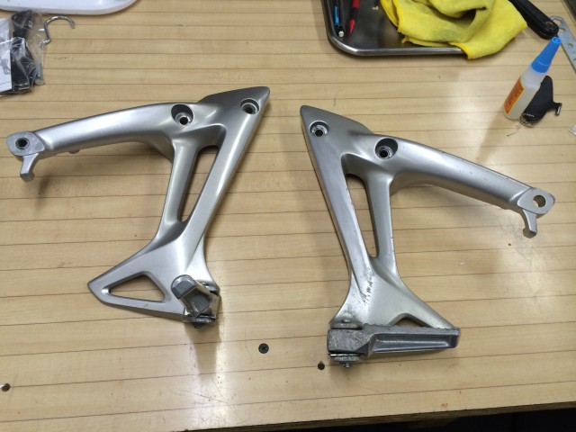

One of the only things missing when I found my '06 was the passenger foot peg assemblies.  Since my wife may occasionally ride along I needed to replace them.  I checked on OEM factory pieces and found that by the time I bought everything required I would be almost $250.  So I decided to go the junk yard route.  I found the pieces on ebay and by the time i had them in hand I had invested just over $100.  The downside is this is what they looked like
IMG 1217
IMG 1217

I bought this kit at O'Reilly's for $17.
[image: IMG 1223]
IMG 1223
Then I got to work with a die grinder and surface prep pads.  They are like souped up Scotchbrite pads.  I removed as much of the surface imperfections as possible.  There were a couple of dings that were too deep to completely take out since I would have had to really take a lot of material .  After cleaning it up I did a final prep with a medium Scotchbrite pad and wiped them down with alcohol to really get them clean.

Finally I painted them in multiple light coats and finished them with a couple of clear coats.   All in all they turned out really well.  The color of the HyperSilver has a very slight "blue" tint that may not be a concours match but it works well enough for my needs.
