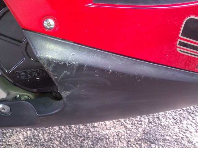

I think I am going to replace the few imperfect parts on this ( top triple has scratches from a key chain, the right black lower has scratches,and some middle square thing on the tail piece) and make this bike look like new.

I am thinking of doing a china carbon fiber vinyl wrap on the right and left lowers. Not sure how well it will hold up to the heat though.
I have 3M clear vinyl on both lower cowls on my 5th gen and they hold up to the heat fine, so I doubt you'd have an issue if you wrap the lower and mid cowls on your 4th gen.
Hey thanks. I will do carbon fiber wrap from China. Unless you really think 3m will be the best choice.

Never tried the carbon fibre wrap from China, but, if I were to offer a suggestion, most of the other stuff for bikes that seems to come from China appears to get less than stellar reviews. Might want to try a local company that sells something similar. Having tried to help a friend install some vinyl graphics on his bike a while back, my suggestion would be that a hair dryer is your best friend. The wrap is really hard to form around inside corners and curves without really distorting the pattern on the film. Try getting some sheet stock in a cheap color, clear or whatever and practise a bit with putting on the film on around compound curves. Once you are comfortable, THEN go to work on your bike parts. Will likely save you hours of frustration and a bit of cash at the same time.
