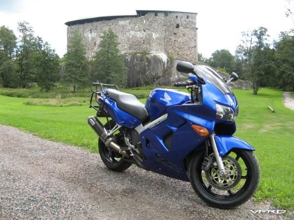

I have Fivestar rack for my 5th gen that fits Givi/Kappa case
