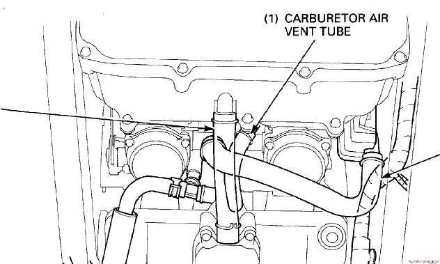

Now a question:  This "Carburetor Air Vent Tube" exits from the rear carbs and its other end is open to the atmosphere.  Is this how it should be?  Will it suck crap into the intake?  Should I plug it?

leave it alone. it doesnt suck anything.. its a  air pressure differential tube.  :fing02:
 one of them anyway..
 if your bike is still idling rough you need to make sure the pilot jets are clean again..

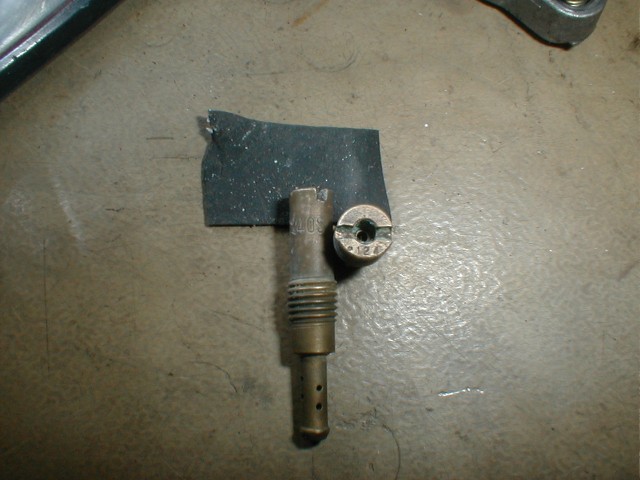

And of course, another question...  are these the stock carb jets?

Don't forget a fresh filter on that damn secondary air breather thingamabob.
