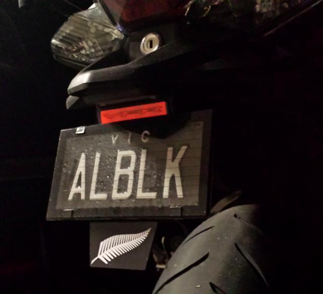

Finally got around to ditching the chunky factory numberplate mount this weekend. Holding things up was my desire to fit an Altrex numberplate cover as well as a tail-tidy, and get a clean, compact result. The plastic clips for the Altrex clamp to the back of the numberplate along the top and bottom edges - which is a problem since the space along the top edge is also where the tail-tidy arms go. Tightening the numberplate fasteners would've then bent the numberplate.
To solve the issue I got out the angle-grinder and made an 8mm x 8mm notch on the upper edge of each arm, giving the clips a slot to fit into but still letting the numberplate sit flush against the tail-tidy. I used the "Mk.2 Long" prototype that preceded the production tail-tidies (just in case I bollocks'd it up!), and I'm pretty pleased with the result.
Not the greatest photo, granted... It was taken on my phone in poor lighting, but you get the idea:
Some time ago I also replaced the stock numberplate light globe with an LED equivalent, albeit one that puts out a cleaner, brighter light. It's a bit of a farkle I grant you, but combined with the tail-tidy and the reflector, it looks the business.
