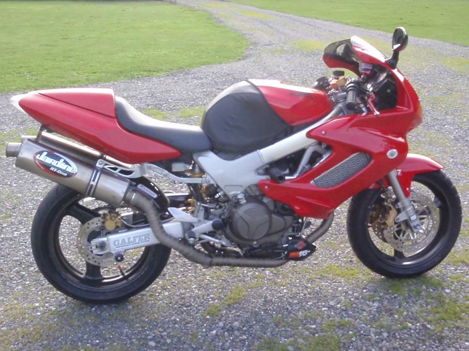

It's amazing what a little exhaust wrap will do  :491: gallery_31912_7561_22251.jpg
That's a thought, but doesn't it hold the moisture in and rust the pipes too? At least that's what I've read. What's your experience been?
