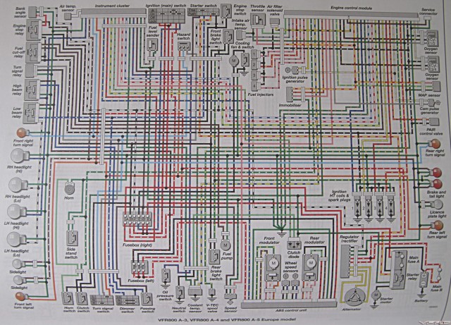

Use  this  drawing  to  troubleshoot  with .  I  would  start  at  the  fuel  pump  relay  and  work  backwards checking  voltage  with  the  start switch  held  in .
2008HondaVFR
2008HondaVFR
2008  wiring diag.

haha, looks like the schematic from the haynes manual.
