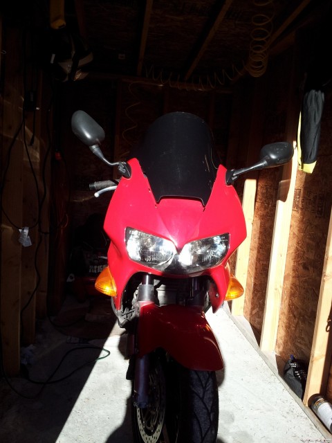

So here she is! A 1999 VFR 800, 28xxx miles. Been down twice, once at 50, and once at 80 on the highway. Fella lived to tell about it too. Story goes he adapted a baby and his Finace wanted bike gone for obvious reason. Anyways, I ride it around a parking lot, it started and drives straight, looks straight. Seems to be fine. It needs everything done though. Fluids, filters, oil, lights, all the plastics, and so on. The tail light, the gauges, and the gas tank are about the only things that are salvageable.
Oh the title is clean too. Never went to the insurance company when he wrecked.
Oh yeah, Sargent seat and Erion slip on came on it too. Exhaust sounds nice!
All this fun for only 1000$!
And yes, she will be a Tmac, but... May not be much to look at.

Pulled the fairings, mirrors and windscreen off today. As you can see the left side radiator has a little, uhhhh, wear and tear. But she doesn't overheat and it doesn't leak. Fairing mounting brackets are bent and broken, but that was expected. The left side fairing was attached entirely with zip ties.
Tomorrow I'll be pulling the nose cowl, the headers and exhaust. Sandblasting the headers and powder coating them high temp black, and I'll probably strip the Erion pipe down and re powder it as well. Not exactly sure yet. I've got a buddy who has a buddy with a CNC machine so I'm thinking about removing the Erion racing label and getting a plate cut out with the VFR logo in the font similar to the sticker on the fairing, then attaching it back to the muffler. I'm also gonna pull the wheels off and polish them back up and clean the black section up as well.
If I have time I may start draining and flushing fluids and do the oil as well.
