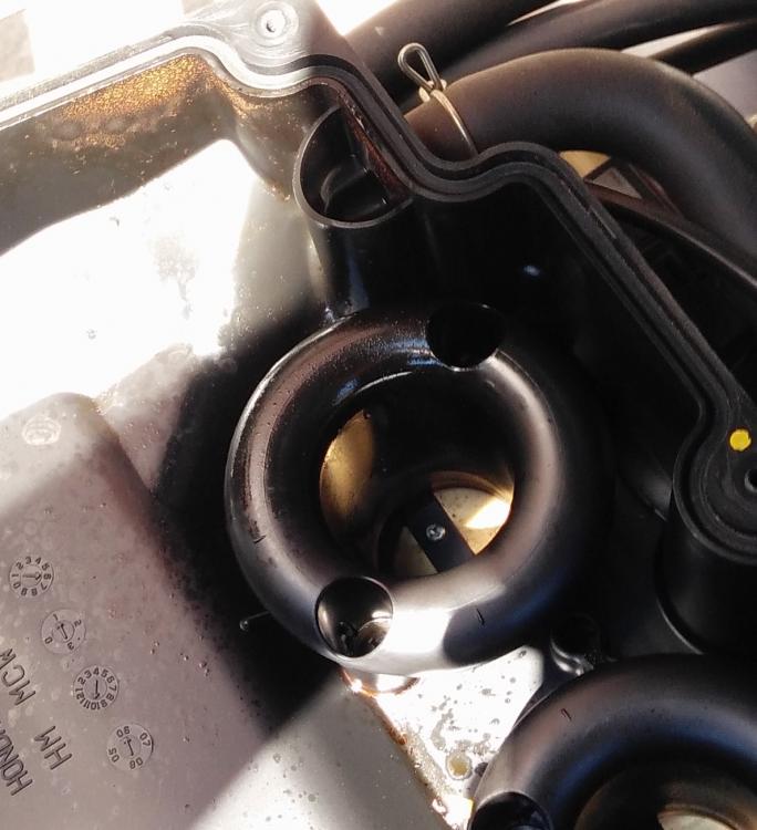

As the title said, I've got oil comming from a cylinder by the air intake. It is from the rear-right cylinder. My bike only have 33 000km, I've bought the bike this winter so havent look at that.
I don't exactly know when was the last oil change, I'll do it the week. The oil level seems a bit high to me, on the sidestand, it's about a 1/4 more than the max level. Can that be the only reason? (I suppose "no" is the answer)
I've done 200km before looking at it, most of that, at low temperature (near zero) and engine did not have plenty of time to get hot (I know I know... that's not good but I didn't have other choice). I'll look at it again tomorrow to see if there is more oil spill in the air filter since I've done 400km today.
Is this something that appen often on those bike? What can I do to correct that?
I know I must change the air filter since it's full of oil... what am I better to buy?

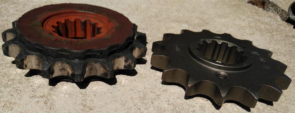

Other question just to be sure. Is it normal that between a 16t and 15t sprocket there is so much a big difference for tooth size?

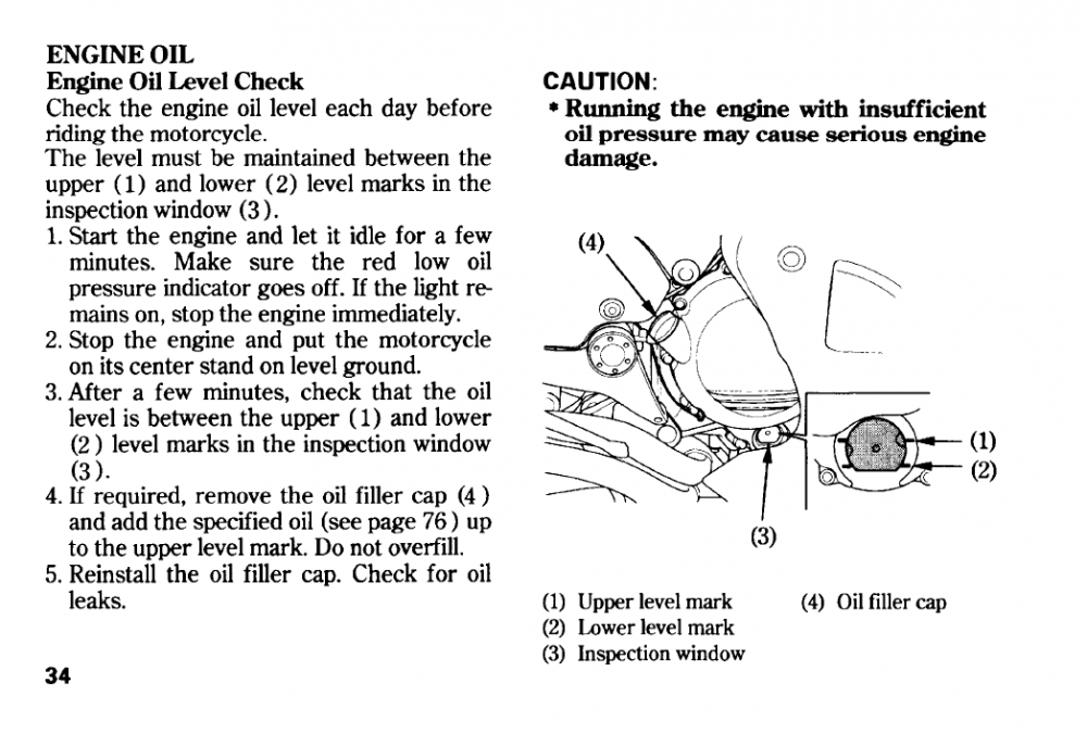

Don't check the oil level on the sidestand, the bike has to be on the centrestand. Leave the bike to sit for a few minutes to allow oil to drain back from the cams etc before checking.

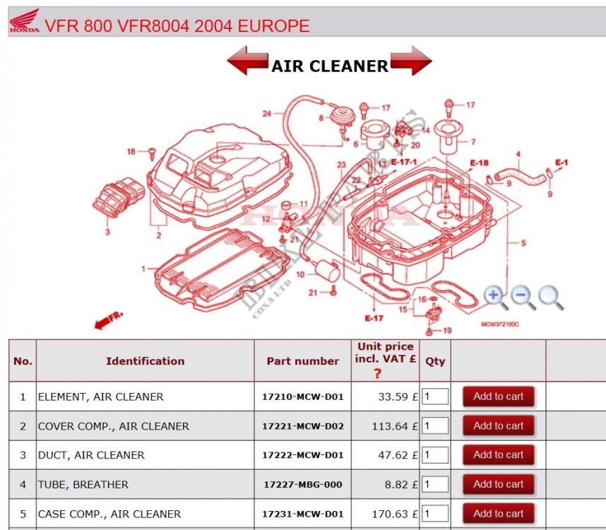

Rather than "oil coming from every cylinder" I reckon the oil mist comes from the breather tube that flows into the airbox.
http://www.bike-parts-honda.com/pieces-honda-detail-4853-13MCW2E1-VFR8004-2004-F__2100-VFR+800.html
part #4

That hole next to the velocity stack is your crankcase breather, too much oil will make it come out of there.
Drain some out and you should be fine.

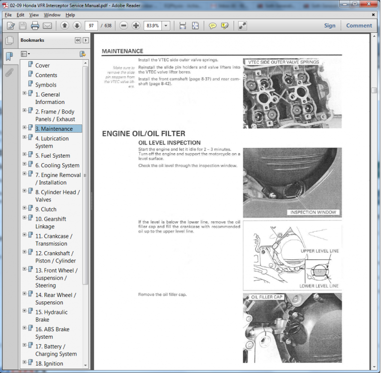

The manual says to check the oil after letting it idle for 2-3 minutes. No mention of waiting any amount of time.
My manual must be different to yours, slowbird:
How odd. Maybe the 6th gen model is different?
This is from the Shop manual I downloaded off this forum.
