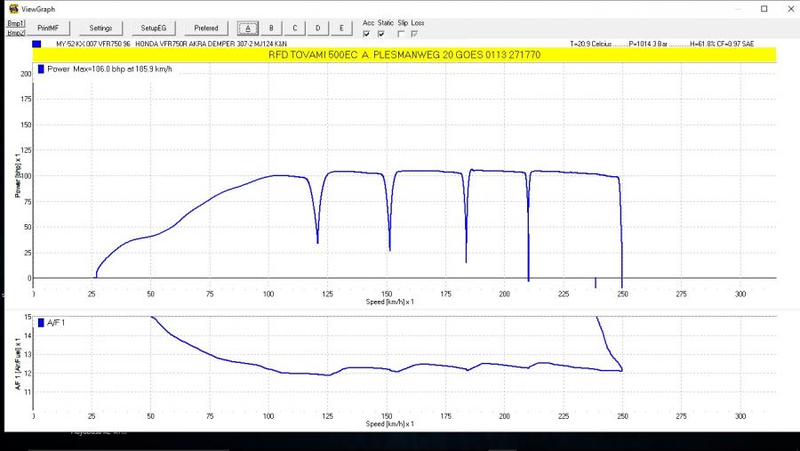

106, but dynos differ as do atmospheric and temperature conditions.

Awe back in the day my 4th gen was dialed in at 98Hp with a Stainetune with a KN at the time like 10 years ago, had it to get into the Jets,  but Mr. Valasco advised there's really only one trusted kit he would use, ;)  an HRC one. Might as well be looking for gold.  Since it was running real good,  we left things alone for the better.    We can talk about  about this tomorrow too.
Years ago, I simply had the Akrapovic fitted (with db-killer) and no re-jetting.
For redslut, I applied the "treat 'm mean, keep 'm keen" scenario; she had to work hard....
With some money to blow (and my 5k miles trip coming up) I took her to a dyno shop.
We agreed on a K&N (tbh, the paper filters are ok too...), and some work on the carbs (different springs, "307" needles whatever that means and mj/24 jets).
The one thing that stood out for me was the improved fuel consumption, some 10% better mileage
The new needles were the adjustable ones
[image: post-5787-0-10958700-1467279379.jpg]
Did she "need" all this work?  No, be it 95, 98, 100 or 106, the RC36 is powerful enough as is...
borrow a Carbtune (I bought one years ago) to sync your carbs and be done with it if you donot have cash to blow.
The shop checked sync with their jazzy tool and they were pretty close...

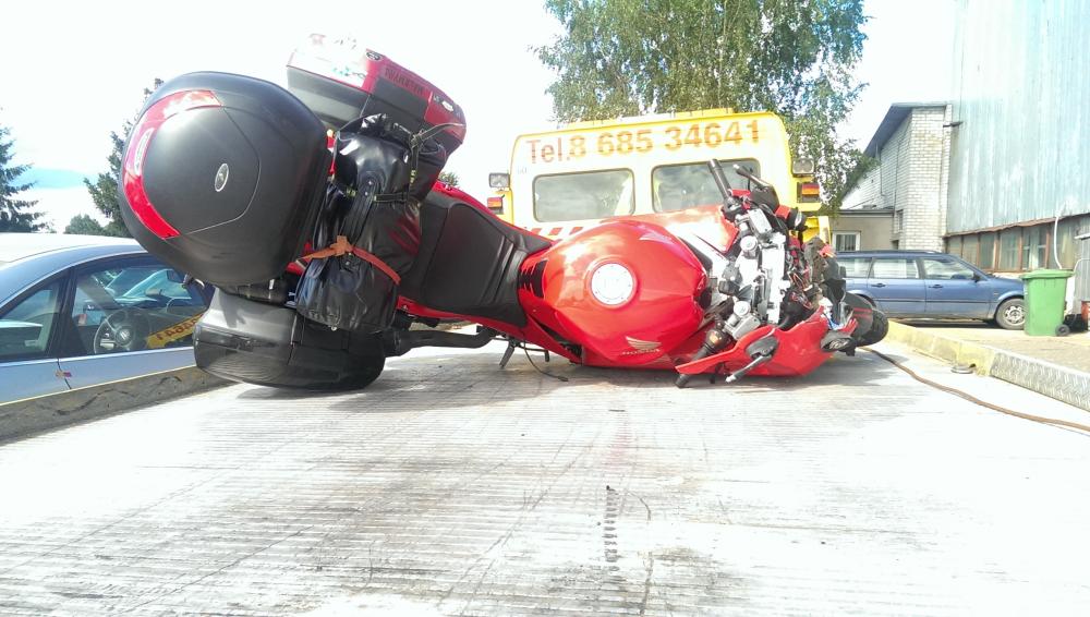

1st and foremost, invest in PROTECTIVE GEAR for yourself; one never knows when you need it to save your bacon...
Wow.. and Yikes,  this brings back  a sad day. ^  yes been there. smh. it only took 2 months before i was up and around again,  but at least I could.
Yes safety is key! I have full gear and a chest/back protector I wear under my jacket as well. I went through a field at 45 last year and walked away so I'm always sure to gear up for the worst!
