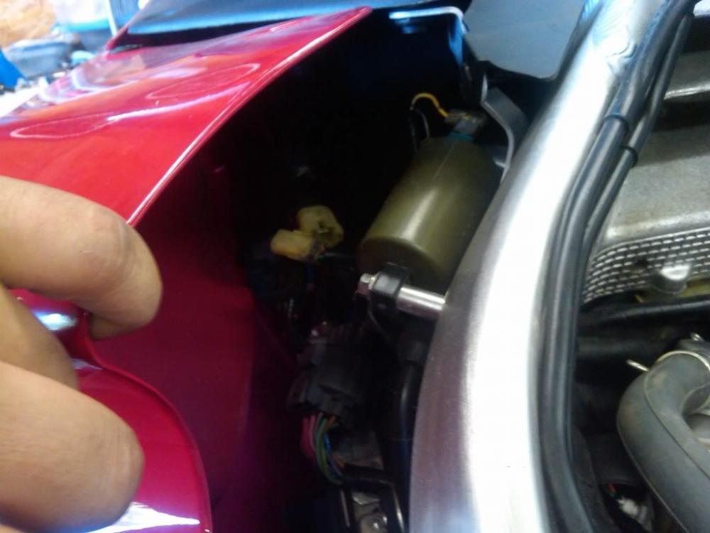

Just went back through the instructions I was following from THIS VFRW Thread. There is still one specific step that I'm still unsure about. Step 26 says: Remove the bolts from the left faring, enough to remove the PAIR electronic solenoid connection. I did this then taped up the half of the solenoid connection that was still on the bike. Is this what's throwing the code? Perhaps that connection IS NOT the one that disables the PAIR valve. Ugh!
From another thread I found: So what we want to do is to disable the PAIR valve altogether and the easiest way to do exactly this is to remove the cable controlling it! If you look on the right side of the bike under the very tank you just lifted, you will see cables and a connector like this. (I didn't remove this guy. Could that be the problem?)
[image: 3-pair_valve_connector.jpg]
You should see the PAIR valve solenoid near the back of the air box. Follow the wire that is connected to it and disconnect it and reconnect the one you disconnected earlier. It's easier to see/trace if you lift the gas tank.
If you have a leak at the block-off plates, it is very obvious due to the terrible sound that it makes.I assume that you have blanked/blocked off the large air port at the front of the airbox that feeds the PAIR system?
I doubt that the solenoid will play any part in this whether it is connected or not; I just disconnected mine and taped it out of the way. More likely you have missed a connector/hose somewhere. I left the vacuum hose off for the MAP sensor once and the bike told me pretty quickly via lame running and the FI light morse code.
