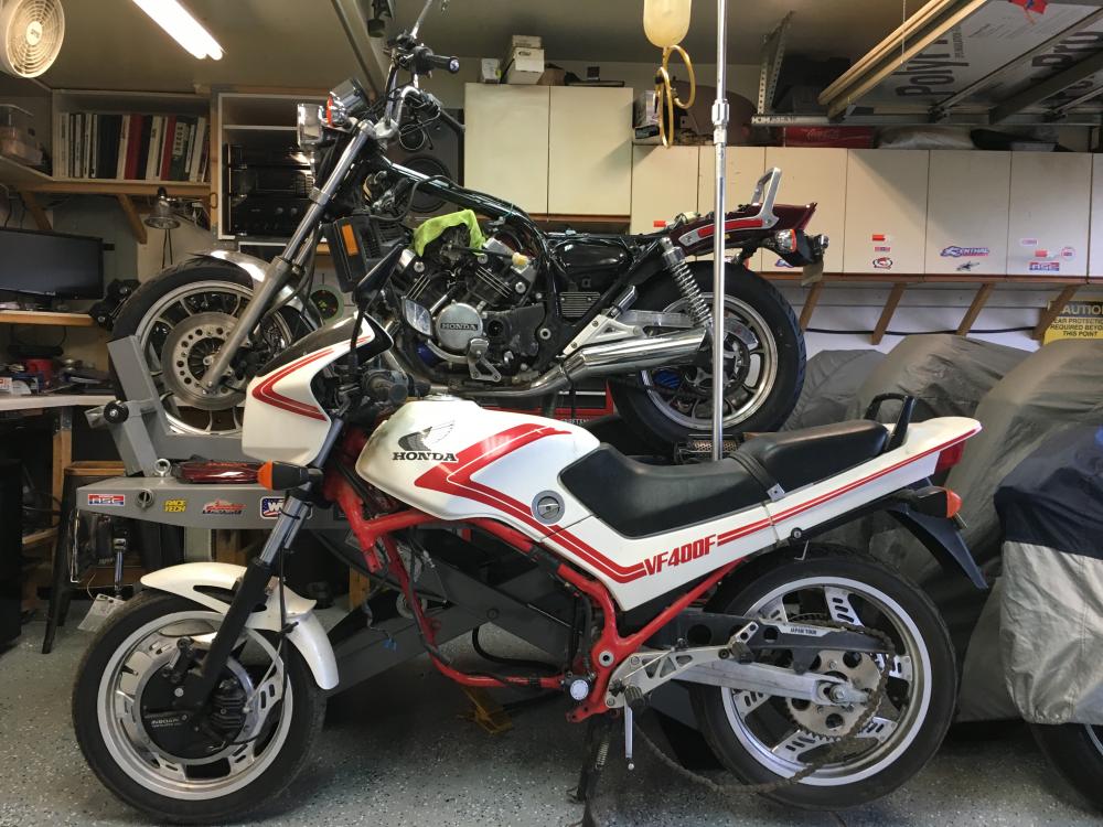

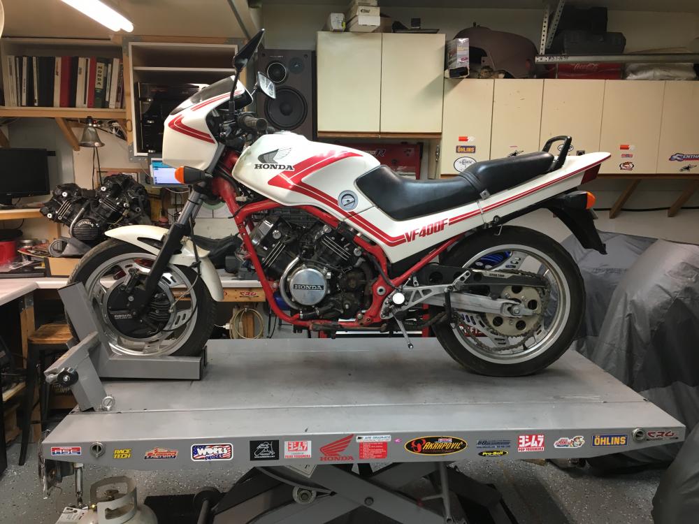

Long time since I've been here. Drove a bit Saturday to pick up this VF400F rolling chassis and this non-running V30 Magna. I spent Sunday going through the Magna to get it running.
We didn't get the VF400F here in the US so it's a bit of a rarity. This one is titled and I went to the DMV today to get the title in my name so I know there's nothing wrong there. The owner claimed it was _the_ VF400F  used in this Cycle Guide magazine. I don't know about that but I do know I have an interesting project on my hands...

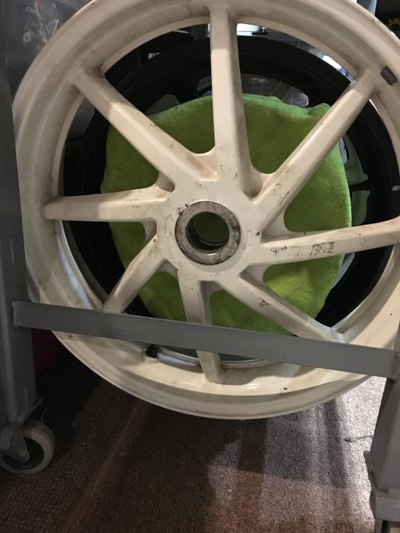

Then the fun begins. I am torn between keeping the stock wheels and something a bit different.

The inboard discs are probably not Hondas greatest achievement. They tried to ventilate as much as possible but I imagine heat still gets trapped. The rear on this bike is warped. Probably corrode pretty easily tucked in like the are also. I have some ideas though.

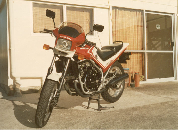

I look forward to watching the transplant. The pics below are of my second VF400F which was a Japanese domestic market model imported new by our local importer, which did not come with a standard chin spoiler, and also had a red light that came on above 100km/hr IIRC. My first one had the same graphics as yours but reversed so the main colour was burgundy and the stripe silver, with a silver frame.

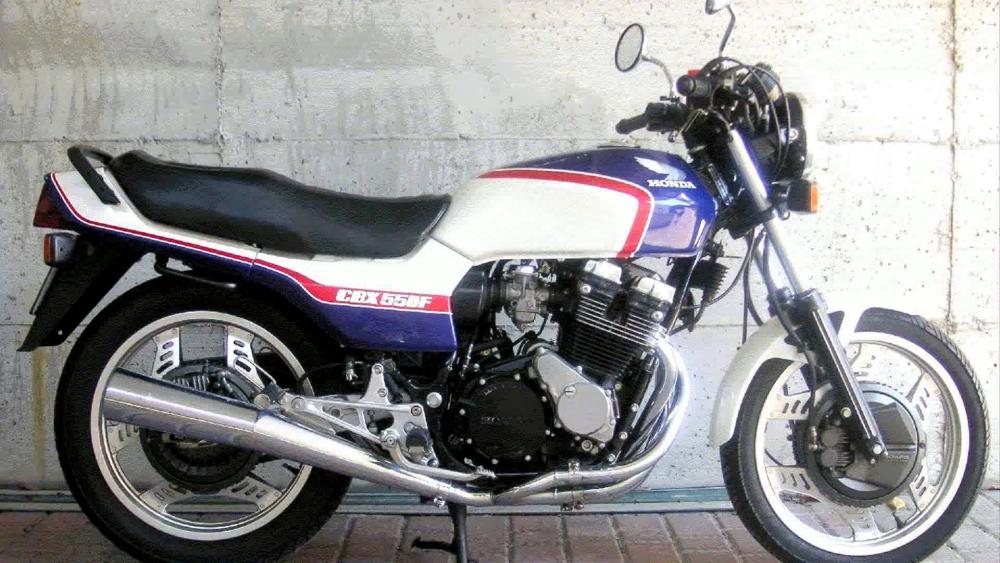

NS400, yes. CB-1, yes, CBX550F, yes, but  not the VF400

 I set these aside years ago with the plan for a 500 Interceptor, just add whatever front end I felt like at the time. I don't think I will use them on the little 400 and only show them as ideas I've considered. I want to do something different.
4 hours ago, Captain 80s
Correct-ish wheels but loses those damn inboard brakes.
Ya, darn!  While retro-cool and all, if I keep the stock inboards I have to replace at least the rear rotor as I'm sure it's warped.
Im thinking the 500F2 wheels would give me the mini retro-racer-hotrod look I'm thinking. Plus dual front discs are a plus. I like effective brakes. You can push further if you can stop.

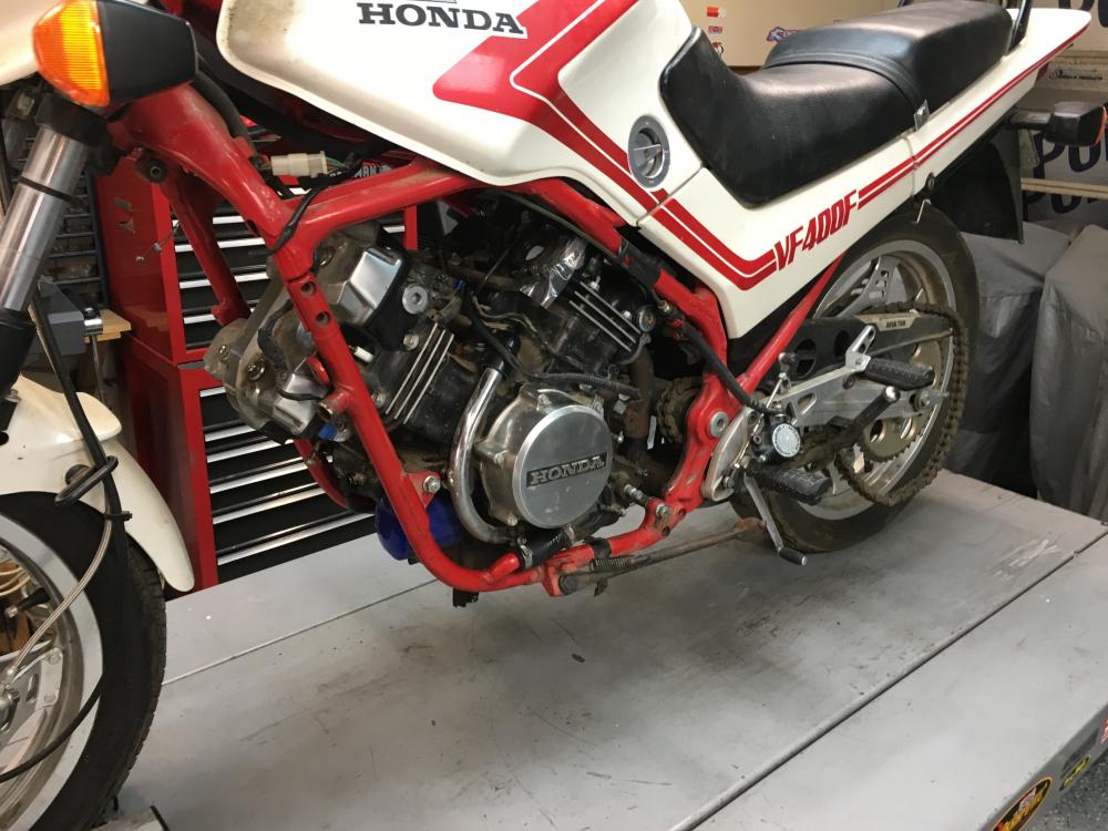

So there's luck. Like finding a non-imported VF400F with no engine and a Magna 500 with a 5000 mile engine in the same trip and bringing them home together. Then there's finding a NIB Hindle/Holeshot 4-1 header system made in the early 1980's and a nice condition Fox shock just across town from you luck.

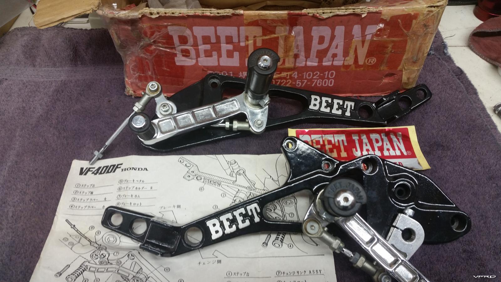

Holy shit.  Score.  I have a set of Beet (?) Rearsets for the 400 I got ions ago from Japan to adapt to a 500.
How in the hell did those things pop up in your area?

Did you use the rearsets on your 500? Post a picture?
There is a local guy I met a long time ago who was into 500's. He has three I think. He used to race them also. I gave him a call and he had exactly what I needed. And he was eager to let them go.

Haven't mounted them yet.  Planning on using them on my next 500 build.
large.VF400_Rearsets.jpg.ebcac599cbfaf2f
It looks like I can relocate/add one frame tab so they mount in the same location as the 500 brackets.  I have a full Yosh system for the 500 that I want the mounts to match the correct locations.  They are nice pieces, if not a little overbuilt.

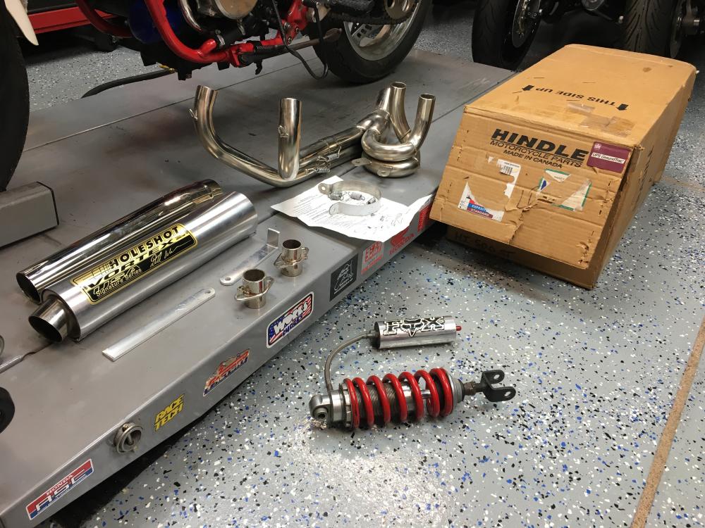

Full Yoshimura system for the 500 sounds pretty rare.

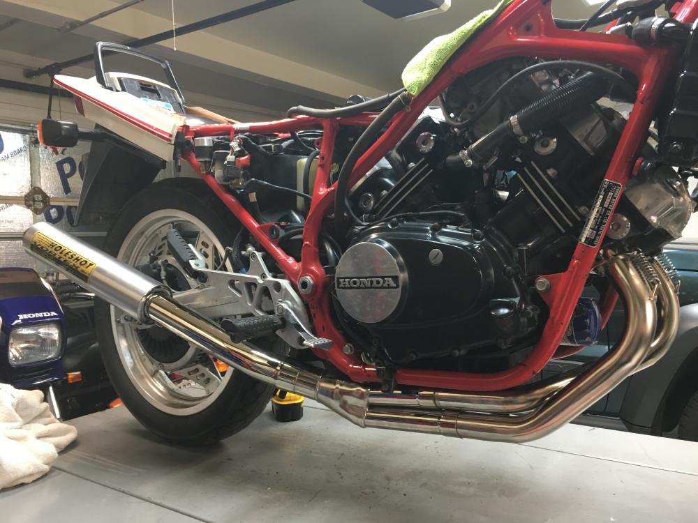

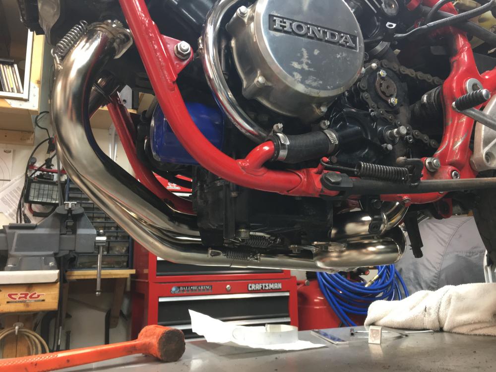

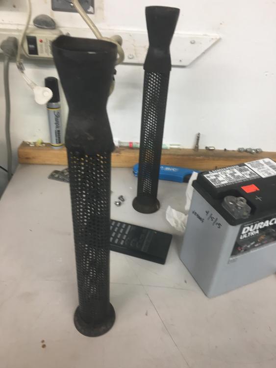

I`m not in love with the sound of the Holeshot muffler. Might have to replace that with something that sounds good like I did with my big Interceptor.
I did some homework on the Hindle. The mid pipe is a very large diameter. Hindle used to offer a baffle that could be inserted here. Instead of reinventing the wheel I just did what they did to take a bit of the edge off the audio output. I had a poor condition set of Kerker K series headers for a VF750F laying around so I pulled a baffle from one of the mufflers, wrapped it first in stainless mesh then fiberglass wrap and inserted it into the mid pipe. It protrudes the perfect amount to meet up with the muffler. Now it sounds very good. Throaty but not arrest me officer loud.
Wow, incredible score o the pipe and shock! Looking good.

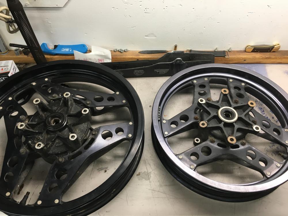

I talked to a local powdercoater I've used before regarding the bolt/rivet together wheels. It won't be a problem as his oven gets to 380*. Should bring them back to a pristine finish and he does very good work. I'd like to have a setup like yours Kel but I just don't have room.
Captain 80s, 6/2/2017 at 0:37 PM
Those wheels with normal discs is going to look great on that bike.  Nice progress.
I think so too. Should stop a bit better as well.

So it's been done! That's all I need to know, saw writing on rim "do not disassemble" and stopped the thought train there, but now.....action.
12 hours ago, VF1000RS
Now that's a little scary. Comstars by themselves shouldn't be Moving around. At least I don't think they should. What do you think was the cause?
Yep, I did a test fit on a set of CB1000F forks with swing away axle clamps. I would like to use that set up on a VF1000R build I've been thinking of for years; 17" Comstars with the rear widened to 5.5". Powdercoat the sliders fighting red.  Leave the clamps silver. Those 43mm tubes are nice and beefy and no TRAC.
Nice and subtle.
As far as the nuts and bolts, why not paint them silver? I'll be doing the rivets that way if/when I have them powdercoated. It doubles the price if I have them masked and coated separate from the black. And I can paint a few rivets convincingly.

I was going to hand paint the bolts a nice titanium-ish color, but thought I can always do it later.  Never have.

Any ideas on what rotors will play nicely with that set-up?  Maybe some adapters needed like on the NS forum?
I have a slightly bent front 1000R Comstar that might need to come apart for bolt research.  Like I need another project.

The CB1000's should be the correct diameter although they won't fit the Comstar as is. The calipers shown also hit the spokes. I haven't revisited this setup but plan to.

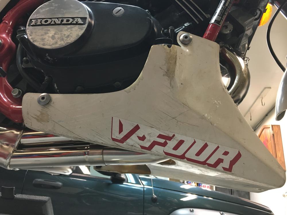

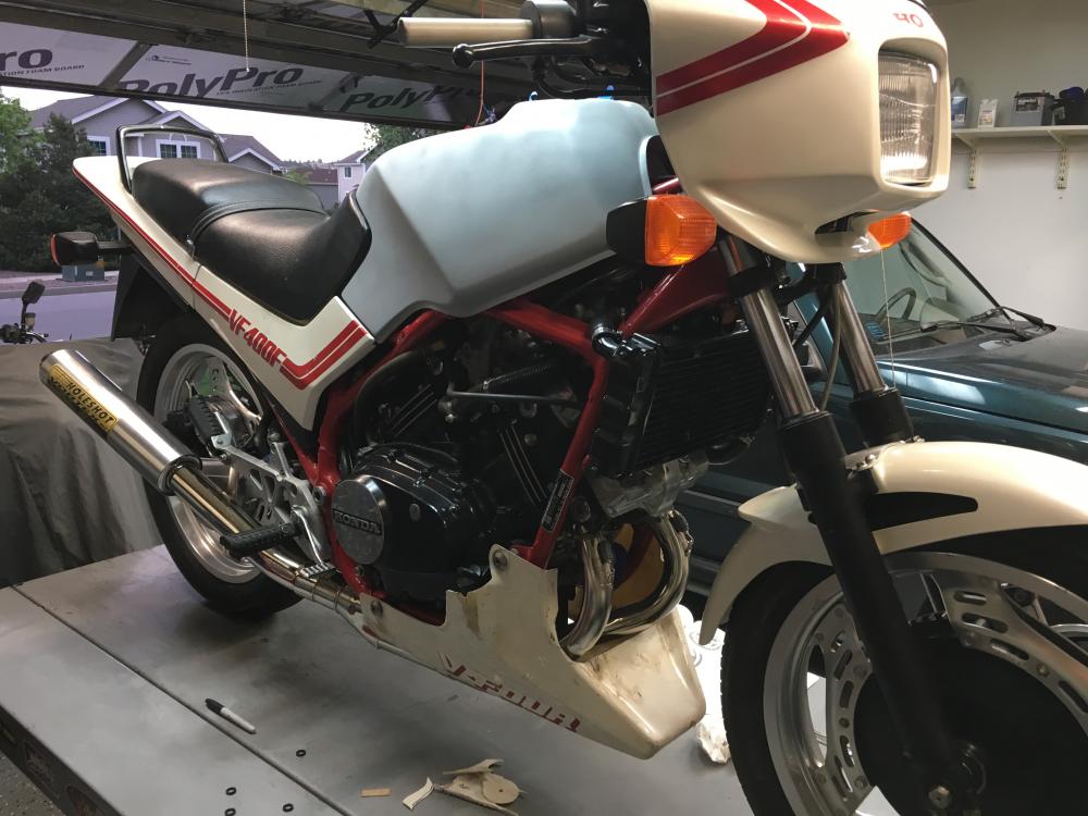

Not much new. The bike came with two lower cowls, both broken. Luckily the plastic is of the thermoplastic type so I was able to use a soldering iron to weld pieces together to make one cowl.
I took the opportunity to make it look a bit more molded to the Hindle exhaust by adding and shaping plastic.
