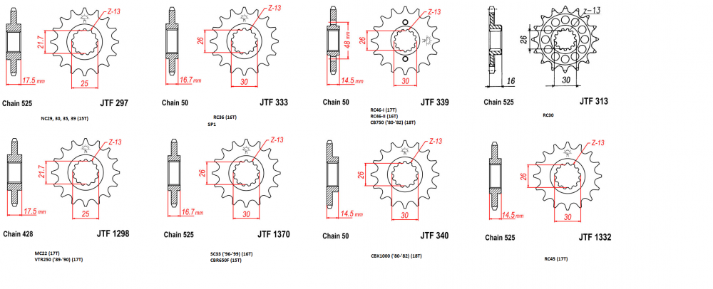

An Italian company called Ognibene also makes rubber-damped sprockets.  This shows the relevant JT sprockets (non-damped), but shows some of the common Honda countershaft sprocket sizes:
57a8ffc08fa9c_HondaFrontSprocketsCompared.thumb.png.2f6d92b7e712f89c4203168481dad8c0.png
Sweet info thanks man.
