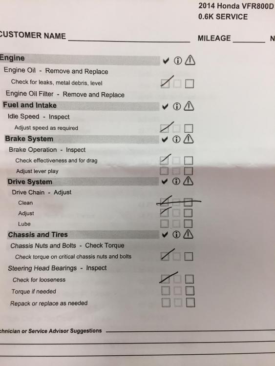

Here's a pic of what they gave me for the 600 mile service schedule checklist.  There was also a specification list attached to the receipt showing all the torque settings, etc, if anyone's interested in seeing it but I think it was just info from the owner's manual.

That labor was grueling I tells ya. :goofy:
