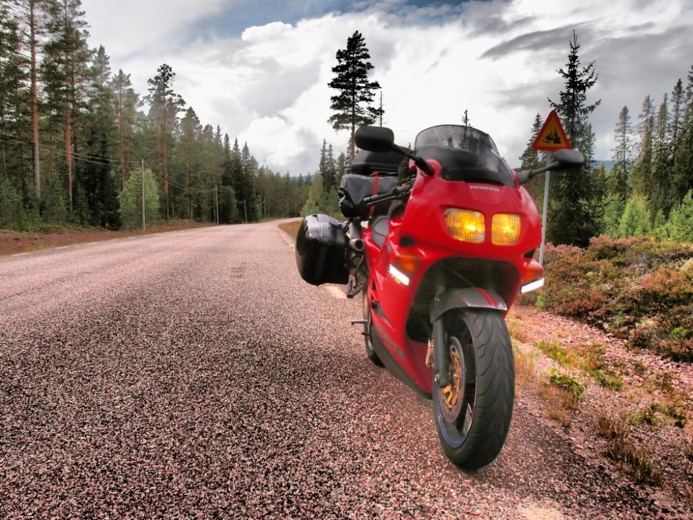

atx: hey nice!....my VFR is also red and I have been trying to change the tail/brake light to an LED that will flash for the brake for a short time and then go steady.  But I was trying to change-out the bulbs and was just not finding anything.  I did find red LEDs that replaced the bulbs, but were not as bright as the old bulbs...so did not use them.
I like your idea and think I will add something similar.....thanks.
