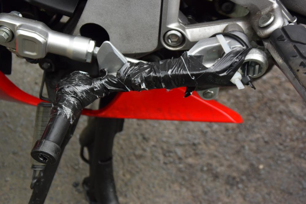

mmm, managed to drop the bike off its side stand, I thought it was in gear.  Not much damage as is went down slowly, however when I managed to pick it up again, (with the help of some bikers who stopped, thanks guys!) I noticed the gear lever had broken off, doh.
The quickshifter has a cast lug where the rubber fits on and looks like a weak point.
I am now in the Scottish borders, 400 miles from home and no gear lever - Luckily the Honda tool kit has an answer - see photos, a spanner (wrench to you guys over the pond) and a screwdriver saved the day.
It lasted another 1,000 miles until I got home a week later!
When I did get home, Honda do not sell the lever separately, so rather than spend a fortune on a complete set, managed to drill and tap a hole and screw a replacement in.
Now when I go away, i will take the original gear lever with me.....

Nice repair.  Did the same on my T595 a few years ago up in fort Augustus  managed to get to Oban some 60 plus miles away and drilled and tapped in a bolt.

Always carry zip ties and strong tape. :beer:
