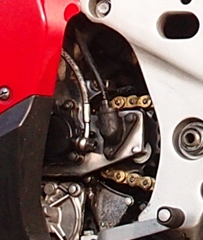

It depends on the bike's history, really. The quick answer is the black idle speed adjustment knob. On my 1990 (1990-1993) it is inside an opening in the left side fairing panel. I don't know where it is on the 1994-1997, but I would expect it to be the same. The bike's history would give you a better idea of why it is low. Has it been stored for a long time with gas in the carbs causing plugged or partially plugged pilot circuits? Were the carbs off the bike and maybe not adjusted or balanced properly after install? A low idle would not stop me from buying the bike. It can be adjusted or fixed.

Black knob just inside the fairing panel
