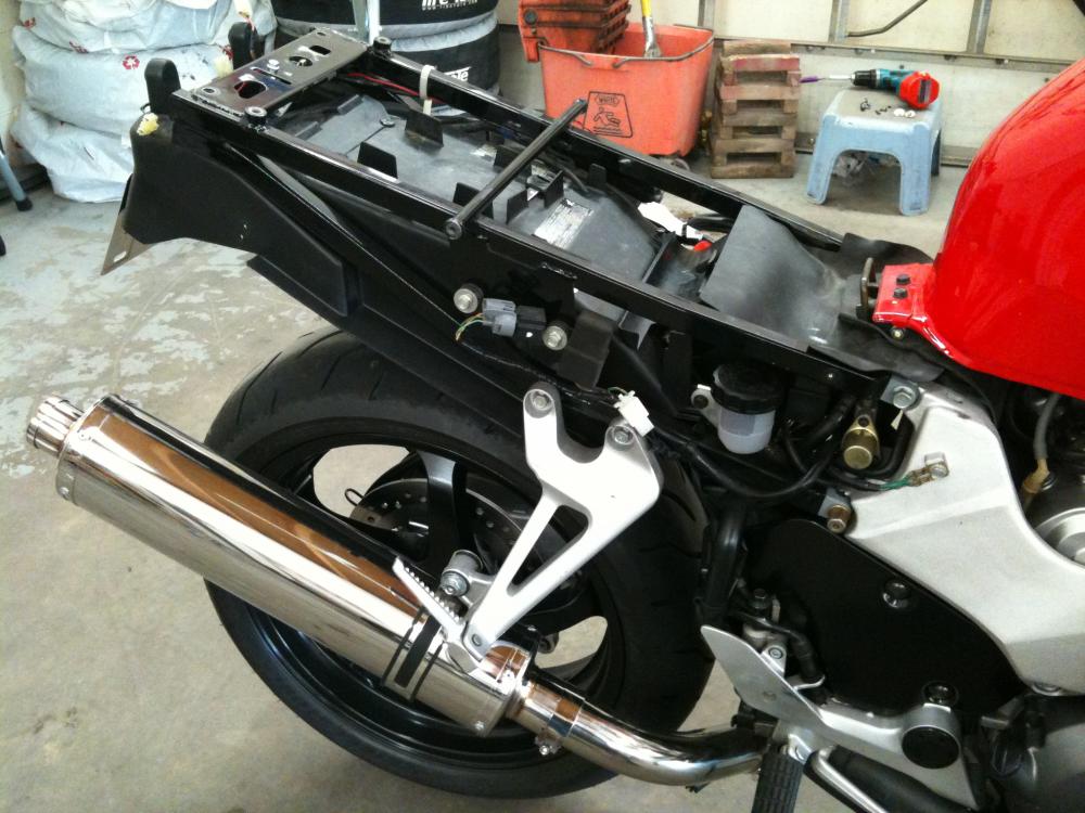

After clearing some space around the bike and putting the bike on the center stand, the first things to come off are the seat, passenger grab handles, and the rear cowl.

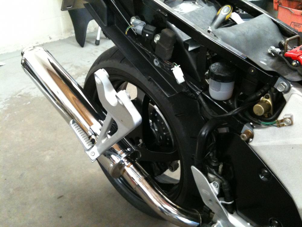

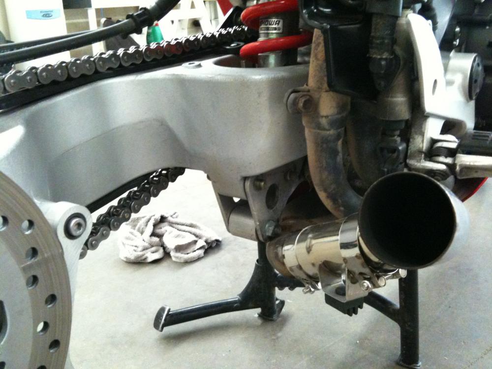

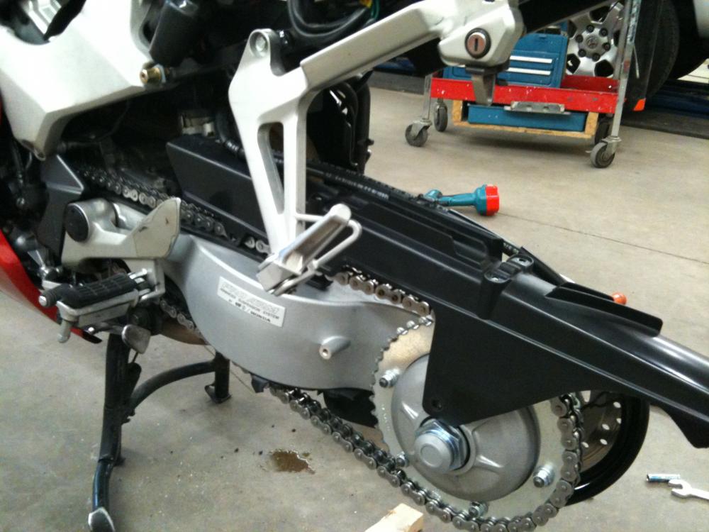

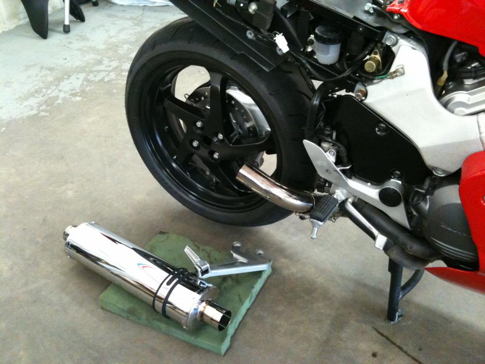

Next off is the muffler and the right side foot peg bracket.  I chose to remove the muffler and foot peg bracket at one time in order to make it easier to re-assemble later.  Loosen the muffler strap connector, undo the bolts on the foot peg bracket and twist the whole assembly out and back to remove.  You could probably do it the same way with the stock exhaust but it might be easier to do each separately if you have the stock exhaust.
Now it is time to remove the rear tire and the chain guard.  Don't forget the two plastic screw clips on the back side of the chain guard

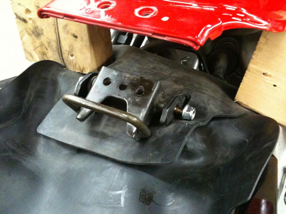

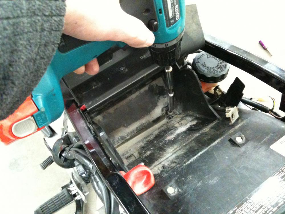

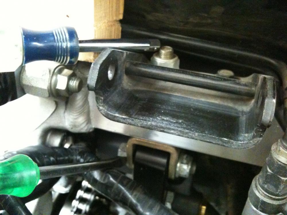

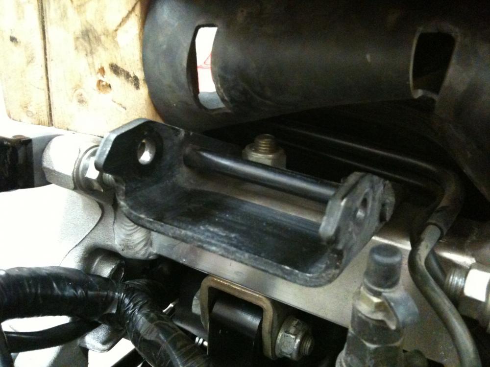

The top bolt for the rear shock assembly is under the two rubber flaps at the rear of the fuel tank.  I removed the two bolts at the front of the tank and the two bolts that secure the tank to the pivot clamp at the rear of the tank.  I then placed a couple of 2x4 pieces on edge under the rear of the tank to support it while I removed the pivot clamp.  This allows you to move the two rubber flaps.  The top one you can push forward and tuck it under the tank edge, and the big lower one that stretches over the battery box area can be removed and set aside.
You should now be able to see the nut that secures the top of the shock bracket to the frame spar, and the bolt that goes through the bracket and the top of the shock assembly.

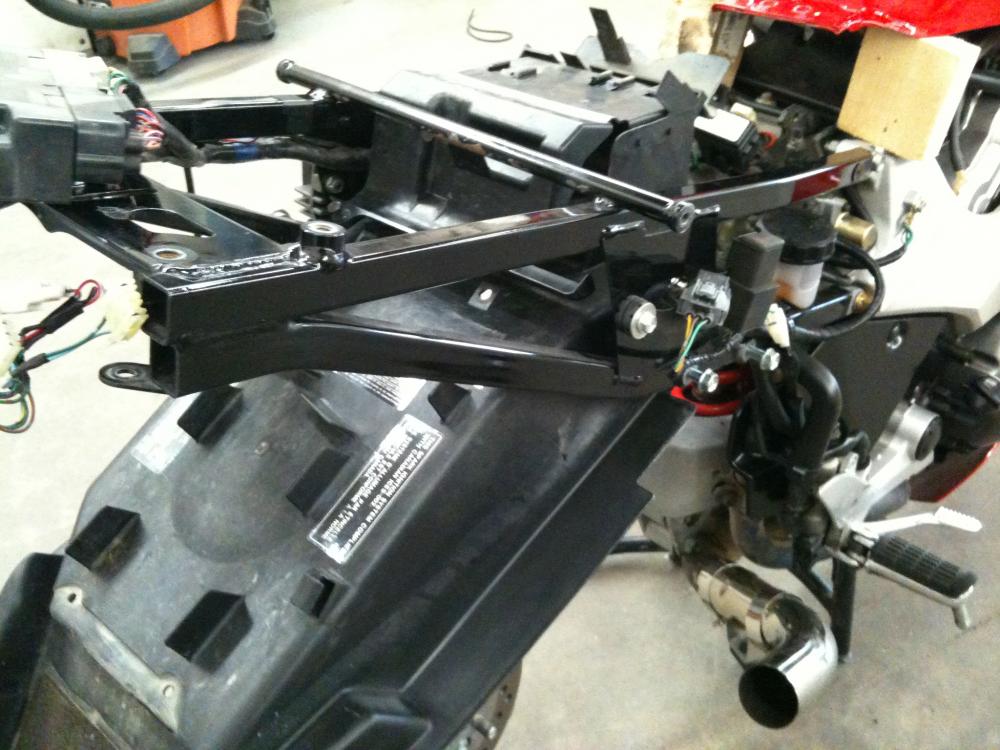

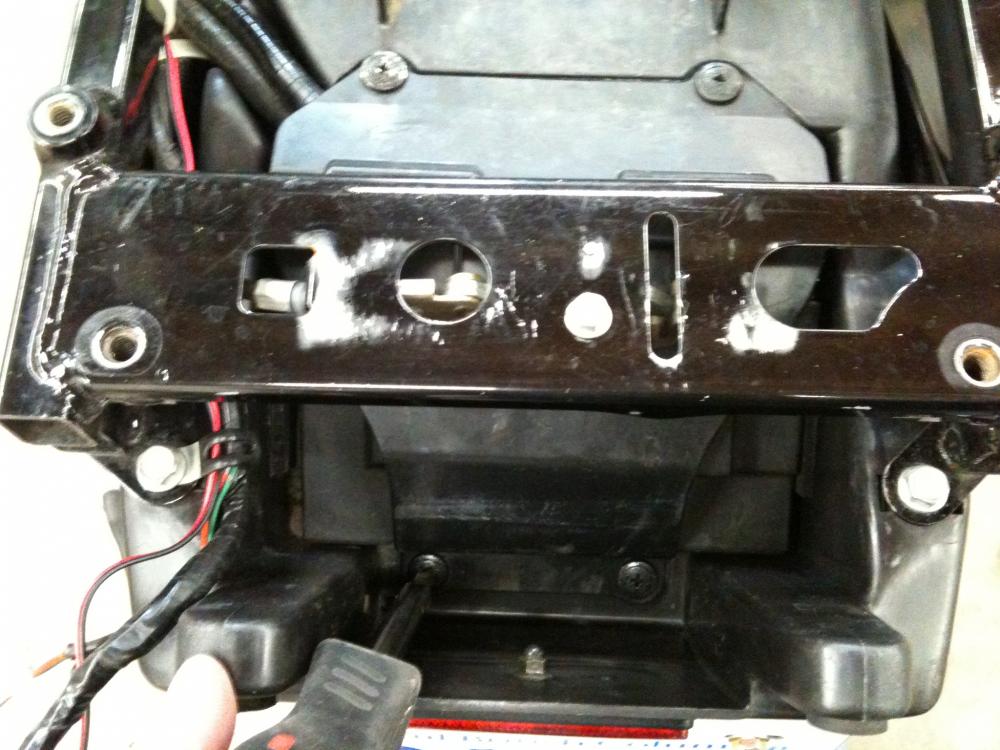

Since the CBR929 shock has a larger spring and a remote reservoir I thought that removing the fender tray would make the installation of the new shock a lot easier because it gives you  a LOT more room to work with and it also allows a better view of the whole swing arm area.  Removing the fender tray was certainly a bit of a pain to manoeuvre out of the frame but the ease with which the new rear shock went in certainly made it worth the extra effort.  It also gave me the chance to take a closer look at the wiring harness, connectors, fuse blocks, and other areas around the rear suspension that were hard to see before.

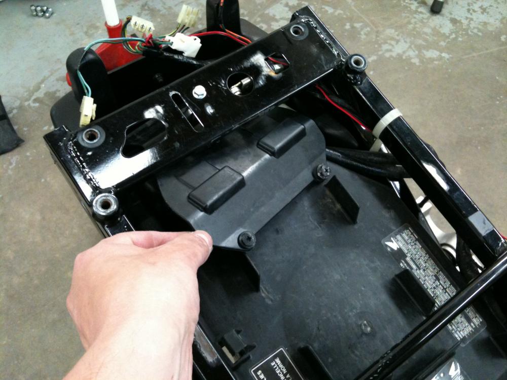

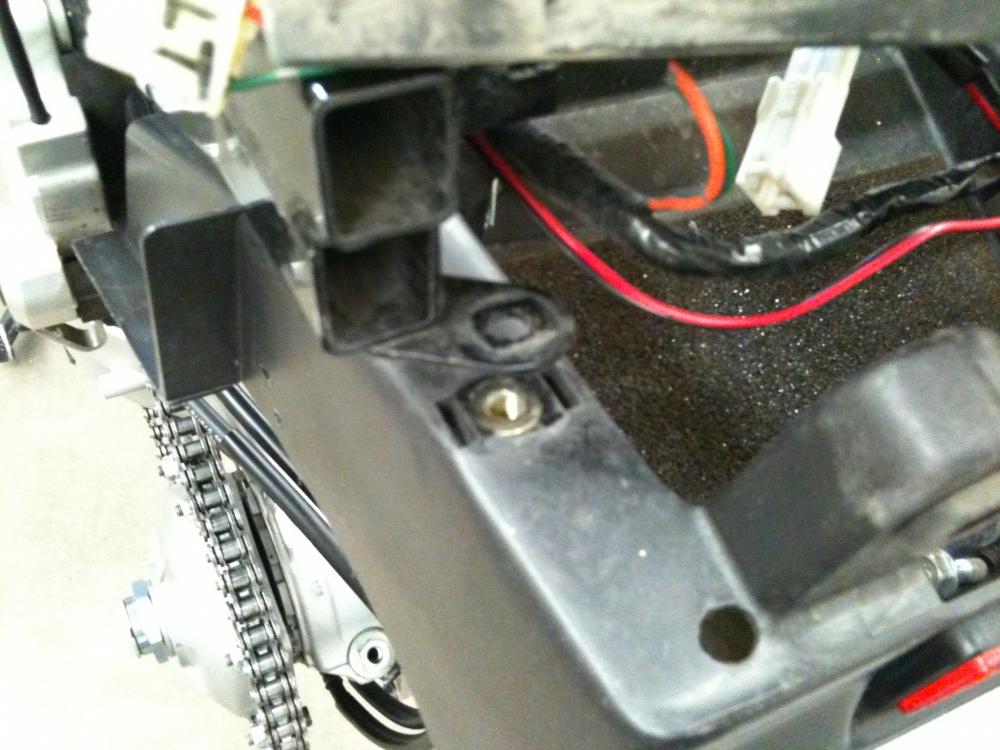

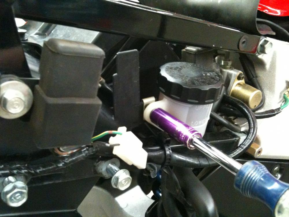

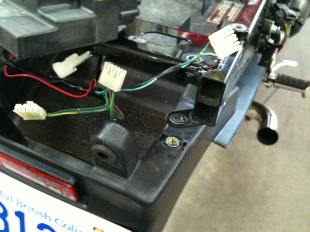

To remove the rear fender tray, disconnect and remove the battery.  Next, to remove the battery box cover lid there are a couple of fuse blocks attached to the lid.  They are easily removed by inserting a flat head screwdriver underneath and gently twisting to release the push clip underneath.  With the clip released, slide the fuse blocks up toward the top of the lid.  By gently squeezing the sides of the lid you can release the plastic pins that hold the lid in place and you can remove it.  Once the lid is removed you can also undo the 5mm allen head screw that secures the rear brake lines to the under side of the fender tray.

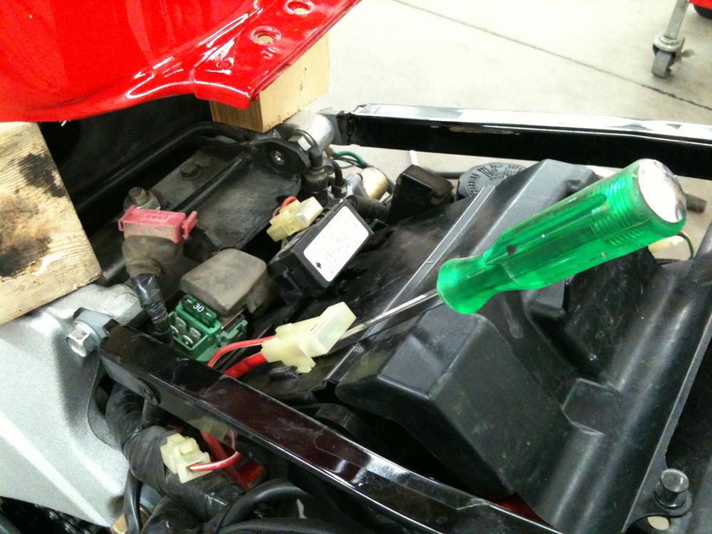

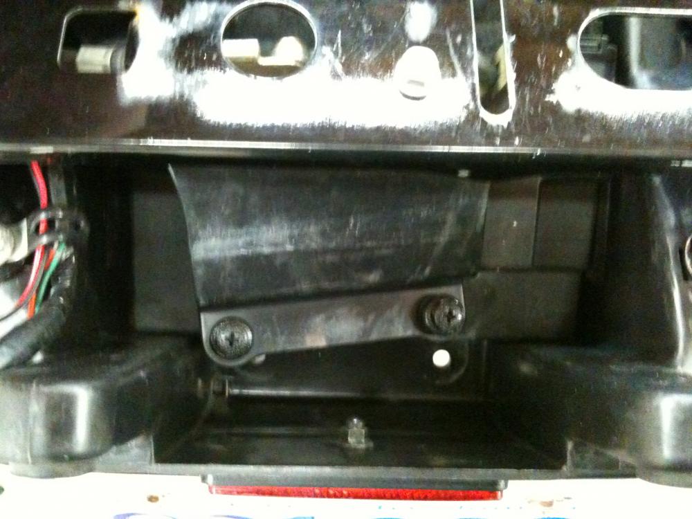

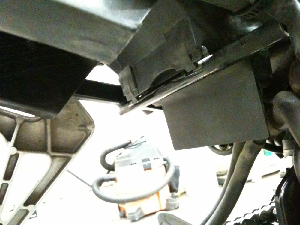

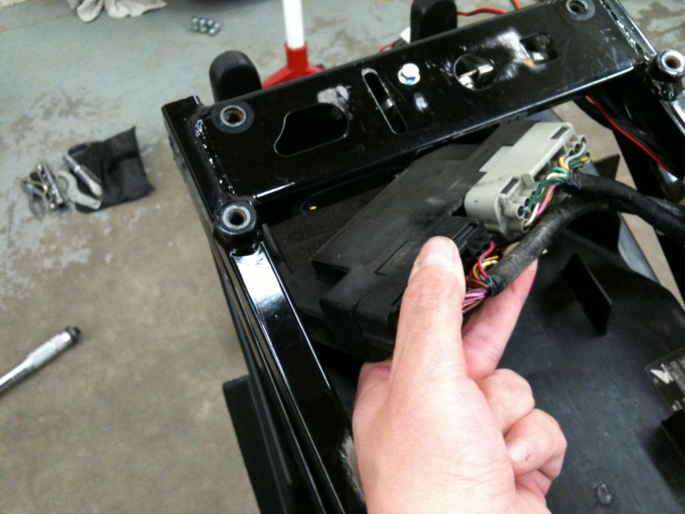

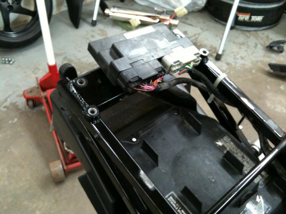

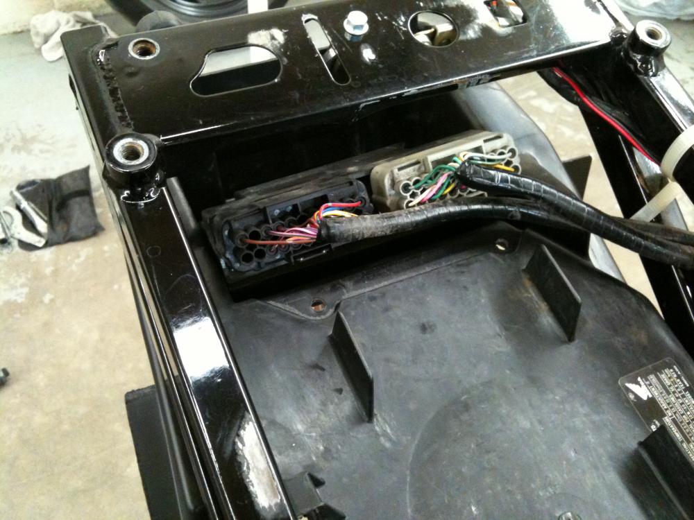

Moving to the rear of the fender tray, remove the lid covering the CDI box.  This should give you enough room to gently remove the CDI box and manoeuvre it out and then place it on top of the seat frame latch.  This is where I left the box until I was finished and it rested there quite securely. Remove the two bolts at the rear of the fender tray that attach it to the seat frame and allow it to drop down a bit.  The fender will probably move down about an inch or so but not much.  You will also need to remove the bolt that secures the rear brake fluid reservoir to the fender tray as well.  The reservoir will just sit there and not move, so not to worry.

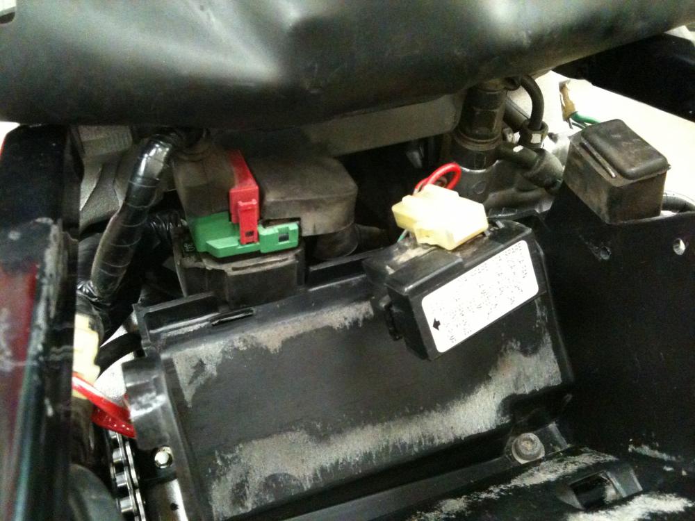

The front of the fender tray has a couple of tabs on it that the main fuse block (left side) and another fuse block on the right side slide on.  By pulling them up they should both come off.
Once all the bolts and screws are removed, gently push up on the front of the fender under the battery box to release the plastic clips that go around the round metal frame tube.

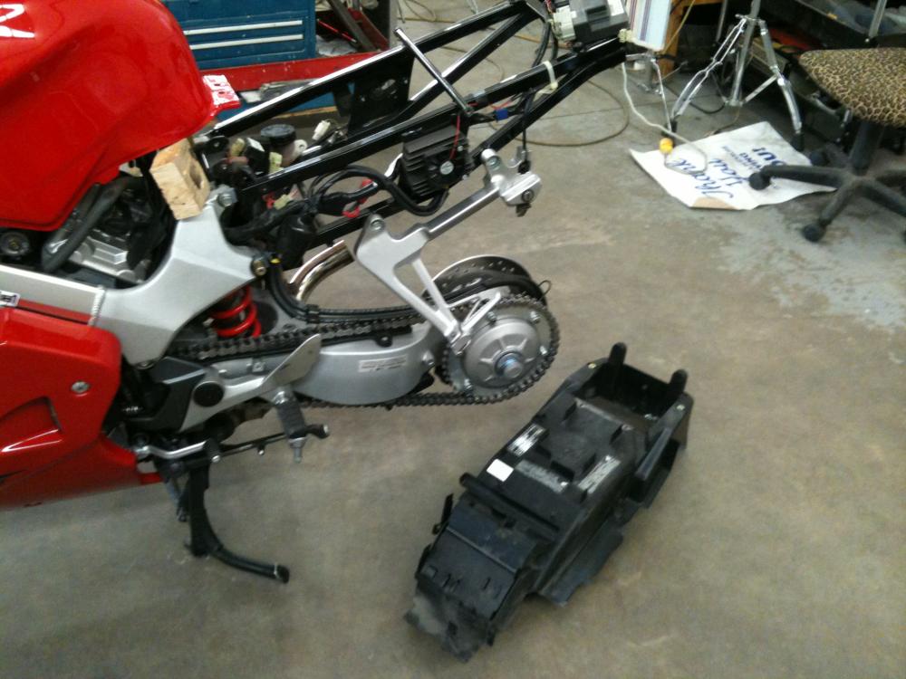

Now gently squeeze the middle of the fender tray at the bottom and lower it down out of the seat frame.  You will have to pivot the back down a bit while pushing the front up to clear the frame spar under the battery box.  Having an extra pair of hands to help you manoeuvre wires, connectors, and the fender tray out would be a definite asset.  Pay close attention to where and how the wiring harness and connectors are routed around the clips and on the front of the fender tray.  It helps to have a camera for this since a picture will help you get everything back together the right way later.  Getting the fender over the spar at the front of the battery will require a little bit of bending of tabs and some work to get the harness out but with a little perseverance (and possibly some colourful language) the fender tray will come out.   BE CAREFUL OF YOUR LANGUAGE DURING THIS STAGE AS IF YOU'RE LIKE ME, THE SWEAR JAR WAS ENSURING MY SON'S FUTURE EDUCATION WOULD BE FULLY FUNDED BY HIS NEXT BIRTHDAY.

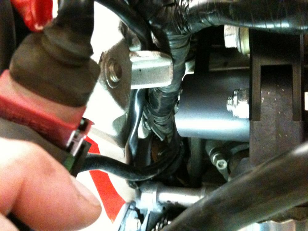

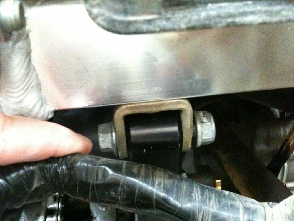

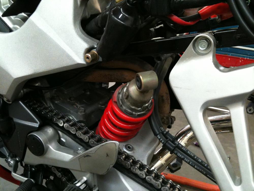

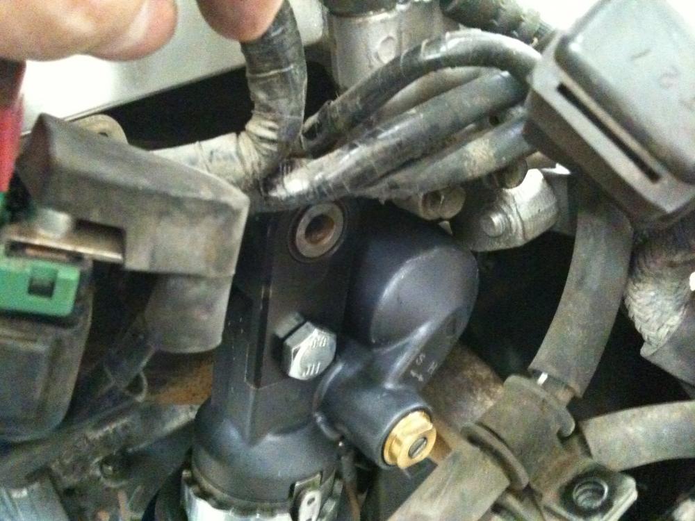

NOW to remove the old rear shock.  Remove the bolt that goes through the top of the shock assembly.  You may have to push down a bit on the wiring harness in order to pull the bolt out all the way since it is a pretty tight fit.
Time for the lower shock mount.  Remove the bolts from the lower shock arm plates.  Note the orientation of the plates when you remove them so that they go back on the same way.
With the shock assembly now completely loose, you should be able to pull the top of the shock back toward the rear of the bike, to the side, and out of the swingarm over the chain.

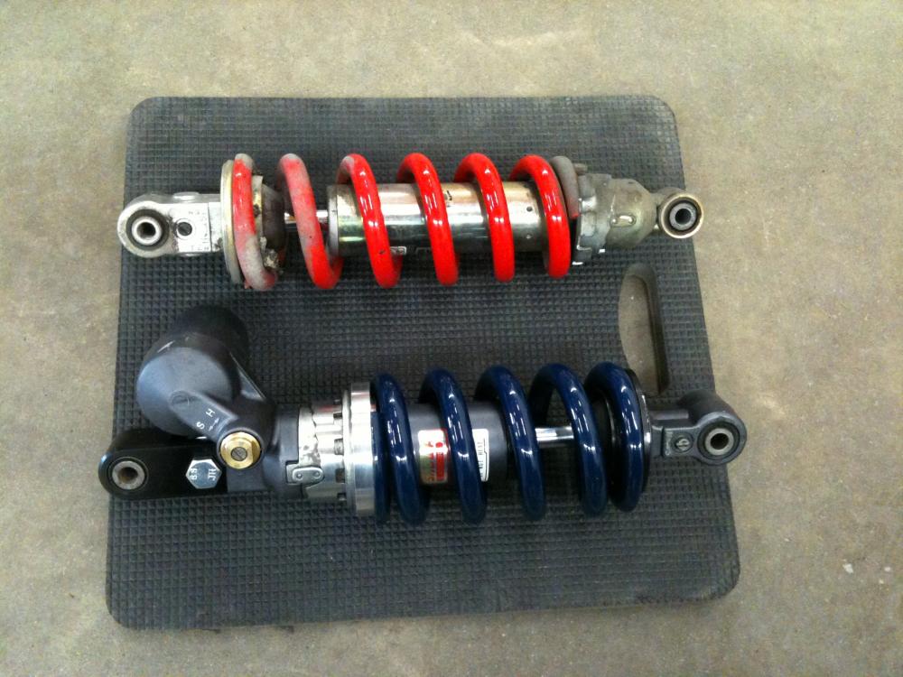

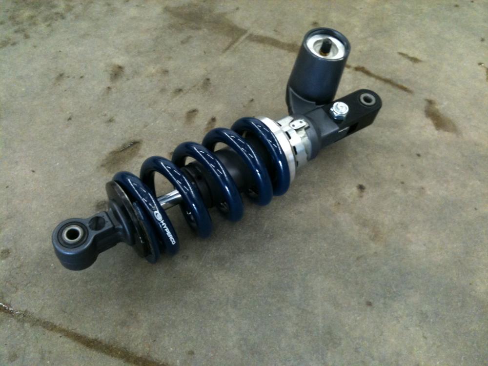

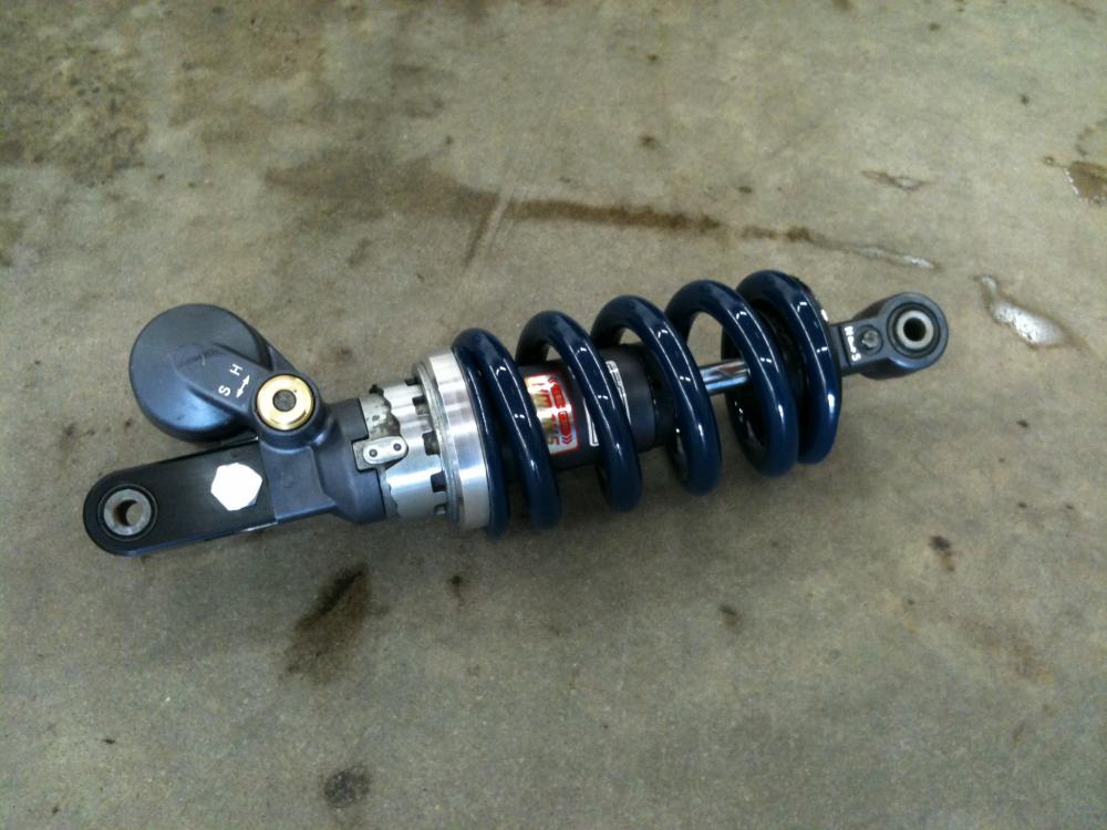

You can see the difference in the size and shape of the old shock (red) and the CBR929 (blue) upgrade shock from Jamie Daugherty.

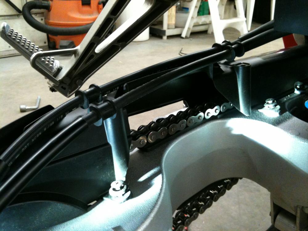

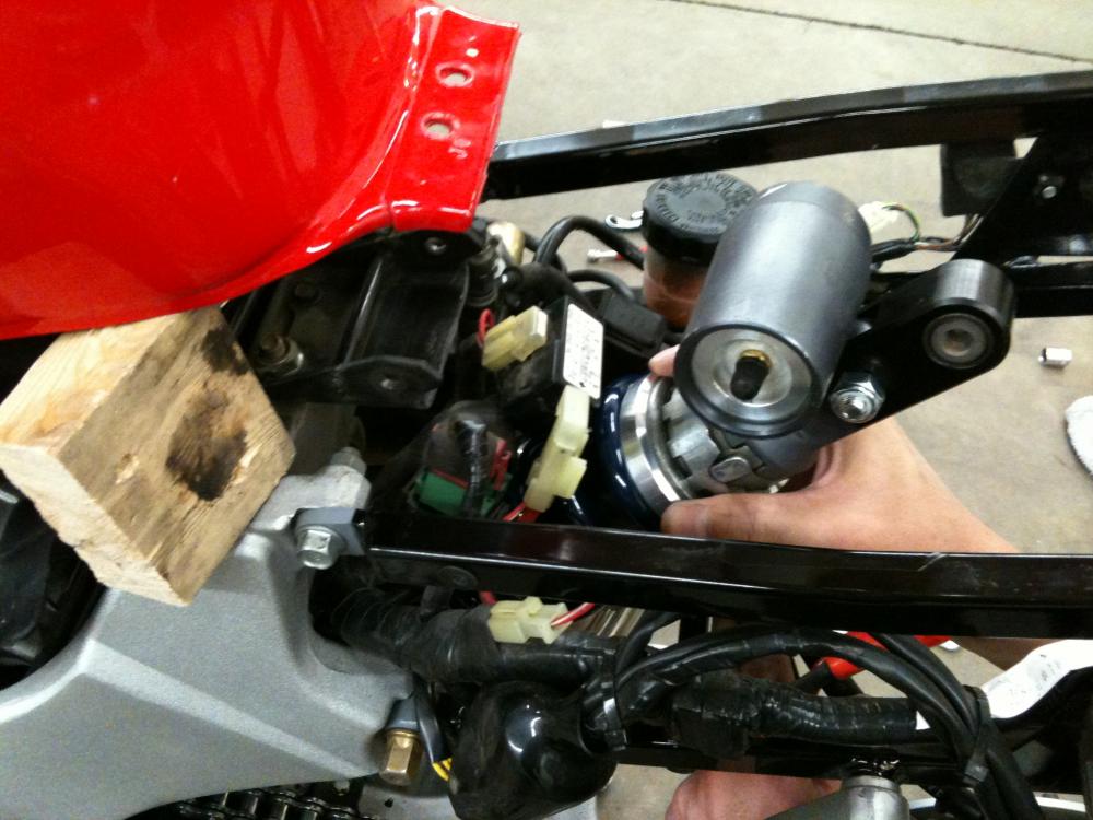

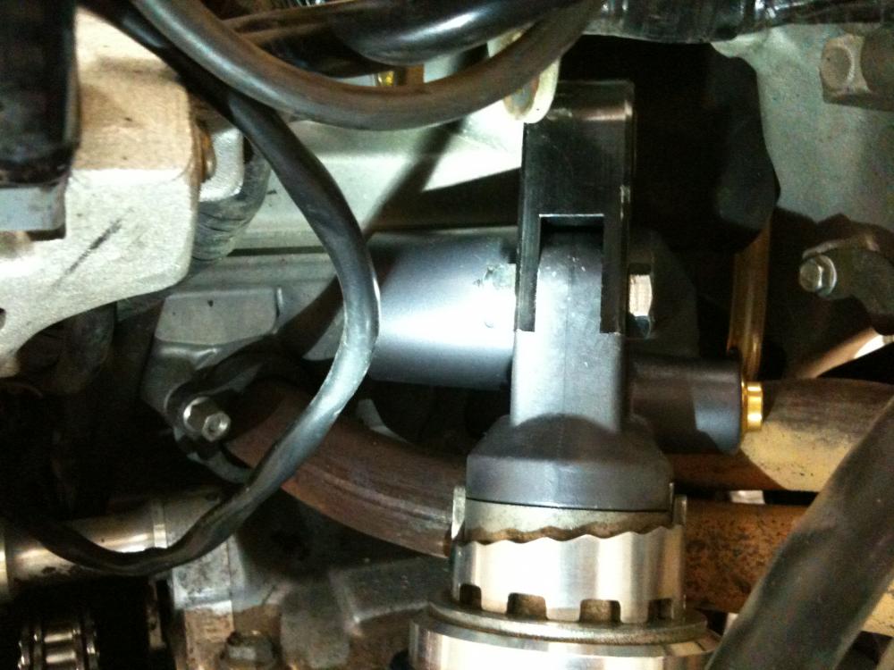

This is where removing the fender tray becomes perfectly clear.  Drop the CBR929 shock down in to the hole in the swing arm.   Rotate the shock assembly clockwise about 90 degrees and push the top of the shock forward, behind and in front of the upper shock mounting bracket.  The shock should now be sitting with the reservoir on the front side of the shock toward the front of the bike.  Now pull the shock back and in to the upper shock mount bracket and re-insert the bolt through the bracket and the upper shock mounting hole.
Another good reason to remove the fender tray is so that you can see if you have any clearance issues with the new shock assembly.  When I went to install the shock in the upper shock bracket I discovered that my wiring harness on the left side of the bike was being pinched by the edge of the reservoir on the new shock.  If I had not removed the fender tray I would not have been able to see how badly the harness was being pinched.  A friend of mine who works at a local auto body shop looked at the shock for me and suggested that I cut a notch in the lip of the reservoir so that it would not interfere with the wiring harness.  I also wrapped a couple extra layers around the harness where it passes the shock reservoir lip, just to be sure.
I was also careful to make sure that the edge of the lip where I cut the notch was filed smooth with no sharp edges.  Though this may not be a problem with every bike (my bike is a 2000 VFR by the way), but I thought that the clearance issue I discovered was worth mentioning, just in case someone else runs in to the same problem.  My friend at the body shop used to race motorcycles professionally and I wanted to check with him first before we notched the lip on the reservoir and he assured me that the notch would not affect the shock reservoir.

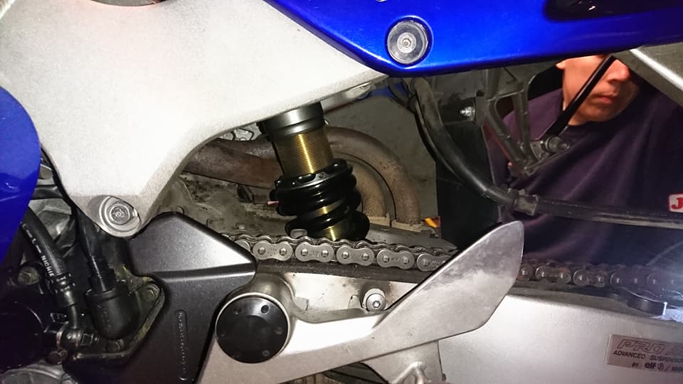

I followed everything except the disassembly of the fender tray since my new shock has pretty much the same dimensions as the original.
Glad the thread was helpful.  What kind of shock did you install??
zoomzoom
Went with The hyperpro 460.
