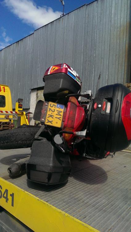

6th gen rack and GIVI fabbed on my 4th gen...
Sturdy as F....  :goofy:
As you can see by the angle of the rear wheel, the frame was not as sturdy...

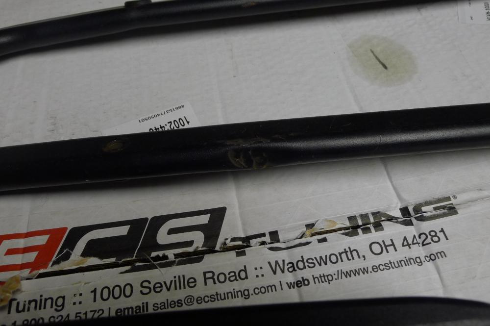

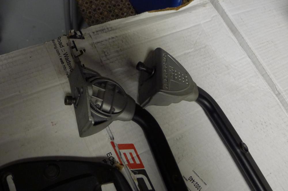

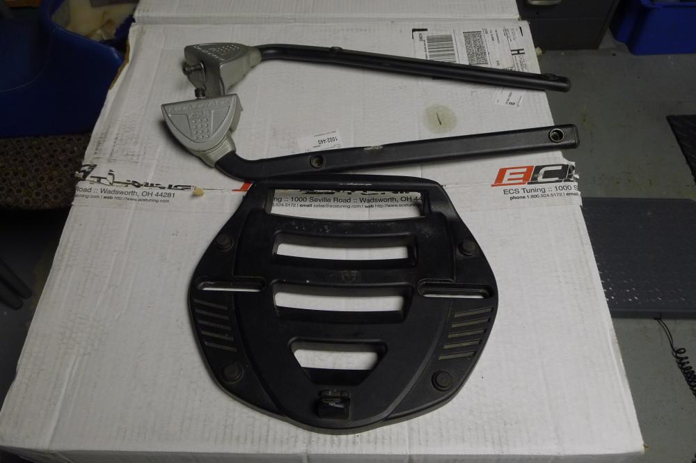

I have a set of arms and a MonoLock plate for sale if you want to fab your own.  $50 + ship.
