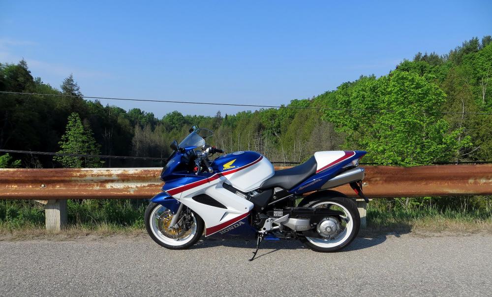

Manual states to inspect at 16,000 miles or 25,600kms
Change at 32,000 miles and 51,200kms.
My 2007 VFR RWB is at 24,000kms or 15,000 miles.
I plan on sticking to Honda recommended change out interval.
When have you guys changed out your plugs.
Bike runs mint.
Thxs and ride safe.
