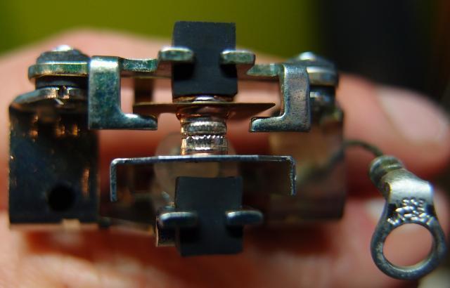

Do inspect the "contact points" inside/top of the fuel pump. A replacement kit is available when these are eol/starting to "weld" together.

New set:
[image: apoint2.jpg]
I filed the old contact point somewhat, but you can see the effects of sparking
[image: after1.jpg]
By design, there will always be a spark. This can be diminished by adding a diode in the path.
These pictures were lost when Photobucket ransomed the stored pictuers..... but if you google you will find similar how-to's
Dutchy - thank you; great pictures. I assume this is part of the pressure switch. I have never taken this fuel pump apart and my mind does not quite grasp how pressure is "transferred" to this switch... I guess it make sense once I take it apart.

It is part of the pump assembly (on top; in the drawing above to the right).
AFAIK, the way it works is that as the plunger rises if will eventually push the contacts towards each other. This causes a "short"(hence a spark) which will cause the plunger to fall back. And repeat.
I once posted a small video of this in action but it is lost forever...
