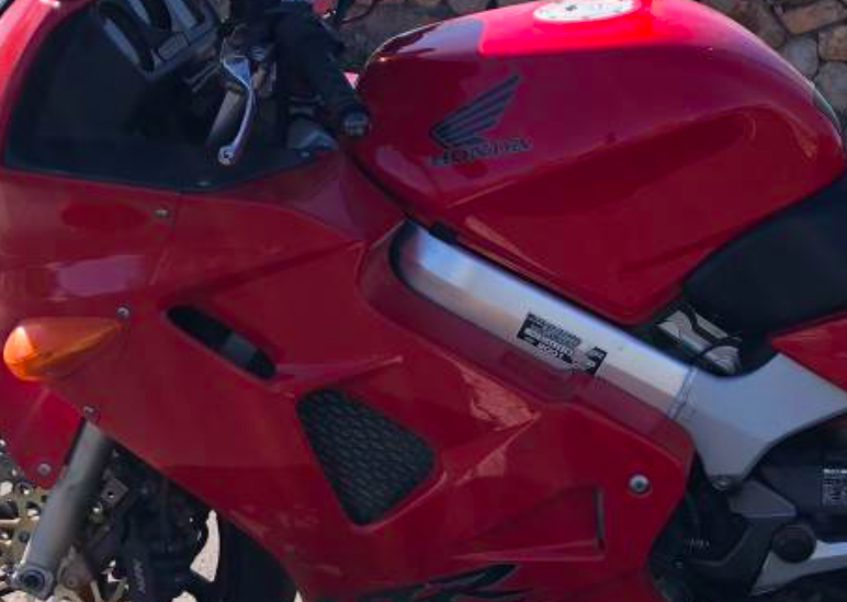

I noticed this odd thing in a picture of the local VFR I'm considering.
I haven't seen it in person yet, waiting to get the money together before i inspect and test ride. But this VIN sticker is bothering me.
At first, I thought maybe someone tried to peel it off and part of it tore, but then I noticed the location looks off.
Every other picture I can find of this sticker shows it positioned a little below this one. Makes me wonder.
Is there a VIN tag anywhere else on the frame, like near the headstock tube ?

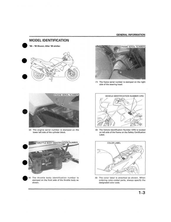

No VIN tag, but the s/n is stamped onto the headstock and on rear of the engine just ahead of the shock.
The 1998-2001 service manual shows this Page 1-3, and much more useful information as well. Peruse the Downloads section of this very forum and you will find a pdf version freely available. In the meantime:

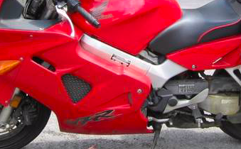

It does seem a bit high.  My US-spec bike has it lower, too.

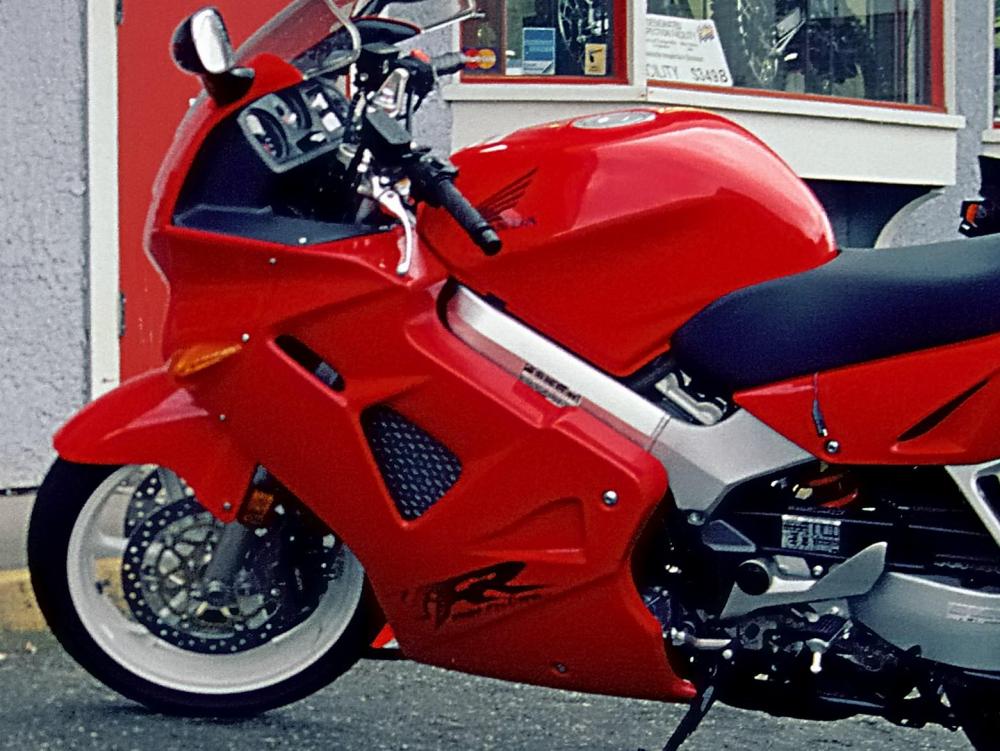

Fwiw, here's how the VIN tag was positioned on my '98 VFR800 (Canadian model) when brand new.
What's important is whether the frame & engine number match, and match the number on the tag.

My concern is the frame was swapped at some point and the sticker reapplied from the original.
Lorne, your photo lines up with all the others I've seen on the internet. The top of that sticker is always lined up with the "crease" in the frame. The one in the picture I posted looks fishy.
I would walk away from this specimen..

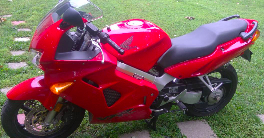

After searching craigslist for an hour, I managed to find another 2001 in a different state (VA) that has the sticker in the "high position".
I wonder if it's a production variance ? I haven't seen this with any other year. And I've found other 2001's that look just like Lorne's '98. Very strange.
