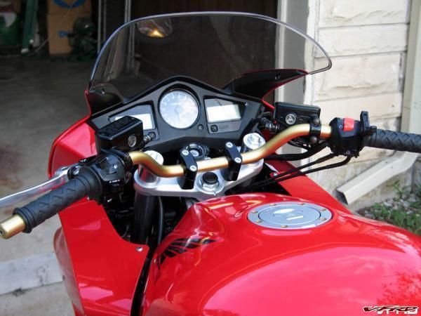

Installation?! :goofy: Uh, no. That just a picture I shamelessly linked over from the convertibar site. But, you're welcome nonetheless. :beer:
As fate would have it, the Ebay convertibars for the Yam R1 and the clamps I ordered from convertibar to fit the VFR arrived at the same time. The install took a couple of hours. The end result gives me about 1 1/4" more rise and about 1 1/2" back from stock. There is also less downward angle on the bars. This is about the limits without getting longer hoses and throttle cables...there is plenty of wiring from the switchgear.
The hose end locating lugs on the clutch and brake master cylinders were removed to allow positioning of the hoses.
The hose for the clutch was rerouted which required disconnection from the master cylinder. The brake master cylinder was fished around the throttle cables and switch wiring, but did not require hose disconnection. I ground both of the locating pins off the switch cases rather than mess with drilling the bars.
As soon as the hairspray dries I'll give it a test ride.

I installed a set on McClouds VFR, good quality and fit. Biggest problem seem to be with lines and cables! Butch ordered it all, but the failed to send the longer lines and that made it a major PIA and w/o longer lines and cables you can't take advantage of full movement possible.
High position
Reduced: 80% of original size [ 640 x 480 ] - Click to view full image
I hope you didn't install them as shown in the picture because the bars are on the wrong way. :D
Data point: They (Convertibars) don't fit a '90-'93 FL-FP.
No wonder the lines and cables wouldn't work! :rolleyes:
