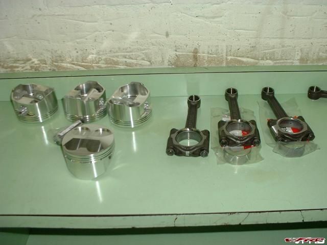

837cc pistons for the VFR750F:

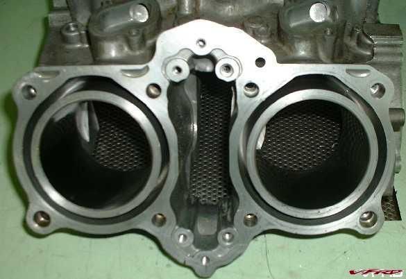

Cilinders honed:

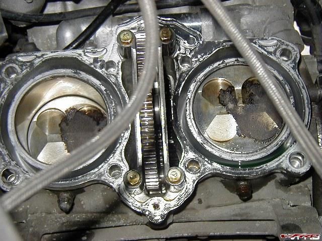

Interesting carbon pattern. Can't remember hom many miles this was--had to pull the front head to get it fixed (by TTS) after it had been cracked (by TTS).
