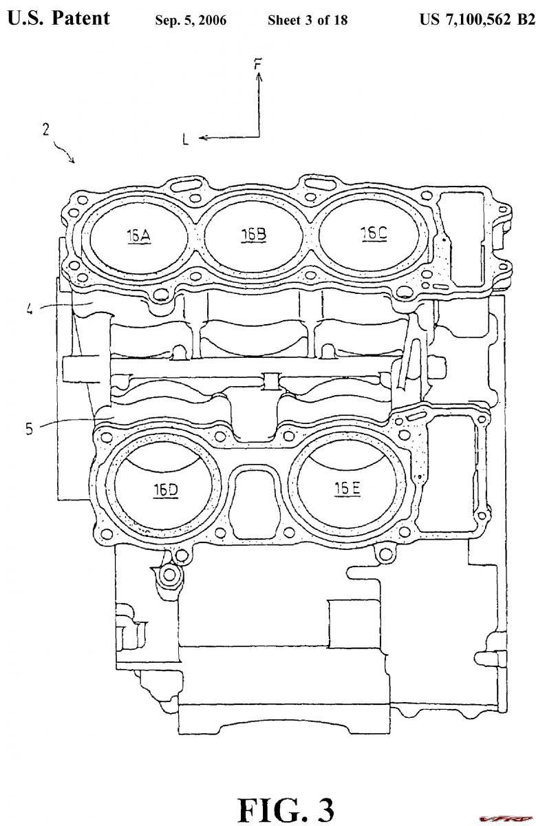

i ran across this. not sure if its for the RC211V or a road going version. it was issued on Sept 5 2006 and Jan 2 2007
i really dont see this engine making it in the next VFR but maybe a blackbird or motogp replica.
click here and enter these numbers 7156060 and 7100562

Awww shucks!!! No gear driven cams!! :angry:
CCT city in those drawings...clackety clack!

These would be cool if only for the wow factor. Are there other 5 cyl bikes? Certainly nothing currently. It would be a unique marketing point for Honda, the only 5 cyl, and a V5 at that, available for the road.

Yeah, that's the first thing I notice too. No cam gears.
thats what makes me think this is a road going version and not a $70k motogp replica
hopefully the next blackbird or RC61
Hmmm, really would hate to see that motor without the gear driven cams. Why bother if you are not going to make it as trick as you can? Doesn`t have ridiculous VTEC though thank goodness.

Me again, thinking they are talking about the idler gear that the cam chains run on. Interesting that it is not in line with the crankshaft I think.
Just finished reading most of the first article, seems besides allowing the motor to be smaller, there is much emphasis on reducing cam chain clatter by partially covering the cam sprockets. Seems plenty trick although alot of trouble for a cam chain...
Forgot who makes this engine. But they have a chain going to the intake cam, and the exhaust cam is gear driven from the intake cam.
The problem with gear driven cams is that you can not mill the head or block if they become warpped. If you do, you change the distance between the drive and driven gears and nothing will fit.
